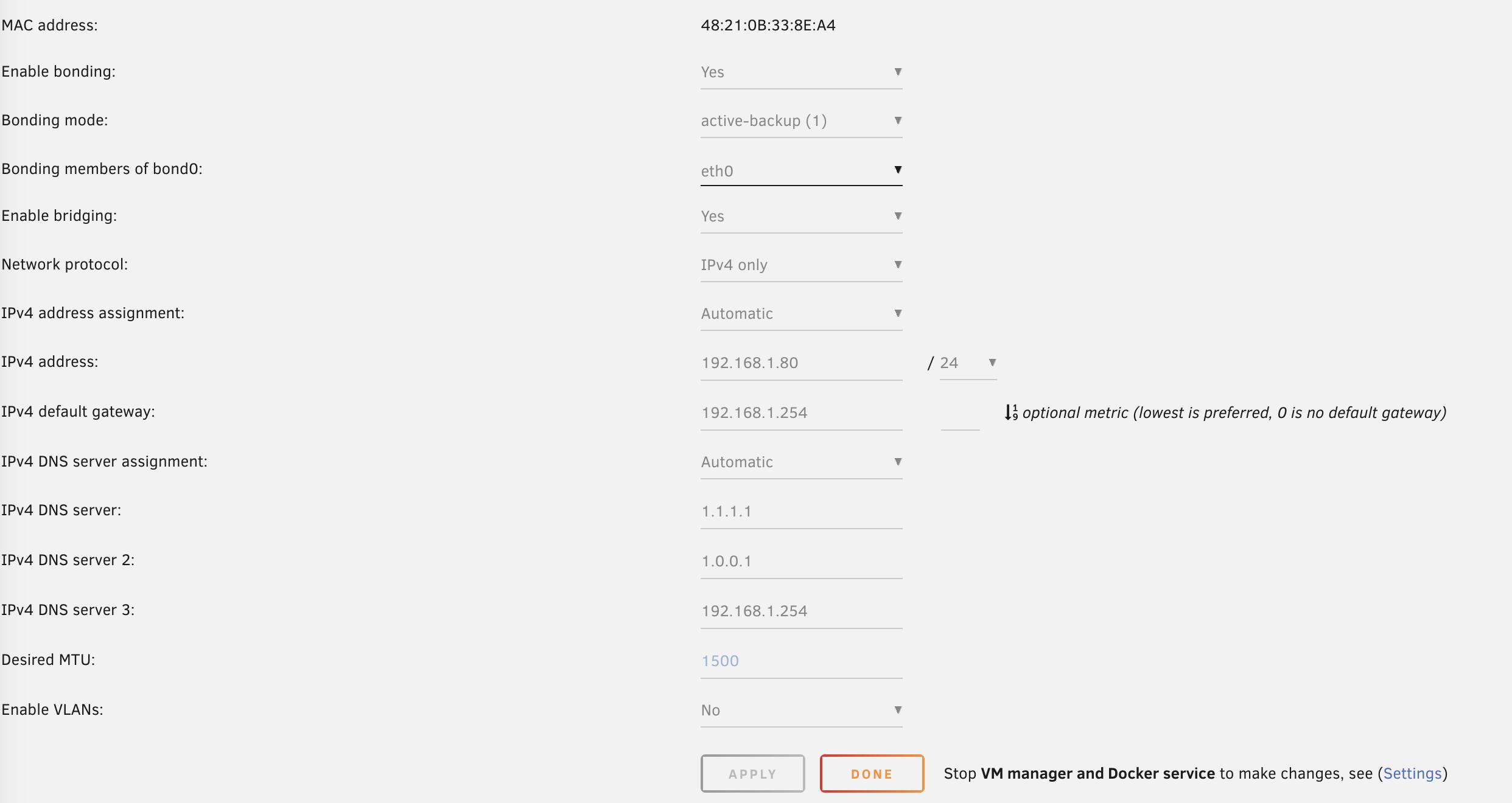

Hello! I've updated UD, removed bonding and bridging from my network config and manually set ip and gateway. And it still doesn't automount after a reboot Diagnotics joined. Thanks ! valisrv1-diagnostics-20230228-1918.zip

My Network is configured. Diagnostics are wrong.
