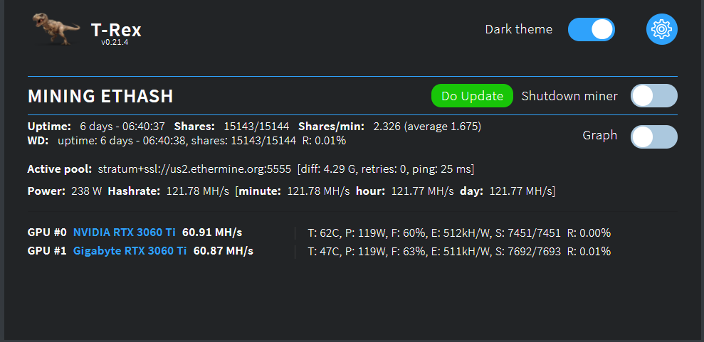

  2. Sorry for the late reply, I don't check this forum much. This docker container does not allow setting any OC. You have to use something that will invoke nvidia-smi / nvidia-settings and still work with the host. Currently the only thing that works is the nsfminerOC container (no longer supported btw) and the 460.73.01 driver on the host (also no longer supported, you'd have to somehow manually install this since the nvidia-driver plugin does not support this old version anymore). I was lucky to have had it installed already prior to updating the plugin so I'm still on it. To answer your questions now, if you get all this set up, yes you'd start it once per GPU with settings for each and then stop it. Once you get one container set up, you can just copy that container to a second one to use as a template, just change the GPU ID and settings for that GPU (you can get the GPU ID using the "nvidia-smi" command in Unraid terminal). No I do not automate it; it does not take much time to manually start the 2 nsfminerOC containers, stop them, and then start up this trex one, especially when my server is up for weeks/months at a time. I posted a screenshot of my 2x60tis mining in Unraid through this container for about a week, no issues as you can see. My 60ti FE is my main card inside the case hence the higher temps with a Aorus 60ti connected externally. My OC settings are -500 core, +2400 memory, 120W (50%) power limit, fans at 60%. YMMV.

  6. This may have been mentioned before, but I'll state it here: First set all your OCing parameters with the nsfminerOC container (1 per GPU), start it up, then stop it, and then use this trex container to mine with the previously applied settings. It invokes nvidia-smi to do the OC and fan control so it's applied even after you stop the container. The only caveat is you need the 460.73.01 Nvidia driver in Unraid or else nsf doesn't work, at least last I checked. Works like a charm for me though: I'm getting ~120 MH/s with 2x3060tis @ 120W each with the OC applied from nsfminerOC.
