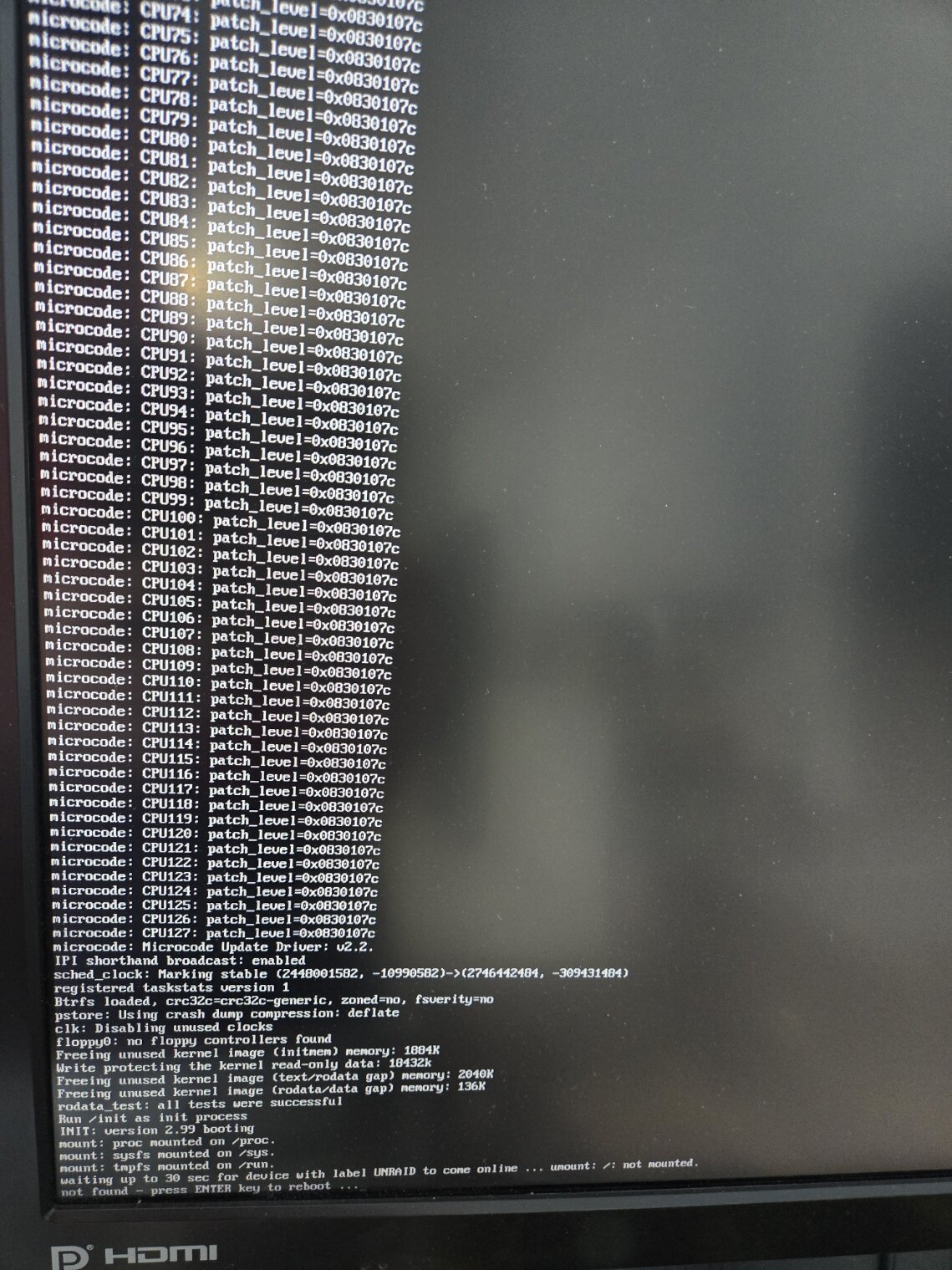

  3. I think something is off with USB for sure, keyboard works in BIOS & on the blue boot screen then stops after the selection is made. having cycled through all the USB ports / controllers .... I'm not sure what to try next.
  4. I've had my server with the same hardware working flawlesly for years, I recenly updated to 7.0 and it's been working great, through many reboots. I was in the middle of attempting to debug adding a second GPU, which unraid was not detecting for some reason ... where I am now completely stuck and cannot get unraid to boot at all. I get stuck at the "waiting up to 30 sec for device with label UNRAID to come online", I don't know how I got here, but I did reset the bios, update the bios, and juggle between UEFI and Legacy boot ... all to no avail. other things I tried from strands of mentions by others with similar problem: - unplugging everything, just keeping CPU, RAM, and unraid USB - using iGPU standalone - using iGPU while GPU is plugged in - using GPU while disabling iGPU (with physical switch) - xhci hand off disabled/enabled - fresh install of unraid on a fresh USB (both 7.0.0 and 6.12.15) - install unraid using the installer / manually - Legacy USB support enabled / disabled - changing the USB ports (3.0 & 2.0) - read every post on this forum and reddit related to this "waiting 30 sec" message IMPORTANT: one thing I noticed (which only started happening after many different messing with BIOS settings) is the keyboard gets DISABLED after the blue boot screen, and when I get to the "30 sec" message, where it prompts to hit Enter to reboot, the keyboard stopped working, where it WAS WORKING before at this step ... I think this is related to the issue of not detecting the device / mounting the partition... the whole thing doesn't make sense, things that were working, but now don't, even with a full reset of BIOS to default options, I can't even get back to a state where the keyboard was working! please help! Mother Board: Pro WS WRX80E-SAGE SE WIFI CPU: AMD Ryzen Threadripper PRO 3995WX USB: SanDisk 16GB Cruzer Fit
