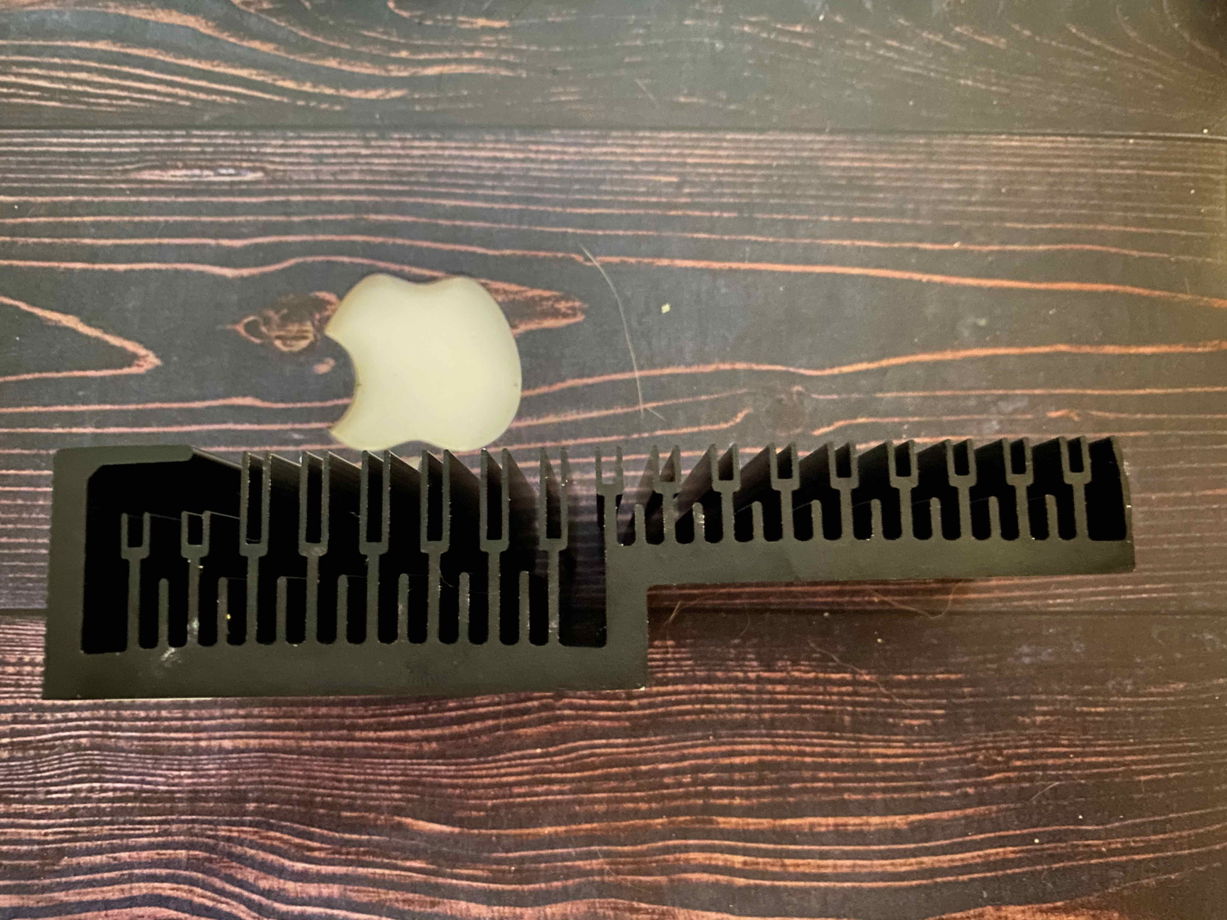

I got a 1030 instead but now I run into a different issue. It has a massive heatsink that won't be able to fit inside my R420 :). Looking to replace it with a much more slimmer version
