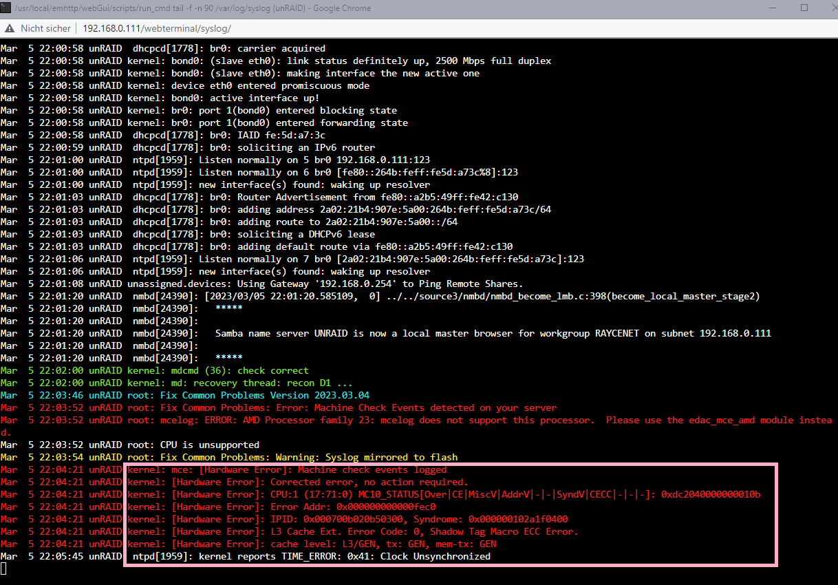

  5. As said since the System crashes it was rebooting anyway. But I have found the reason for the crashing: I had a third GPU connected via PCIe x1 riser. It seems that either that setup or the fact that so many PCIe lanes are occupied was giving the entire system instability. After removing the x1 riser the system is running stable again.

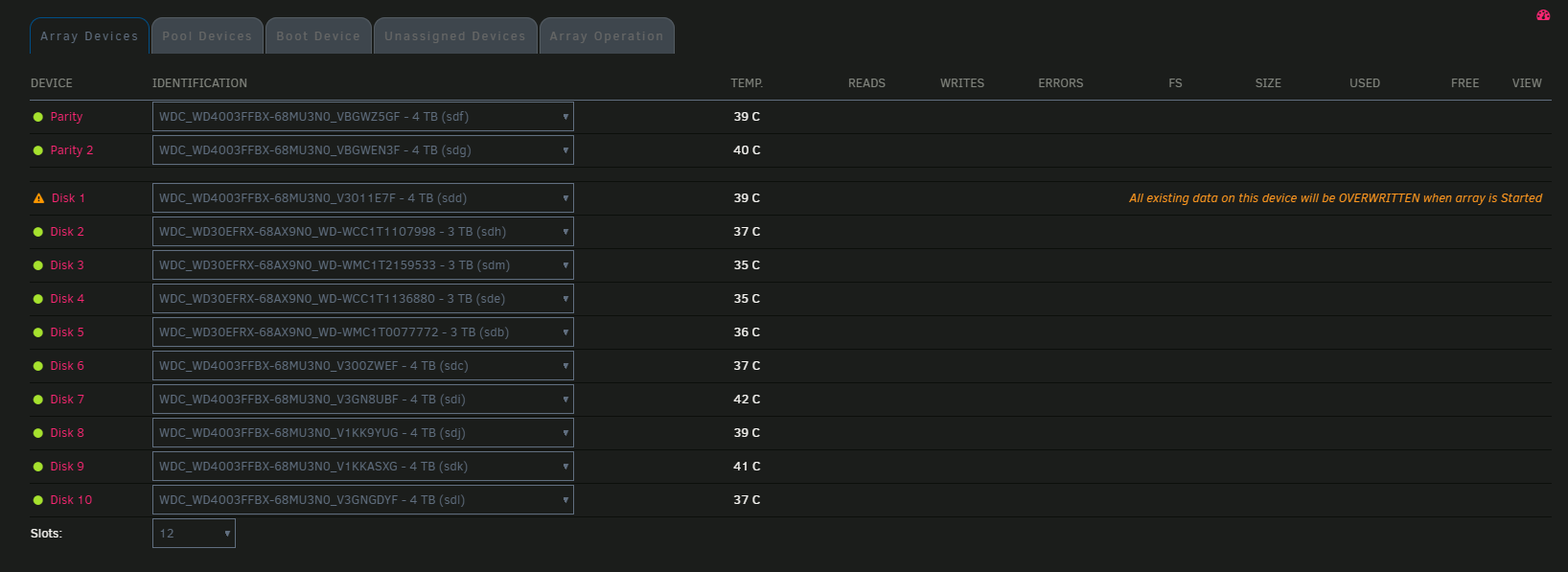

  6. Hello all My System has been running well for almost half a year now with 6x3TB and 6x4TB, with two of the 4TB running in parity. As I want to gradually upgrade the 3TB to 4TB too, I recently purchased 2x4TB. I powered down the system, swapped the first drive, powered back up, rebuilt with Doocker and VM on with no issues. After the first rebuild I powered back down, swapped the second drive, powered back up and began the second rebuild. This time the system crashed after being about 3 hours / 40% in. Trying to rebuild after the crash gave an immediate crash again. So I unmounted the second disk, deleted the partition, precleared the disk and began another rebuild, this time without docker or VM. Before hitting 2% the system crashed again. I am not able to do any rebuild, emulation or parity check without the system crashing not even 5 minutes after starting the array. After watching carefully I did notice a CPU error popping up once or twice before crashing, but this doesn't always occur: Shortly before I started "Fix Common Problems", but the log entries are unrelated. Attached are the diagnostics and the latest syslog before the crash. unraid-syslog-20230305-2104.zipunraid-diagnostics-20230305-2159.zip Can someone please help me how to get the system running again? Thanks. EDIT: Oh yeah, Syslog is also logged to flash. Here's a copy of it: syslog

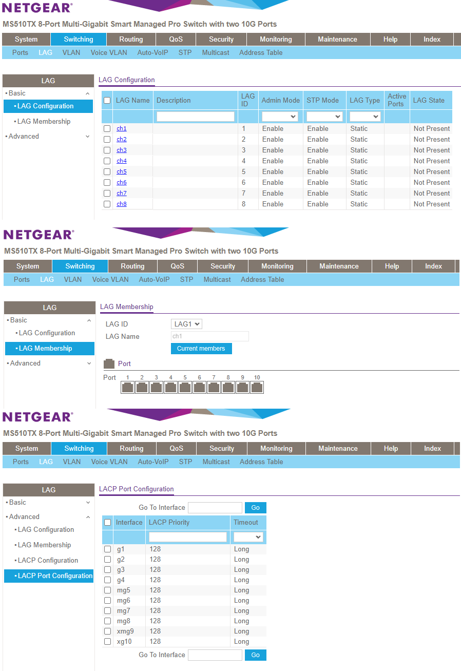

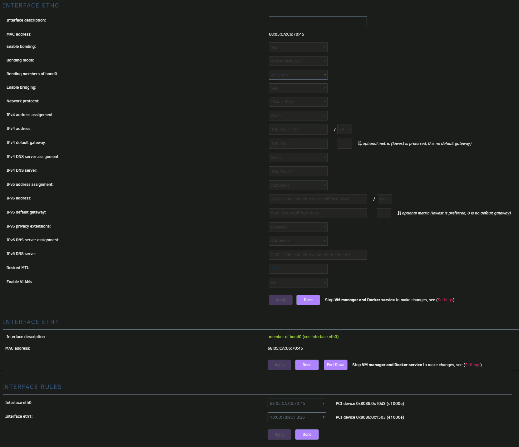

  8. Hello My server has two 1GBit NIC's which are running in active backup since I didn't have a configurable switch. Now I upgraded to a Netgear MS510TX but I am not able to setup everything correctly. My goal is to use the full bandwidth of both connections as a "bundle", but I have no experience doing so and I can't figure it out with the documentation. I initially tried setting up LAG on both ports on the switch, but I had to reset it as I lost connection to the server. It seems more has to be done or in a different order. Can someone please help me out, perhaps even via Teamviewer? Attached are screenshots of the server network config and the switch configuration for LAG (this seems to be the relevant part). Here is the switch manual: https://www.downloads.netgear.com/files/GDC/MS510TX/MS510TX_MS510TXPP_UM_EN.pdf Thanks in advance!

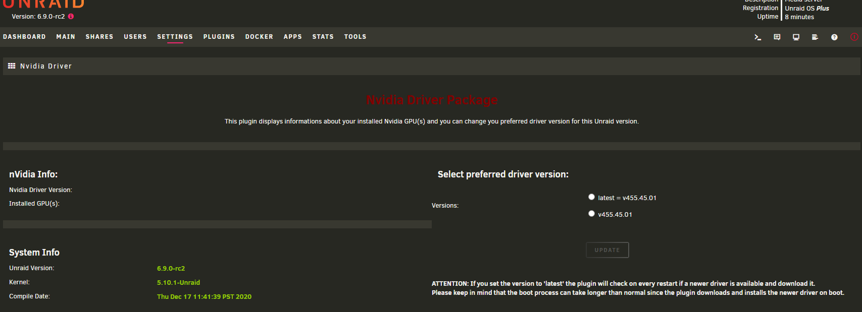

  11. I have un- and reinstalled actually, yes. What happened is that the local GUI now doesn't work anymore, but the GPU recognition is the same.

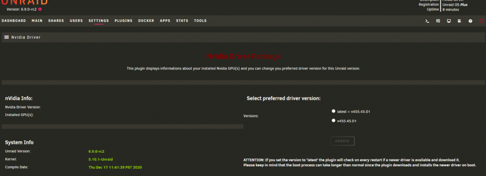

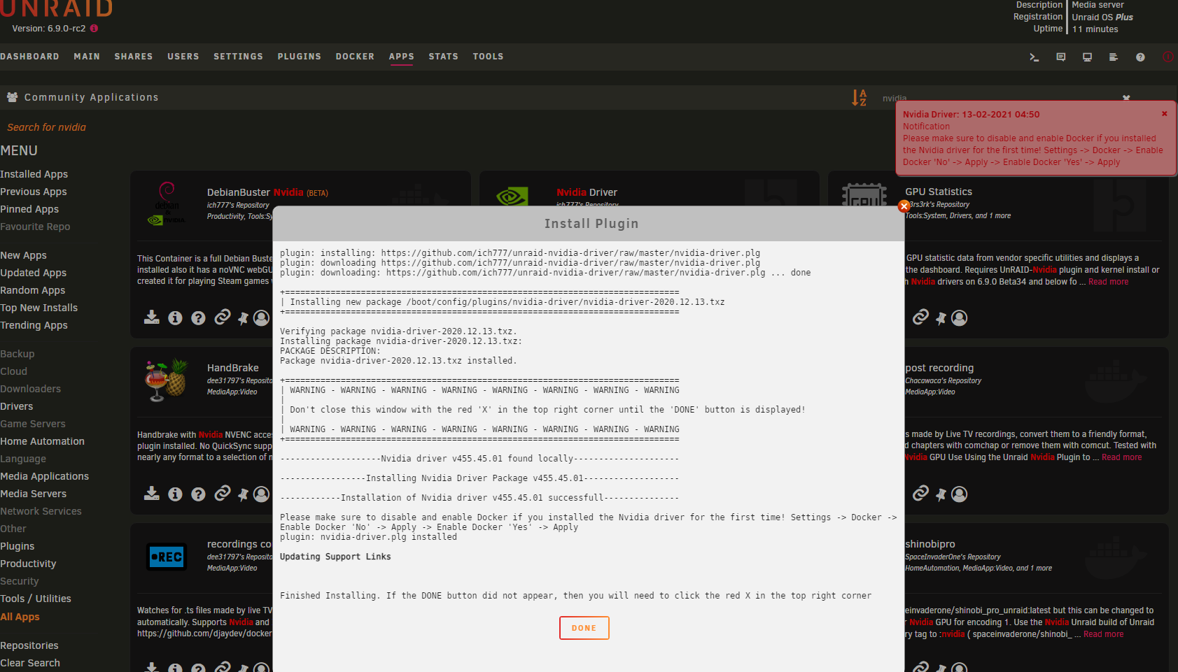

  12. I have rebooted multiple times already, yes. There has been no change. Maybe it has to do with the 5.10 kernel and the driver being for 5.9? Is there any way to manually update the driver to the current 460.39, since it is supposed to support kernel 5.10? https://www.nvidia.com/Download/driverResults.aspx/170134/en-us

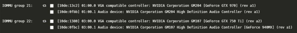

  13. Hello I have recently updated to 6.9.0-rc2 and have a GTX970 and a GTX750ti installed. Both were previously visible in 6.8.3 and linuxserver.io's plugin. Since upgrading to rc2 I am not able to see this plugin anymore so I switched. Unfortunately after installation it does not recognize my cards. Under system deviced they are still listed and also driver v455.45.01 is installed.
