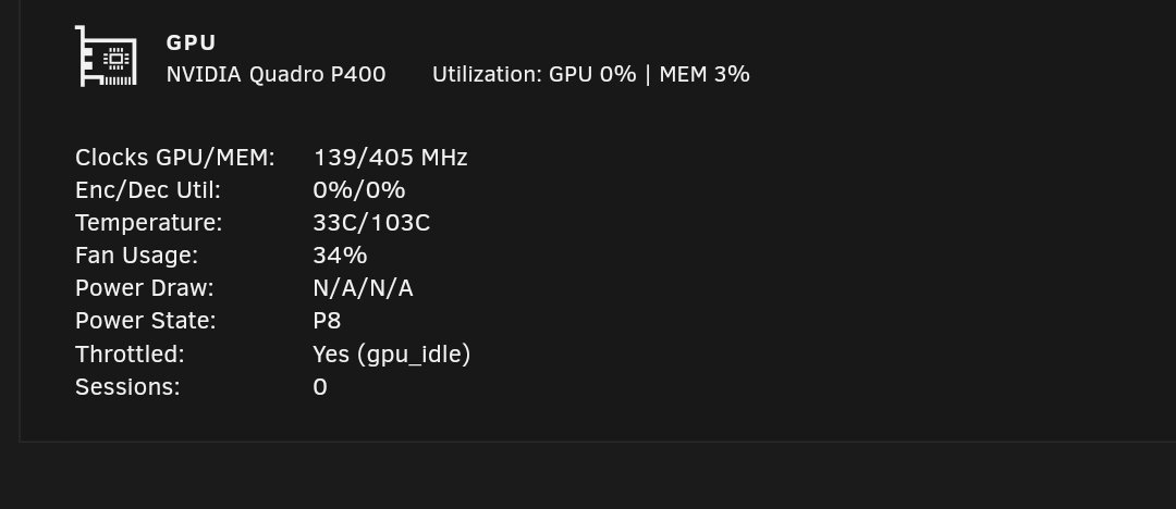

  5. It switches yes to p0. I've talked to someone else and they said they ran the Nvidia persistent command to idle 'properly'. I just wanted to make sure there isn't an issue or if I need to try and get it to not throttle on idle. I hear it's normal then that it's not.
  6. Everything works and I appreciate the hard work. I do have a couple questions. Is it normal for it to idle throttled? And also my clock speeds are extremely low. Thanks
