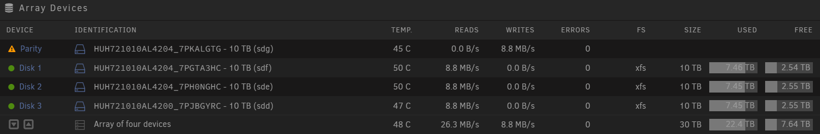

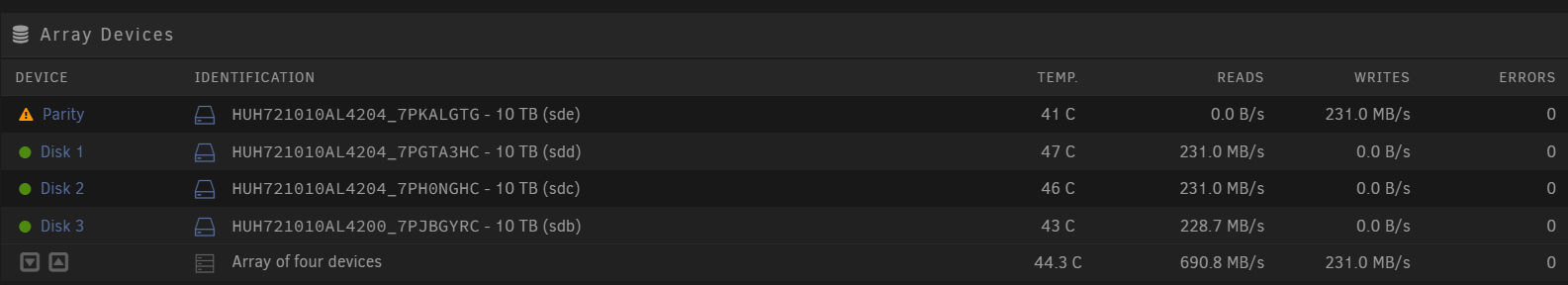

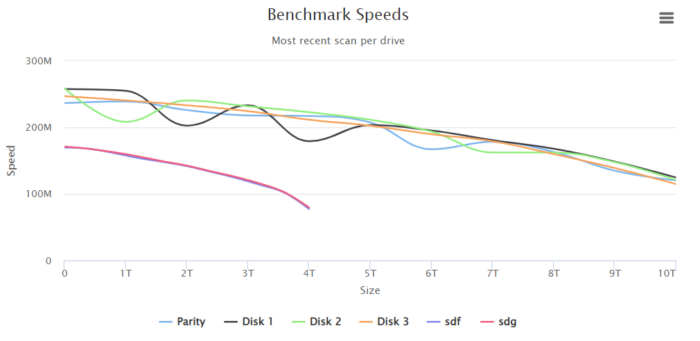

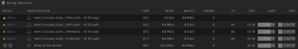

  10. As far as I can tell all of the drives are operating as expected and all connections are fine. It might start our at ~28MB/sec and then it will drop under 10 ๐Ÿ™ƒ I do get a weird result for smart test on the parity drive - Background short Failed in segment --> 3 But it reports are healthy at the same time? Diagnostics file attached Diskspeed tests are also good when benchmarking the drives But, as you can see here the parity drive is only being written really slowly unraid-diagnostics-20230522-1659.zip
