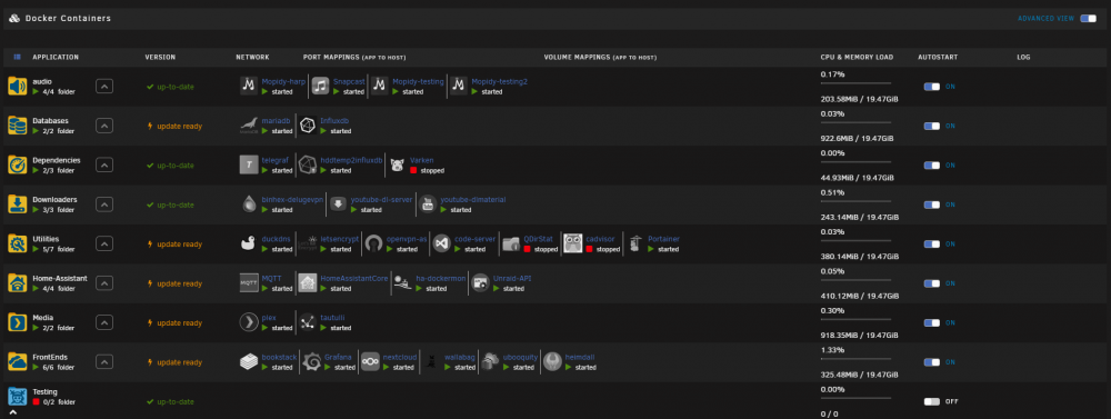

Harmless, but really gets on my OCD though.  If I remove a folder, then I wind up with what is basically a non-existent orphaned image
Update :D
tianon/true should no longer show up
you can now also upload an icon instead of using a link
While testing had the same issue jonathanm experienced, dont know if i fixed what caused it for them but think i fixed what caused it for me.

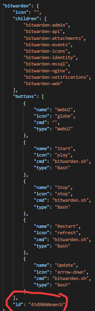

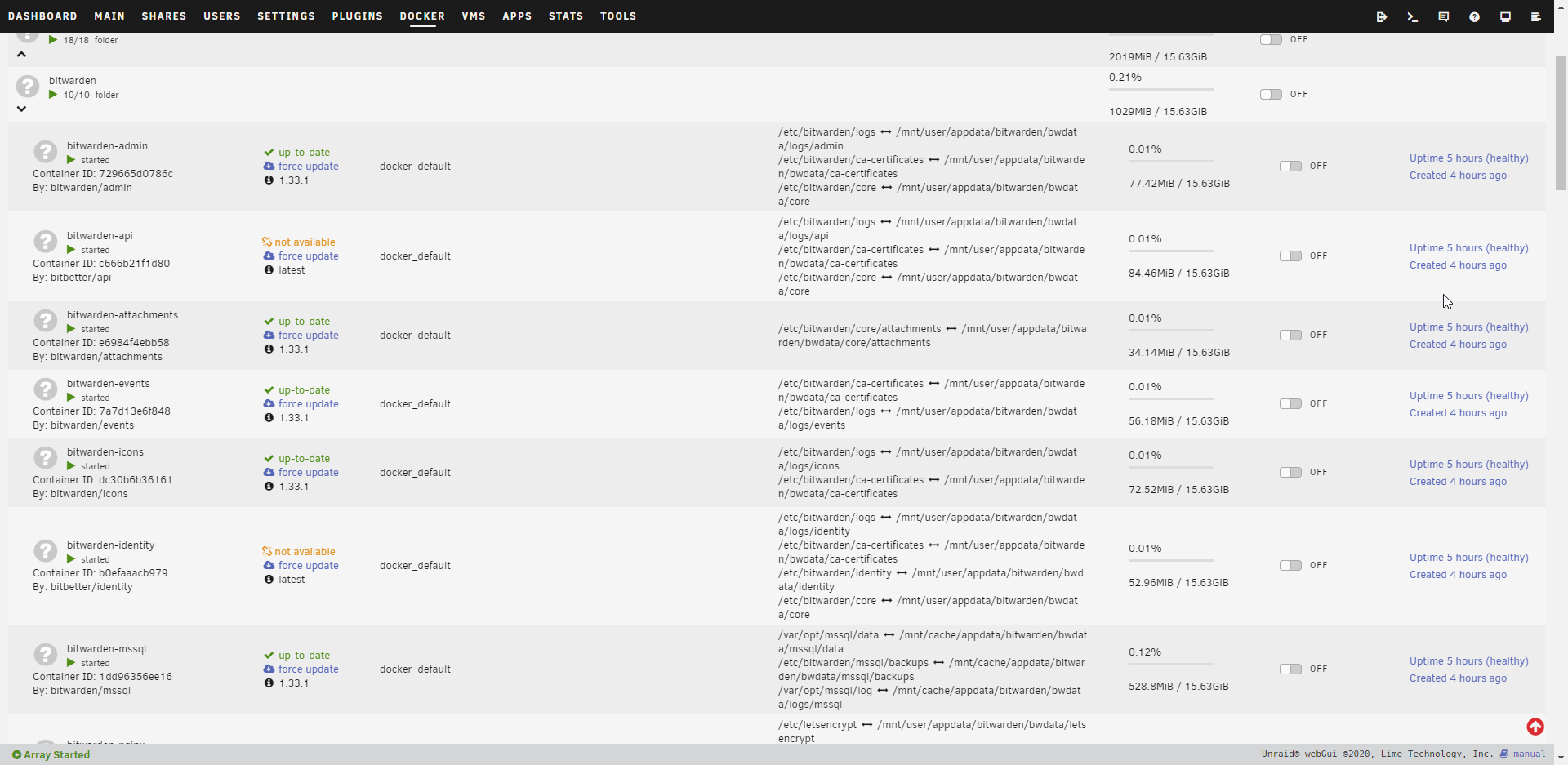

i think i know whats going on.
replace YOURFOLDERNAME with your folder name and run
docker create --name='YOURFOLDERNAME-folder' --net='none' 'tianon/true:latest'
then go to your docker tab and you should see something like
copy the "Container ID"
and replace the id in folders.json with it
try it with one first to see if it works (I hope it does)
Edited by GuildDarts
folder not folders
OK no prob, i'll try this now.
so far so good tried it with one folder and it worked like a charm, i'm going to do the rest now. thank you for the quick response, now i was thinking should i update the plugin before restore the IDs ? last i updated the page wouldn't load im on version 6.8.3
@GuildDartsthank you for the quick response and solution!
