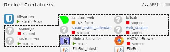

I'm not sure if this is possible, but i would like an option to show the folders expanded and grouped on the main dashboard.  maybe an option to "show expanded" under name and icon in settings, forgive my text image below, but somethign like this:
App               App            App           Folder (2/4)
Folder(1/3)     App            App            App
--------------------------Folder 2/2-------------------------------------------------
App              App

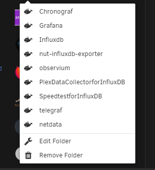

Bug Report, or missing code?
in teh Docker_Sub_Menu, there is only Start/Edit/Remove when already running containers.
I have isolated this to folders that have less than 100% running.
ie.
5/5 running, full sub menus as expected.
1/5 running, all 5 have Start only

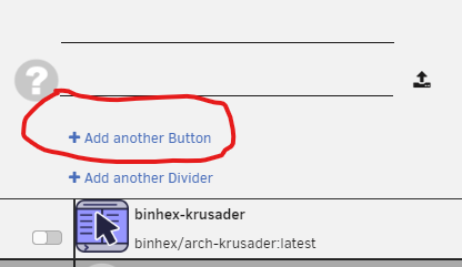

13 hours ago, melmurp said:
Is there a setting for this? I just get the Edit/Remove
im guessing you're referring to multiple buttons.
When you press "edit folder" there is a blue button called "Add another Button" press it and you should get a popup with options for buttons
Thanks for doing the hard work of figuring out whats the cause. Will fix ^_^

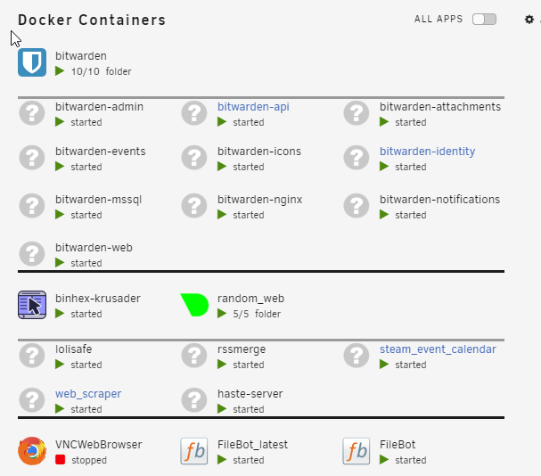

I could definitely add an option to show folders expanded on the dashboard. The only problem is making it not look really bad.
Below are two ways i could think of doing it, i think both dont look very nice, but i cant think of a nicer way of doing it:(
achii.png.928ff61d43af386f72a35bcf2feaab26.pngdasboraad.png.af1d13e53db8adc95ac900c8b9363128.png

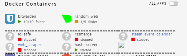

44 minutes ago, GuildDarts said:
this is exactly what i was hoping for!
Okay i will try and figure out a way to do this. Also did you want a button to expand the folder or just have an option to start expanded?
also fixed the Docker_Sub_Menu issue :)
i think having it start expanded when the option is enabled will be cleaner, and if you can encapsulate it with hard horizontal rules, it would look like it belongs on the dashboard in my opinion.
That was it... tks!
Wasn't obvious to me they needed to be added one by one

Update
you can now have dockers expanded on dashboard ( @capt.asic hope its kinda what you imagined :))
