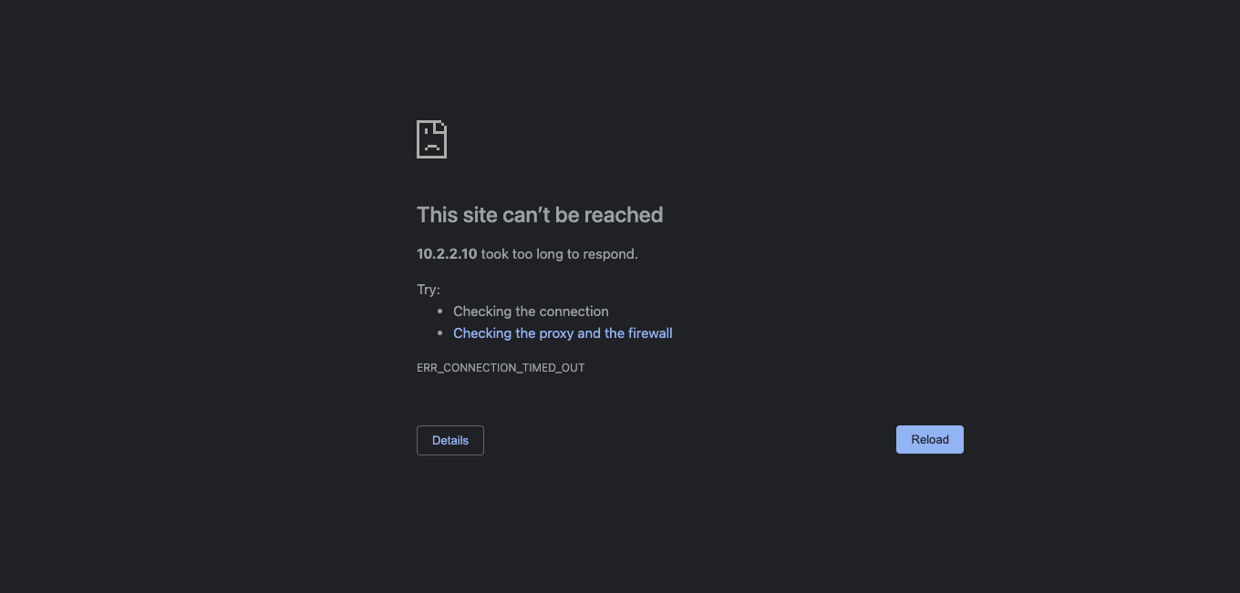

  7. Ah sorry! My current IP is 10.10.10.146 and I can get to 10.2.2.10 just fine via traceroute traceroute to 10.2.2.10 (10.2.2.10), 64 hops max, 52 byte packets 1 setup.ubnt.com (10.10.10.1) 3.058 ms * 4.542 ms 2 10.10.10.201 (10.10.10.201) 2.289 ms 2.838 ms 3.330 ms 3 docile (10.2.2.10) 3.737 ms 2.480 ms 2.902 ms Is there anything within the container locking down access to the LAN_NETWORK or something similar? Update: I set my webtop container to the same network as the host (10.2.2.0/24) and verified I was unable to access it there either. Update 2: I set my webtop container to the bestitpros network, and I can access it here via 10.2.2.10:8112 in the container. Now I'm really wondering if there is an allowance or something for the WebUI

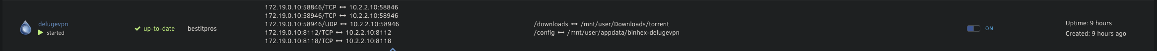

  8. I'm attempting to connect to http://10.2.2.10:8112/ Here's my running container: Here's the message I get when attempting to load the site:
