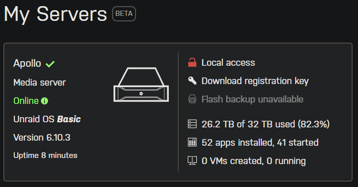

  20. Wanted to tag along with reporting my issues, I'm sure they're all similar I verified I can see my server under My Servers on here I've attached my /var/log/gitflash file Seems I keep getting the below [email protected]: Permission denied (publickey). I wanted to note, I updated the plugin and then rebooted, uptime is below root@Apollo:~# uptime 13:14:47 up 10 min, 1 user, load average: 2.17, 3.94, 2.57 My server is also not currently showing connected to the mothership, but shows online on the Unraid form. Update: After running "unraid-api restart" it's now showing connected to the mothership on the dropdown but still same error, "Failed to sync flash backup" I also get the below error, like d3rax. root@Apollo:~# ssh backup.unraid.net [email protected]: Permission denied (publickey). apollo-diagnostics-20220902-1557.zip gitflash
