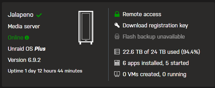

August 18, 20224 yr Hello, I am having the same issue as a few others in the forum. I installed unraid and got everything up and running, but the flash backup from the my servers plugin won't do anything even though it is activated. I reinitialized a few times with no backup happening at the end, I also tried to manually click Update button, but no backup got done. On the my-servers site my server is shown as online, just the Flash backup option says "Flash backup unavailable" in grey. DNS Servers used are from google: 8.8.8.8 and 8.8.4.4 and their respective ipv6 versions: 2001:4860:4860::8888 and 2001:4860:4860::8844 I tried pinging backup.unraid.net from the terminal and the ip 54.70.72.154 got resolved but all packets transmitted were lost. I then used traceroute to find out weather there was a routing problem, it never arrived at 54.70.72.154 Here is part of my traceroute Quote 1 my router 2 * * * 3 de-aah01a-rd01-ae13-1010.aah.unity-media.net (80.69.106.116) 24.088 ms 24.151 ms 22.442 ms 4 de-aah01a-rd04-ae-0-0.aorta.net (84.116.196.174) 30.619 ms 30.506 ms 30.536 ms 5 de-fra04d-rc1-ae-21-0.aorta.net (84.116.196.178) 30.726 ms 32.320 ms 30.765 ms 6 84.116.190.94 (84.116.190.94) 28.721 ms 26.131 ms 26.144 ms 7 ae32-100-pcr1.fnt.cw.net (195.2.18.217) 26.333 ms 15.584 ms ae8-100-tcr1.fnt.cw.net (195.2.26.93) 23.544 ms 8 ae34-pcr1.fnt.cw.net (195.2.31.38) 101.561 ms telia-gw.fnt.cw.net (195.2.22.238) 24.191 ms 22.548 ms 9 telia-gw.fnt.cw.net (195.2.22.238) 22.699 ms 24.180 ms 22.536 ms 10 prs-bb2-link.ip.twelve99.net (62.115.122.138) 29.120 ms ffm-bb2-link.ip.twelve99.net (62.115.124.118) 24.209 ms ffm-bb1-link.ip.twelve99.net (62.115.124.116) 20.998 ms 11 rest-bb1-link.ip.twelve99.net (62.115.122.159) 101.550 ms ash-bb2-link.ip.twelve99.net (62.115.112.242) 103.882 ms prs-bb1-link.ip.twelve99.net (62.115.123.13) 24.888 ms 12 ash-bb2-link.ip.twelve99.net (62.115.112.242) 101.430 ms lax-b22-link.ip.twelve99.net (62.115.121.220) 162.237 ms 165.697 ms 13 vadata-svc071505-lag003386.ip.twelve99-cust.net (213.248.103.253) 167.165 ms 159.273 ms lax-b22-link.ip.twelve99.net (62.115.121.220) 168.810 ms 14 a100-ic325183-las-b24.ip.twelve99-cust.net (62.115.155.111) 164.037 ms * * 15 * * * 16 * * * after that it just continues with * * * for every line Do I need to forward a port for the flash backup to work ? Is maybe my provider having problems so I cannot reach the backup server? I just don't know where to look for a solution as most others in the forum with the same problem had it resolved without doing anything. I hope you can help me fixing this problem Thanks in advance Edited August 18, 20224 yr by Tanne
August 18, 20224 yr traceroute and ping are not going to respond, the behavior you are seeing is expected. No port forward is required for flash backup. As you might have seen in some of my other responses, we are having intermittent issues at the moment. We made some changes today that will hopefully help, are your backups working now?

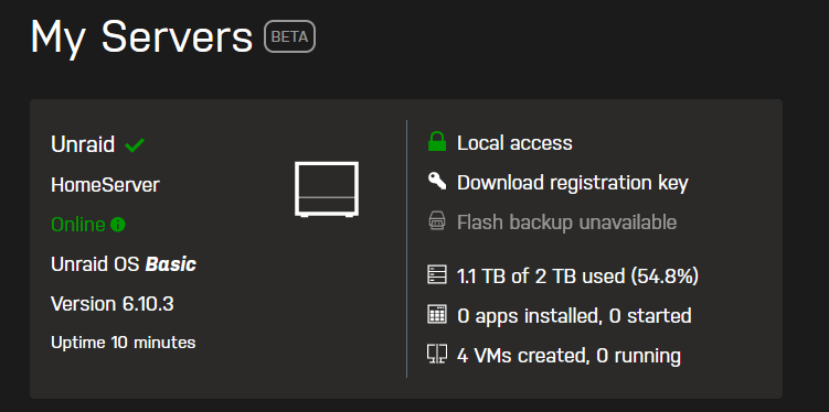

August 22, 20224 yr I'm also having this problem. Remote access is working fine, but I see "Flash backup unavailable" and "Not connected to the mothership" in the Unraid UI. I've rebooted the server, deactivated and re-activated the flash drive backup but it's still not working. I'm on Unraid 6.9.2

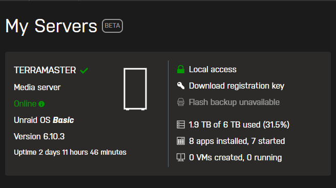

August 24, 20224 yr Same issue here.. it's connected and shows up in my server but if I click update flash drive it doesn't seem to do anything. Also same thing in the latest unstable r3 version.
