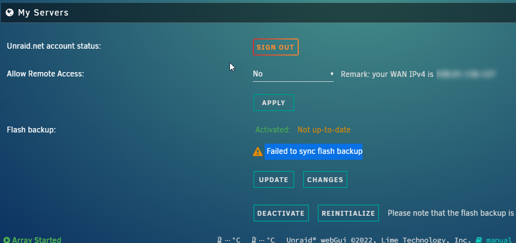

Hopefully I'm not duplicating a thread for this matter... I have two different Unraid servers on my network. The first one connected and is backing up properly with My Servers App. My second one says "Activated", but will not back up the flash no matter what I do.

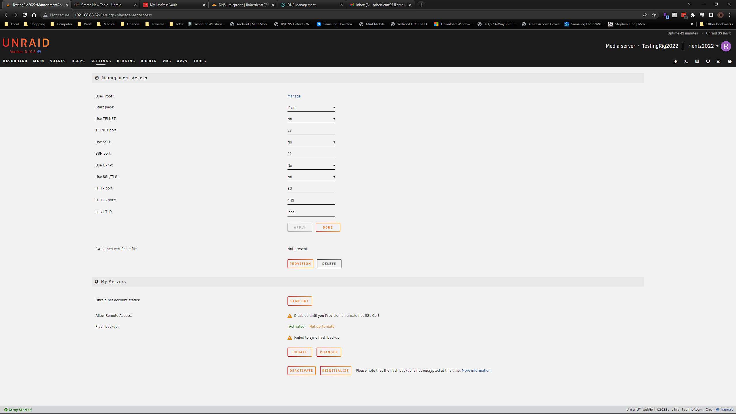

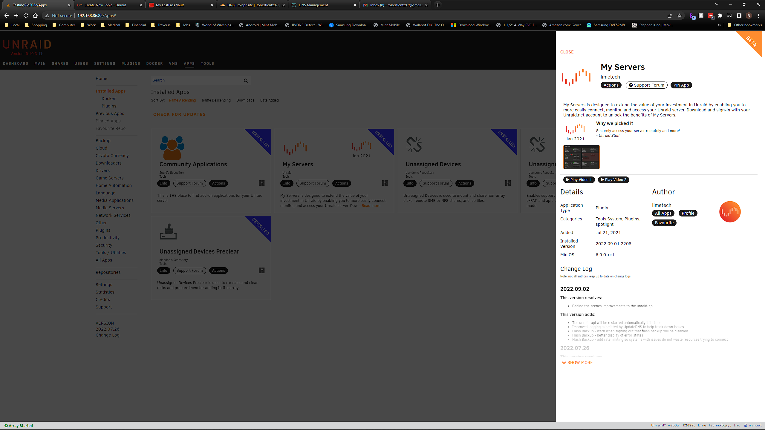

Here is screenshots and the logs. As you can probably tell, This is a BRAND new install with nothing except a couple apps...
Any help appreciated

Same it says 'rate limited'
Having the same issue. There was a  patch for the plugin a few days back but still hasnt changed my status. Mine says " Failed to sync flash backup" Even after signing out of Unraid.net, reinitializing..etc..

Thanks for letting us know you're still having issues. I am seeing intermittent errors as well but after retrying a few times it always connects. We are going to do another round of server side tweaks before asking for your logs.
In the meantime, if your online flash backup is out of date please make a manual backup of your flash drive by going to Main -> Boot Device -> Flash -> Flash Device Settings -> Flash Backup

Nothing really for you to try manually at the moment, just use the system normally and it will retry connecting when it sees changes. We are going to do another round of server side tweaks before asking for your logs.
Same problem with the latest my servers plugin 2022.09.06.2108 - Failed to sync flash backup.

We are indeed seeing improvements, thanks for confirming you are able to connect now!  There is still one more thing we want to resolve on our end before declaring this fixed and moving on to tracking down individual system issues. Thanks for your patience.
