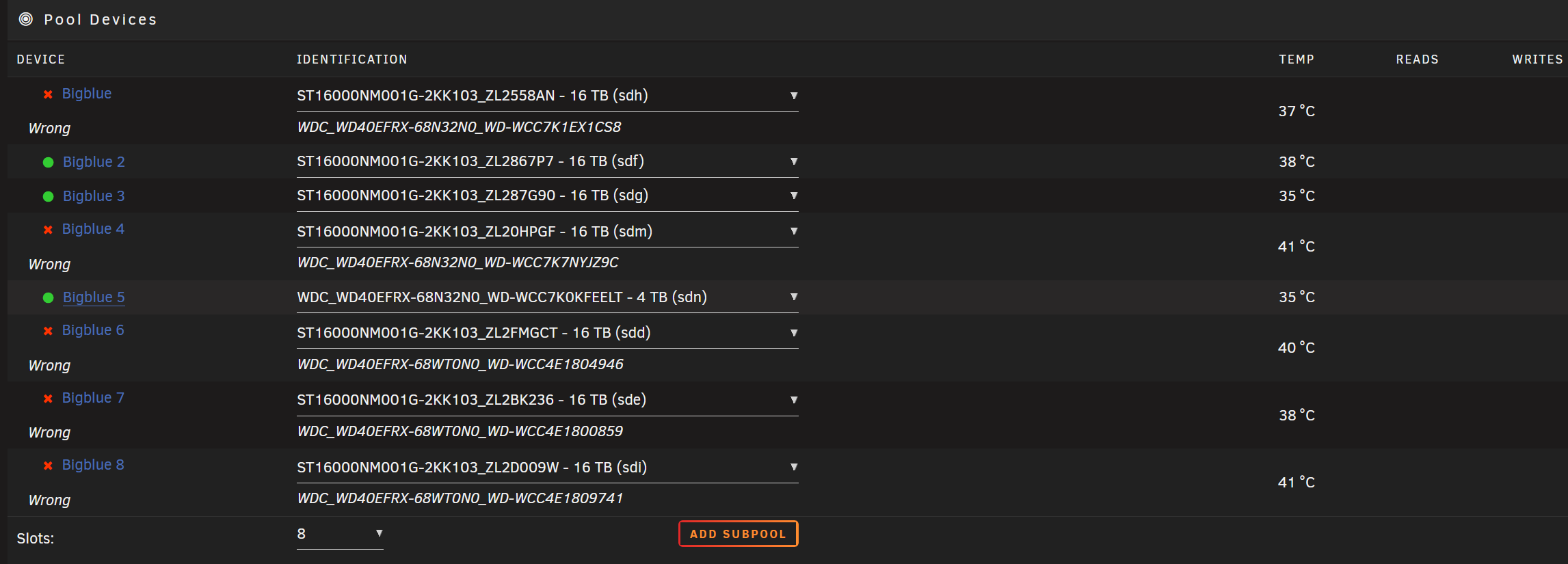

That worked, what's the correct way to replace the last drive and autoexpand the array when the resilvering is done?

Here you go... root@Beast:~# zpool import pool: prossd id: 10603483798625687601 state: ONLINE status: Some supported features are not enabled on the pool. (Note that they may be intentionally disabled if the 'compatibility' property is set.) action: The pool can be imported using its name or numeric identifier, though some features will not be available without an explicit 'zpool upgrade'. config: prossd ONLINE mirror-0 ONLINE sdb ONLINE sdc ONLINE pool: bigblue id: 5709855171605561477 state: ONLINE status: Some supported features are not enabled on the pool. (Note that they may be intentionally disabled if the 'compatibility' property is set.) action: The pool can be imported using its name or numeric identifier, though some features will not be available without an explicit 'zpool upgrade'. config: bigblue ONLINE raidz2-0 ONLINE ata-ST16000NM001G-2KK103_ZL2558AN ONLINE sdn ONLINE sde ONLINE sdf ONLINE sdg ONLINE sdd ONLINE sdm ONLINE sdi ONLINE root@Beast:~#

Hello All, I have been in the process of swapping the drives in my 8 drive ZFS2 array named Bigblue. The reason was two fold. The first being another 4TB drive had started to show errors, the second being I had already previously swapped two of the 4 TB drives for 16TB. I have purchased 6 more 16TB drives and have swapped all but one using zpool offline bigblue GUID > followed by zpool replace bigblue GUID sd#. Earlier I asked on discord why the drives weren't showing in the interface and were listed as dev, and was told the way I had swapped them was wrong. So I stopped the array and when selecting the correct drives for replacing in the UI, I see a wrong label. What is the correct process to remedy this? Remove the array (not delete) and then re-add? Let me know if I need to attach any logs.
