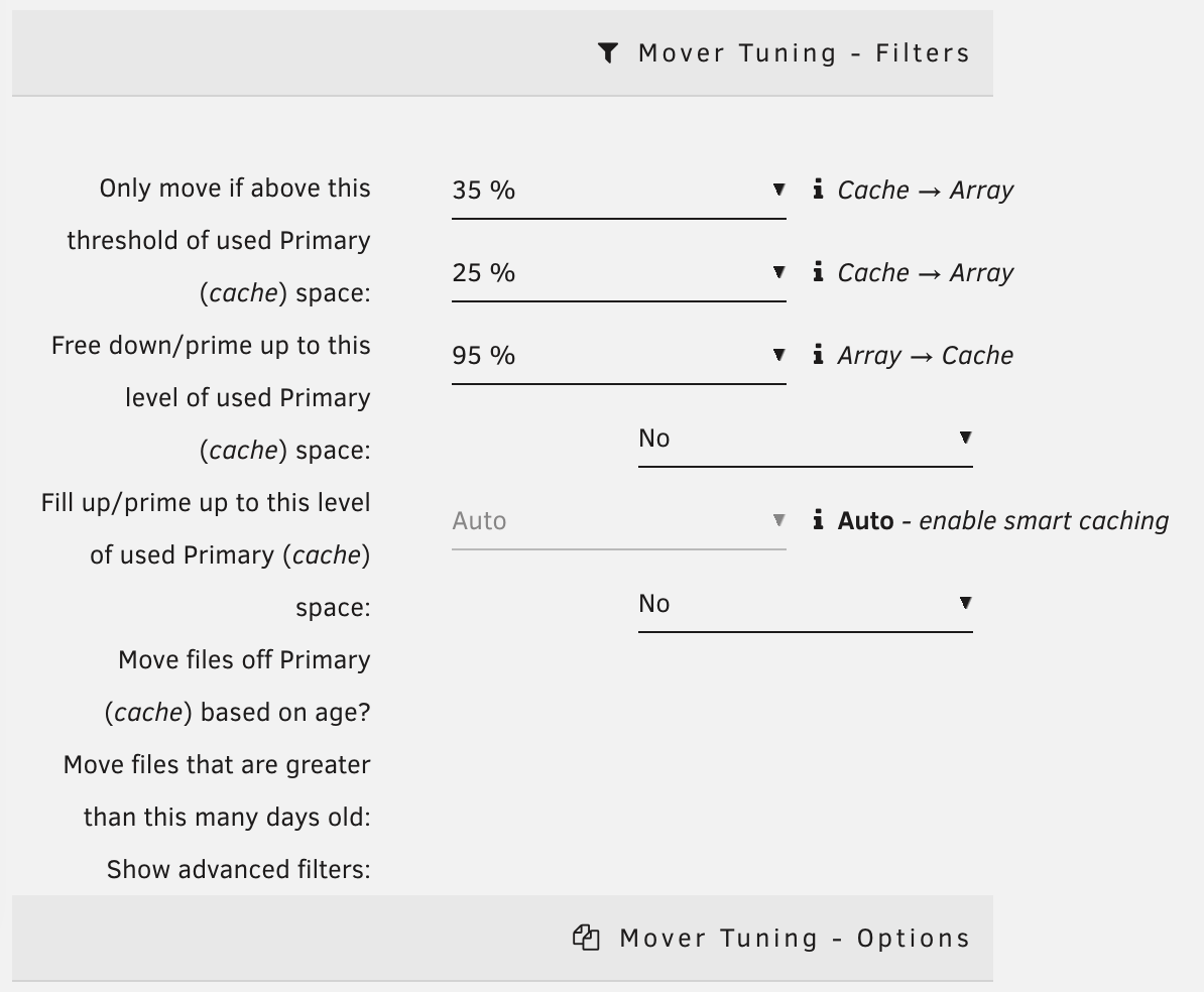

  4. Same as @Frozst I want to have mover ignore a directory but don't actually see the option. No ignore on the settings page.
