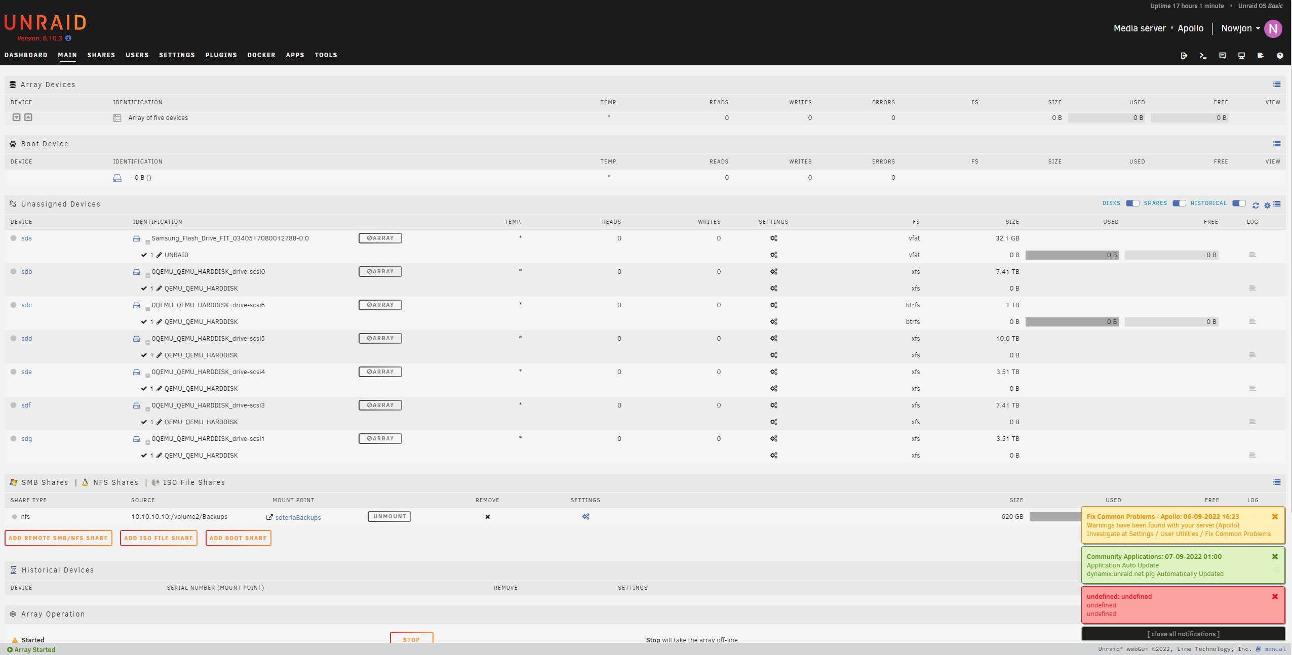

September 7, 20224 yr Hello! I noticed here recently, especially after installing the "My Servers" plugin (But I'm not sure if that's caused it, I've uninstalled it for now and will see if I continue to get this), I've been having issues with my UNRAID server. This has been happening every day, when I go to the Main tab it doesn't really show my disks correctly, and I have the "undefined: undefined" error you see in the screenshot. I attempted to pull the Diagnostics but was unable to as it just wouldn't finish loading. I've pulled the syslog, and there are errors, but I'm not really sure if any of them are pointing to the issue or not. Could anyone take a look and let me know if you see anything specific you think could be causing this behavior? Appreciate any time and all the effort of the community UNRAID Syslog
September 7, 20224 yr Looks like the error starts here : Sep 7 06:29:09 Apollo unraid-api[5054]: ⚠️ Caught exception: Maximum call stack size exceeded Sep 7 06:29:09 Apollo unraid-api[5054]: ⚠️ UNRAID API crashed with exit code 1 Sep 7 06:40:53 Apollo nginx: 2022/09/07 06:40:53 [crit] 5329#5329: *407337 pwritev() "/var/lib/nginx/client_body/0000049031" has written only 4096 of 9051, client: unix:, server: , request: "POST /pub/disks?buffer_length=1 HTTP/1.1", host: "localhost" Sep 7 06:43:37 Apollo nmbd[23864]: [2022/09/07 06:43:37.650269, 0] ../../source3/lib/util.c:482(reinit_after_fork) Sep 7 06:43:37 Apollo nmbd[23864]: messaging_reinit() failed: NT_STATUS_DISK_FULL Sep 7 06:46:29 Apollo kernel: TCP: request_sock_TCP: Possible SYN flooding on port 32611. Sending cookies. Check SNMP counters. Sep 7 06:48:02 Apollo unraid-api[32346]: ✔️ UNRAID API started successfully! Sep 7 06:48:07 Apollo unraid-api[32346]: ⚠️ Caught exception: Maximum call stack size exceeded Sep 7 06:48:07 Apollo unraid-api[32346]: ⚠️ UNRAID API crashed with exit code 1 Sep 7 06:58:05 Apollo unraid-api[20466]: ✔️ UNRAID API started successfully! Sep 7 06:58:15 Apollo unraid-api[20466]: ⚠️ Caught exception: Maximum call stack size exceeded Sep 7 06:58:15 Apollo unraid-api[20466]: ⚠️ UNRAID API crashed with exit code 1 Sep 7 06:58:37 Apollo nmbd[23214]: [2022/09/07 06:58:37.656692, 0] ../../source3/lib/util.c:482(reinit_after_fork) Sep 7 06:58:37 Apollo nmbd[23214]: messaging_reinit() failed: NT_STATUS_DISK_FULL Sep 7 07:13:37 Apollo nmbd[18929]: [2022/09/07 07:13:37.660920, 0] ../../source3/lib/util.c:482(reinit_after_fork) Sep 7 07:13:37 Apollo nmbd[18929]: messaging_reinit() failed: NT_STATUS_DISK_FULL Sep 7 07:18:09 Apollo unraid-api[27759]: ✔️ UNRAID API started successfully! Sep 7 07:18:12 Apollo unraid-api[27759]: ⚠️ Caught exception: Maximum call stack size exceeded Sep 7 07:18:12 Apollo unraid-api[27759]: ⚠️ UNRAID API crashed with exit code 1 Sep 7 07:28:37 Apollo nmbd[15440]: [2022/09/07 07:28:37.667499, 0] ../../source3/lib/util.c:482(reinit_after_fork) Sep 7 07:28:37 Apollo nmbd[15440]: messaging_reinit() failed: NT_STATUS_DISK_FULL Sep 7 07:28:42 Apollo smbd[15577]: [2022/09/07 07:28:42.980566, 0] ../../source3/lib/util.c:482(reinit_after_fork) Sep 7 07:28:42 Apollo smbd[15577]: messaging_reinit() failed: NT_STATUS_DISK_FULL Sep 7 07:43:37 Apollo winbindd[8829]: [2022/09/07 07:43:37.655531, 0] ../../source3/lib/util.c:482(reinit_after_fork) Sep 7 07:43:37 Apollo winbindd[8829]: messaging_reinit() failed: NT_STATUS_DISK_FULL Sep 7 07:43:37 Apollo nmbd[8830]: [2022/09/07 07:43:37.670856, 0] ../../source3/lib/util.c:482(reinit_after_fork) Sep 7 07:43:37 Apollo nmbd[8830]: messaging_reinit() failed: NT_STATUS_DISK_FULL Sep 7 07:43:43 Apollo smbd[8972]: [2022/09/07 07:43:43.084651, 0] ../../source3/lib/util.c:482(reinit_after_fork) Sep 7 07:43:43 Apollo smbd[8972]: messaging_reinit() failed: NT_STATUS_DISK_FULL Sep 7 07:59:35 Apollo nginx: 2022/09/07 07:59:35 [crit] 5329#5329: *450673 pwritev() "/var/lib/nginx/client_body/0000049032" failed (28: No space left on device), client: unix:, server: , request: "POST /pub/disks?buffer_length=1 HTTP/1.1", host: "localhost" Sep 7 08:09:46 Apollo unraid-api[21794]: ✔️ UNRAID API started successfully! Sep 7 08:11:45 Apollo unraid-api[21794]: ⚠️ Caught exception: Maximum call stack size exceeded Sep 7 08:11:45 Apollo unraid-api[21794]: ⚠️ UNRAID API crashed with exit code 1 Sep 7 08:28:37 Apollo winbindd[25498]: [2022/09/07 08:28:37.669425, 0] ../../source3/lib/util.c:482(reinit_after_fork) Sep 7 08:28:37 Apollo winbindd[25498]: messaging_reinit() failed: NT_STATUS_DISK_FULL Sep 7 08:28:37 Apollo nmbd[25499]: [2022/09/07 08:28:37.700896, 0] ../../source3/lib/util.c:482(reinit_after_fork) Sep 7 08:28:37 Apollo nmbd[25499]: messaging_reinit() failed: NT_STATUS_DISK_FULL Sep 7 08:43:37 Apollo winbindd[17959]: [2022/09/07 08:43:37.674478, 0] ../../source3/lib/util.c:482(reinit_after_fork) Sep 7 08:43:37 Apollo winbindd[17959]: messaging_reinit() failed: NT_STATUS_DISK_FULL Sep 7 08:43:37 Apollo nmbd[17960]: [2022/09/07 08:43:37.709682, 0] ../../source3/lib/util.c:482(reinit_after_fork) Sep 7 08:43:37 Apollo nmbd[17960]: messaging_reinit() failed: NT_STATUS_DISK_FULL Sep 7 08:43:43 Apollo smbd[18115]: [2022/09/07 08:43:43.459556, 0] ../../source3/lib/util.c:482(reinit_after_fork) Sep 7 08:43:43 Apollo smbd[18115]: messaging_reinit() failed: NT_STATUS_DISK_FULL Sep 7 08:58:37 Apollo winbindd[11312]: [2022/09/07 08:58:37.678150, 0] ../../source3/lib/util.c:482(reinit_after_fork) Sep 7 08:58:37 Apollo winbindd[11312]: messaging_reinit() failed: NT_STATUS_DISK_FULL Sep 7 08:58:37 Apollo nmbd[11313]: [2022/09/07 08:58:37.721422, 0] ../../source3/lib/util.c:482(reinit_after_fork) Sep 7 08:58:37 Apollo nmbd[11313]: messaging_reinit() failed: NT_STATUS_DISK_FULL Sep 7 09:10:07 Apollo root: error: /webGui/include/Notify.php: uninitialized csrf_token Sep 7 09:10:07 Apollo root: error: /plugins/community.applications/scripts/notices.php: uninitialized csrf_token Sep 7 09:10:07 Apollo root: error: /webGui/include/Report.php: uninitialized csrf_token Sep 7 09:10:15 Apollo unassigned.devices: PHP Warning: syntax error, unexpected end of file, expecting TC_DOLLAR_CURLY or TC_QUOTED_STRING or ''' in /usr/local/emhttp/state/disks.ini on line 270 in /usr/local/emhttp/plugins/unassigned.devices/include/lib.php on line 49 Sep 7 09:10:15 Apollo unassigned.devices: PHP Warning: Invalid argument supplied for foreach() in /usr/local/emhttp/plugins/dynamix/include/DefaultPageLayout.php(528) : eval()'d code on line 21 Sep 7 09:10:15 Apollo root: error: /webGui/include/Notify.php: uninitialized csrf_token Sep 7 09:10:15 Apollo root: error: /webGui/include/Report.php: uninitialized csrf_token Sep 7 09:10:15 Apollo root: error: /plugins/community.applications/scripts/notices.php: uninitialized csrf_token Sep 7 09:10:15 Apollo root: error: /plugins/dynamix.plugin.manager/scripts/PluginAPI.php: uninitialized csrf_token Sep 7 09:10:15 Apollo root: error: /plugins/unassigned.devices/UnassignedDevices.php: uninitialized csrf_token Sep 7 09:10:15 Apollo root: error: /plugins/unassigned.devices/UnassignedDevices.php: uninitialized csrf_token Sep 7 09:10:18 Apollo root: error: /plugins/unassigned.devices/UnassignedDevices.php: wrong csrf_token Sep 7 09:10:21 Apollo root: error: /webGui/include/Report.php: uninitialized csrf_token Sep 7 09:10:21 Apollo root: error: /plugins/unassigned.devices/UnassignedDevices.php: uninitialized csrf_token Sep 7 09:10:22 Apollo unassigned.devices: PHP Warning: file_put_contents(): Only -1 of 114 bytes written, possibly out of free disk space in /usr/local/emhttp/plugins/unassigned.devices/include/lib.php on line 92 Sep 7 09:10:22 Apollo unassigned.devices: PHP Warning: file_put_contents(): Only -1 of 2420 bytes written, possibly out of free disk space in /usr/local/emhttp/plugins/unassigned.devices/include/lib.php on line 210 Sep 7 09:10:22 Apollo unassigned.devices: PHP Warning: file_put_contents(): Only -1 of 114 bytes written, possibly out of free disk space in /usr/local/emhttp/plugins/unassigned.devices/include/lib.php on line 92 Sep 7 09:10:22 Apollo unassigned.devices: PHP Warning: file_put_contents(): Only -1 of 2225 bytes written, possibly out of free disk space in /usr/local/emhttp/plugins/unassigned.devices/include/lib.php on line 210 Sep 7 09:10:23 Apollo unassigned.devices: PHP Warning: file_put_contents(): Only -1 of 114 bytes written, possibly out of free disk space in /usr/local/emhttp/plugins/unassigned.devices/include/lib.php on line 92 and then the php errors from UD continue. They might be the consequence of the previous errors, not the cause ?
