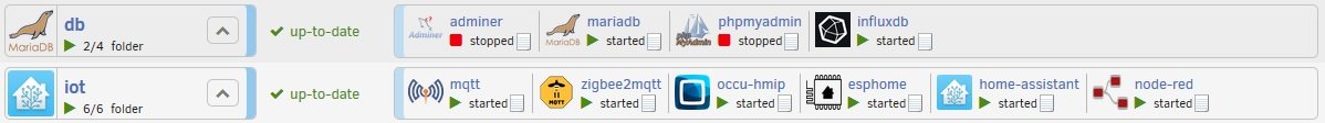

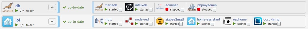

Hello,
just tried to install your addon but found out that I'm not able to correctly order my containers. When I order containers in one group it'll shuffle other group and vice-versa. Is there some way how to do it? I have quite a few containers depending on startup order so it's showstopper for me.
50 minutes ago, bambi73 said:
Hello,
Yeah that's not supposed to happen.
one thing you could try is "reset sorting" i know its not ideal but sometimes that fixes things
hope that fixes if not i will think i bit hard about what might be causing it:)
Tried that but it doesn't help. It simply sorts dockers alphabetically by name.
When I try arrange my groups then same happen again.
Order after I arrange DB folder
DB is ok, but IOT is shuffled.
Order after I arrange IOT folder
IOT is ok, but DB is shuffled.
What I noticed is that it isn't random shuffle but it always ends in same, but anyway wrong, order. I tried to find what order is used but without success.
So just tried sorting my folders and also got the reset of sorting.
Will be sure to fix this by next update ^_^ (should be in 1-2 days)
Great, thanks :)

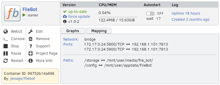

Update

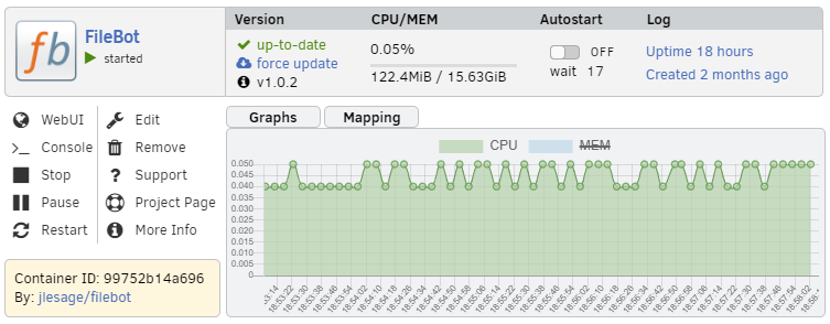

  • Added: Advanced context menu (thanks @hernandito)
  • Fixed: Folders sometimes not loading
  • Fixed: Log icon not showing in advanced view
  • Fixed: Sort-order getting reset on sort (@bambi73 this should fix it xD)

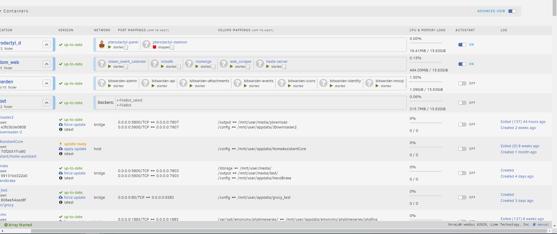

advanced-context-menu_mapping.png.151b9a97465000b5d589fe8a76499828.pngadvanced-context-menu_graph.png.ae59f9d700b9257ee10f3d394d0db25c.png

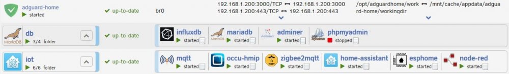

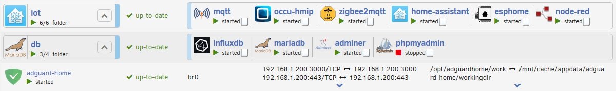

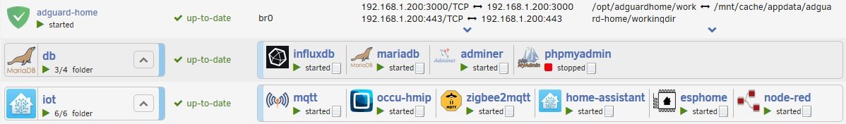

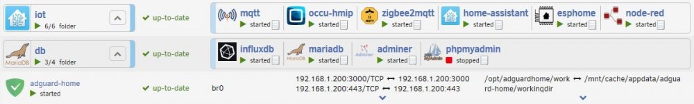

@GuildDarts Checked new version and after quick test it looks like shuffle problem was solved. But another one appeared :)
When I create and arrange folders it looks like
But when I refresh page or go somewhere else and back folders itself reorders like
It looks like presentation problem because when I check Dockerman userprefs.cfg order of folders and containers is correct
Problem happen if folder is touched (modified) in this state because order is then persisted as it is (in wrong state).
Additional questions/notes:
  • Is font size for folder names intentional? I plan to combine folders with regular containers so bold font with double size looks really weird.
  • Is it really necessary to have folder name different than existing container? From userprefs.cfg it looks like folder is using "-folder" postfix so I'm curious. In pictures above I'd like to name iot folder home-assistant because it's basically it + some supporting plugins.
  • You should add check for dot in folder name. It completely destroy plugin and isn't recoverable without manual editing (probably) or reinstall :)
@bambi73 should be fixed now, thanks for the excellent info ^_^

@GuildDarts looks good now. Only one small glitch remaining 🙃
When folder name is changed folder is always placed on top of the list. Changes to other folder properties doesn't cause this behavior so it's only minor issue.

Potential problems:
  • From observation it looks like Advance context menu is able to gather cpu/mem data only when Advanced view is selected. If it isn't possible to gather data in Basic mode then it'll be probably better to grey out cpu/mem indicators and graphs or leave them completely. Graphs stays on last known value and so it looks weird.
  • Looks like gathering data for graphs is quite CPU hog. My current desktop is really crappy so probably for newer computers it isn't problem but it could be problems for phones/tablets.
  • From CPU workload it looks like it gathers data even in Basic mode when it gets static values, so there is potential for optimization.
This should be fixable forgot to make it also rename in the userprefs.cfg :)
Yeah also spotted this bug. There is probably a way for me to make it get the data even in basic view.
Yeah i know it's not the most optimized thing ever, will ofcoure try and make it better but its never gonna be great. Might want to have an option to disable on mobile or if the device is not that powerfull
21 minutes ago, bambi73 said:
Make folder name clickable and linked to edit mode (same behavior as regular container names)
Somehow show which container in the folder has update available without necessity to open whole list. Maybe use different color (same like for "update ready") for container name. I don't have any better proposal :)
Will do both of these ^_^
23 minutes ago, bambi73 said:
Make container icon in Advanced context menu not clickable. At the moment it opens standard container context menu which isn't really necessary (as all links are already available) and additionally it opens below your popup.
will also fix this, thought i had done itO.o

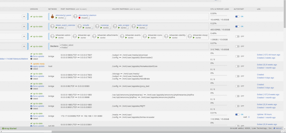

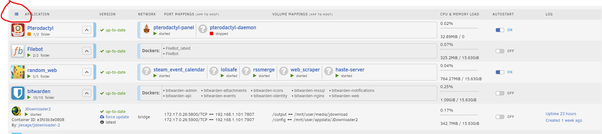

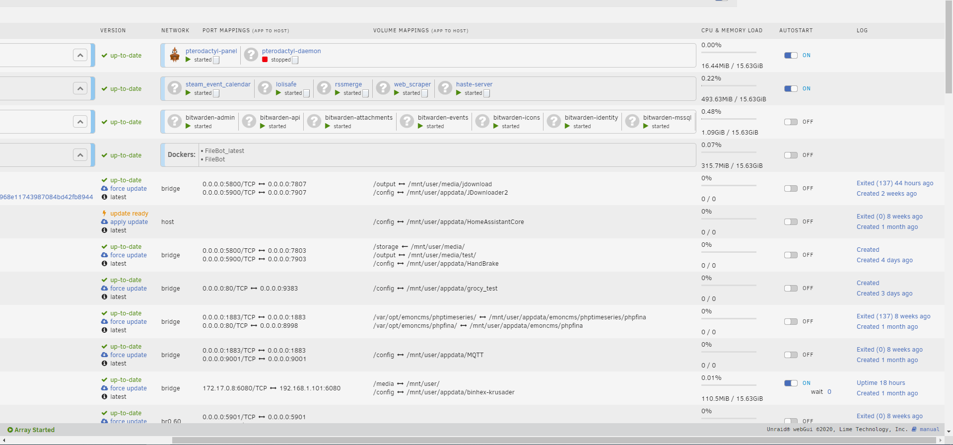

Decent plugin, I like the organization aspect of it. A couple issues I have though:
1. When editing a folder, if the docker repository shows a long string, such as the sha256 version, the check-marks aren't in the correct place.
2. Unlike usual, where everything is shown on the screen properly, when having a lot of dockers in a folder, it gets a bit inconvenient and forces you to scroll left and right as well to see more information per docker. For example, I have 8 dockers in a folder and it goes off page forcing me to scroll to the right to see the CPU/Memory Load, Autostart and Logs. It would be nice if there were a way to fit all of this on the page so it doesn't stretch out of the full width.
Edited by Jad
will fix both of these :)
about 2. im only getting a small bit of having to scroll, it's not the same as in your picture where half the page taken
i thought it might be that long sha265 adding space, so i replaced the "by:" text with it and got similar results.
default.thumb.png.b611a3593a7150428f58524e477d270b.pngsha.thumb.png.3e271309bff6ed900e9e010ac4d81781.png

@bambi73 i think this update addresses everything you pointed up in your post above (except for the performance). Thanks again for your detailed post ^_^
@Jad your issues should hopefully also be fixed :)
Edited by GuildDarts
Folder editor is fixed, nice!
On the docker list page, the only issue now is that the version could show a long string and reproduce the issue of the page stretch. For example:
You may notice this is abnormal behavior, which it likely is. Some of my dockers aren't added via Unraid, so they show values like this, but the dockers still work perfectly fine.
Edited by Jad
