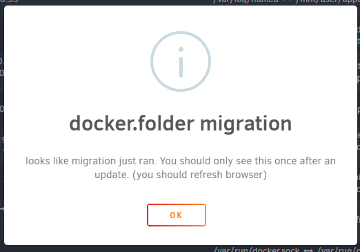

Update
  • Fixed: Refactor migration script and fix a few issues
  • Fixed: folder export
4 hours ago, jonathanm said:
The server with the issue had the plugin installed for some time, but I never actually interacted with it at all, just updated it. The server without the issue had a folder with several items configured.
This should hopefully be fixed now, there was a bug that would covert an object into an array if there were no folders when a migration ran. Stemming from me not reading the docs O.o
Don't know if this is what caused your issue @L0rdRaiden, or if i need to fix something for 6.9.0

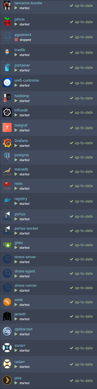

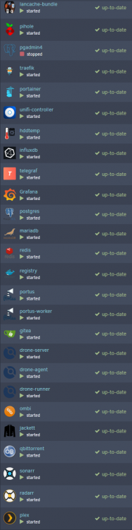

For some reason, the folders have disappeared  since yesterday for me.
When i had about 20 containers, everything was fine. Now i am at 26 containers and i cannot see any folders.
I cant create new folders either, buttons are there, but nothing happens on folder creation.
Tried to flush browser cache, tried to restart the server. Nothing happens, there are still no folders i used to have on the Docker tab.
I am running Unraid 6.8.3 with the plugin of version 2020.07.29
screencapture-Docker-2020-08-10-20_26_47.thumb.png.e4af6dbcdfc561c2f5be40c94f8b5986.png
Maybe something to do with container name length?

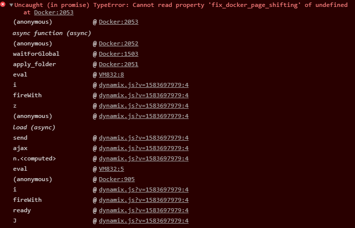

And here is what i see in the Developer Console of Google Chome:

Should hopefully be fixed now, thanks for including browser console error ^_^
For some reason I am still getting this error
This one aswell
Maybe there should be a way to clear list of created folders just in case something similar happens. Just to create them again, as it is much easier to create folders from scratch rather than figuring out what went wrong.
I can see from the configuration file that there should be one folder, however, there are none in the Web UI
Also, every time i am creating new folder, i am greeted with this window
P.S. Nothing happens on browser refresh, still no folders. And the folders.json file is overwritten with new content

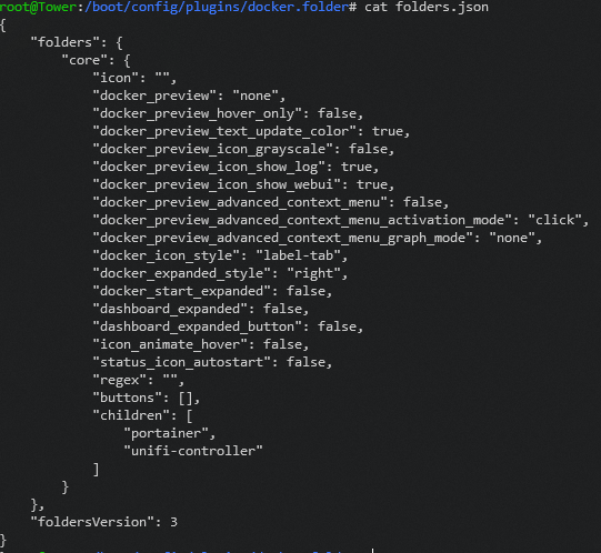

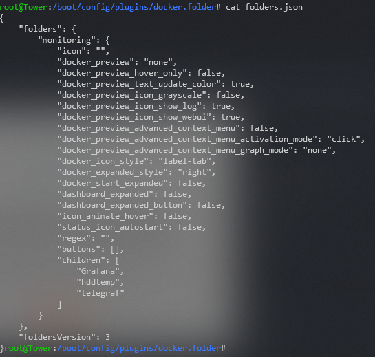

Update #1:
Did the rm folders.json, after file recreation getting this error now, however, folders.json contains all the folders i've created now (not overwriting them)
Docker:1206 source
Seems like you are trying to run the `includes` method on the object rather than array. Here is the "correct" way of doing that i guess
OR, if ES6 is supported, then you can do something like this
!Object.values(prefs).includes(`${folderName}-folder`)
OR if you care about IE
Object.values(prefs).indexOf(`${folderName}-folder`) === -1
I've also made a PR on Github which should fix the problem with "array" vs "object", just 1 new line, and then some replaced variables.
You can view it here
Edited by darki73
@darki73 so i figured out your original error, look like it happens if the settings object is missing from folders.json. Why i might not have been there i've got no clue xD
For me prefs is an array, i remember it turning into an object in the past for me when there was folders loading issues.
You could try Reset sorting or deleting it at "/boot/config/plugins/dockerMan/userprefs.cfg"
Will also include your PR as it still works if prefs is an array so win win :D
