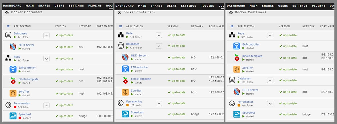

  6. Hello there... First thing: you were supposed to get some rest! after a few hours you were back in here answering questions!! 🤣 Second thing... I guess that the folder order still have something funky going on... Initial situation: Folder 1 -> Container 1.1 - running Folder 2 -> Container 2.1 - running -> Container 2.2 - running -> Container 2.3 - running Folder 3 -> Container 3.1 - stopped So I start the container 3.1: Folder 2 (expanded but empty) Folder 1 -> Container 1.1 - running -> Container 2.1 - running -> Container 2.2 - running -> Container 2.3 - running Folder 3 -> Container 3.1 - running If I collapse and then expand the Folder 2, it became Folder 2 -> Container 2.1 - running -> Container 2.2 - running -> Container 2.3 - running Folder 1 -> Container 1.1 - running Folder 3 -> Container 3.1 - running

  8. Man, that was REALLY quick! it got 100x better, thank you! Not trying to be a pushover, but could I ask for one little thing? I have folder 1 ->docker 1.1 folder 2 ->docker 2.1 ->docker 2.2 folder 3 ->docker 3.1 ->docker 3.2 If I stop the docker 2.2, it show as follow: folder 2 ->docker 2.1 ->docker 2.2 folder 1 ->docker 1.1 folder 3 ->docker 3.1 ->docker 3.2 for some reason now the folder 2 is on top and not the folder 1... if I reload the page the order go back to normal. is there a way to keep the right order? Thank you very much!
