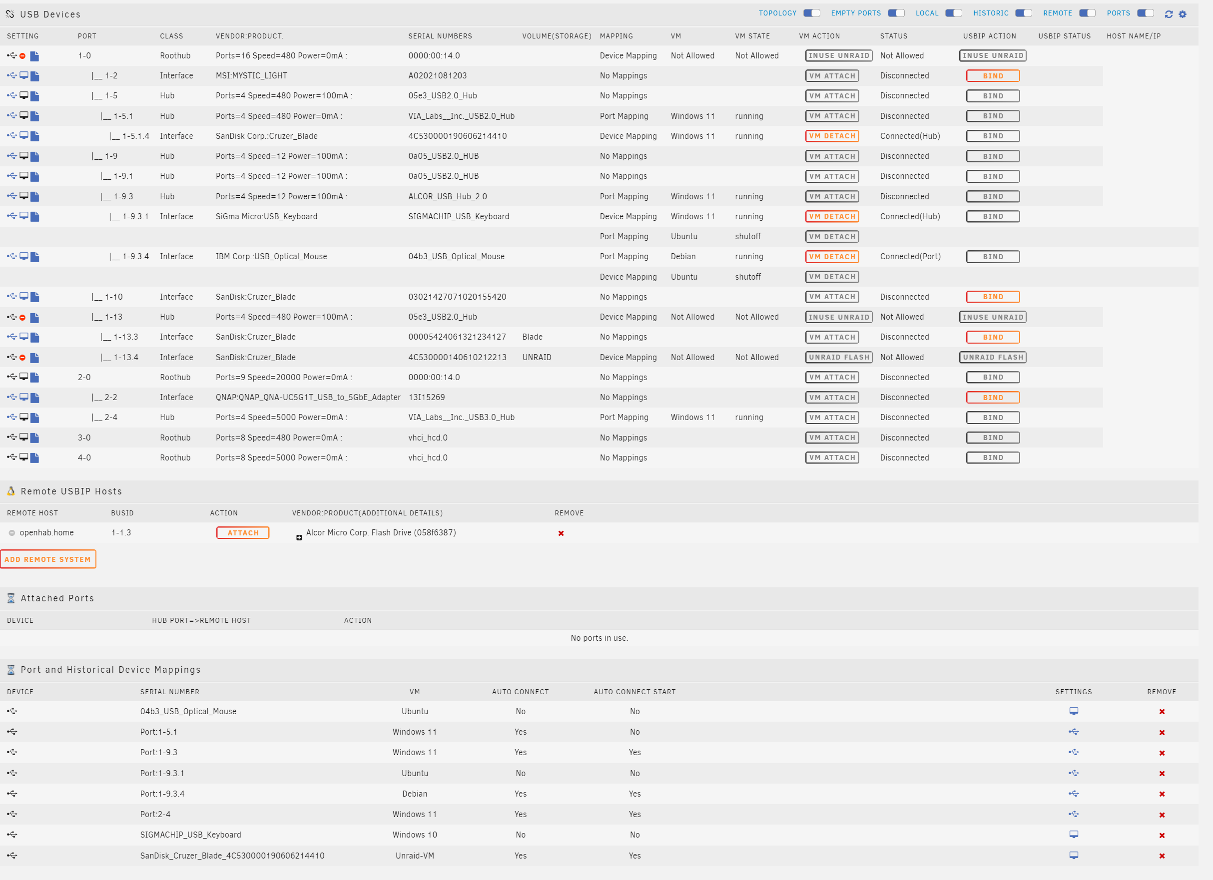

[Plugin] USB_Manager
USB_Manager is in CA as of 6th June 2021, Please continue to use USBIP-GUI but will be replaced by USB_Manager.
The plugin supports attaching multiple USB devices of the same Vendor/Model to a VM. Also it will auto hotplug devices are plugged in if defined and the VM is started.

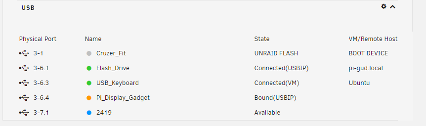

Dashboard View add in 16.02.2021.
To see USBIP Functions you need to enable in Settings. This function is only valid from 6.9.0-rc2 onwards.
Once enabled additional panels are available. (USBIP status and connection host/ip from vers >14.02.21
USB_Manager Change Log

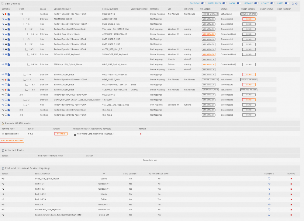

2021.12.12a
Revert 2012.12.12
2021.12.12
 - Add Hub processing.You can define a port mapping for a hub. If connected or vm starts all devices on that hub will be connected to the VM.         Will not process next level down hubs.
  - Chg Disable device mapping for Root Hubs and Hubs. Disable port mapping for Root Hub.
  - Chg Detach button show next to connected port or device on the main line.
  - Fix Buttons if Hotplug mapping used.
  - Note reboot or disconnect/reconned of Hub may be required.

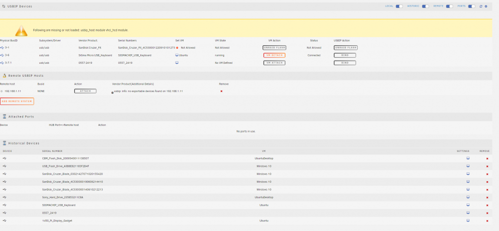

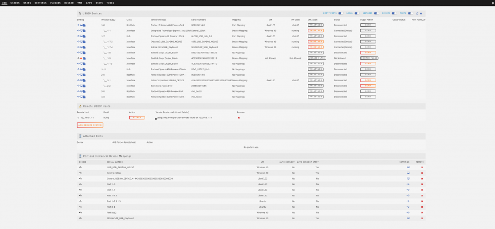

  • I have started to add support for mapping devices as a Serial connection to a VM. So you wont have to use the XML fix.   Function works for starting/stopping VM, hotplug removal but doesnt w
  • Option added in 2022.08.20
  • What output do you get if you hover over the virsh error?   The port number is only used if you enable connect as serial via the slider which is required for map Conbee II correctly above 6.
Can this eventually be used to attach server connected USB peripherals to VM's with no USB passthrough?
For example, instead of passing through multiple sets of keyboards and mice, or trying to get several usb chipsets passed through cleanly to multiple vm's, could you manage all the mice and keyboards on unraid and connect them using the client inside the vm?
You say the host module is not included, is this something you plan to add, or is it up to limetech?
Here is an example of connecting to a Raspberry Pi Zero W.

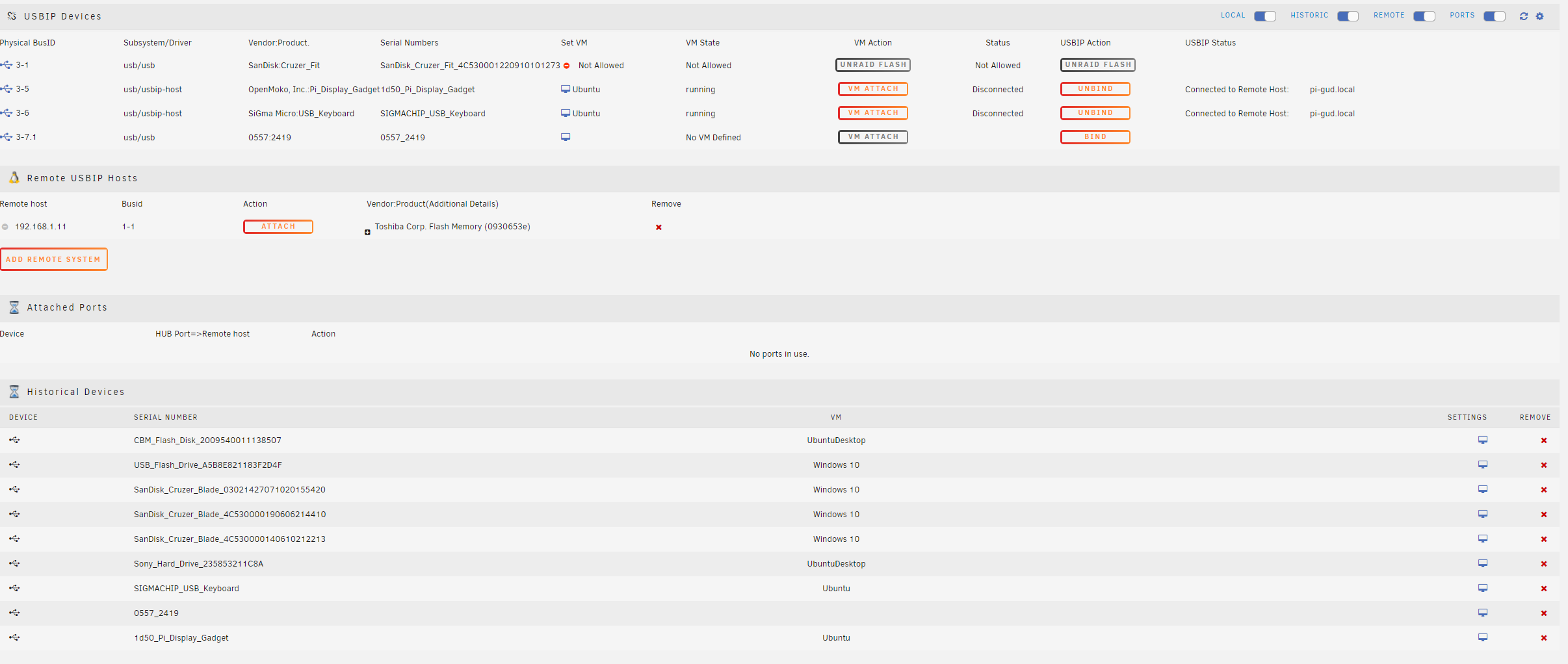

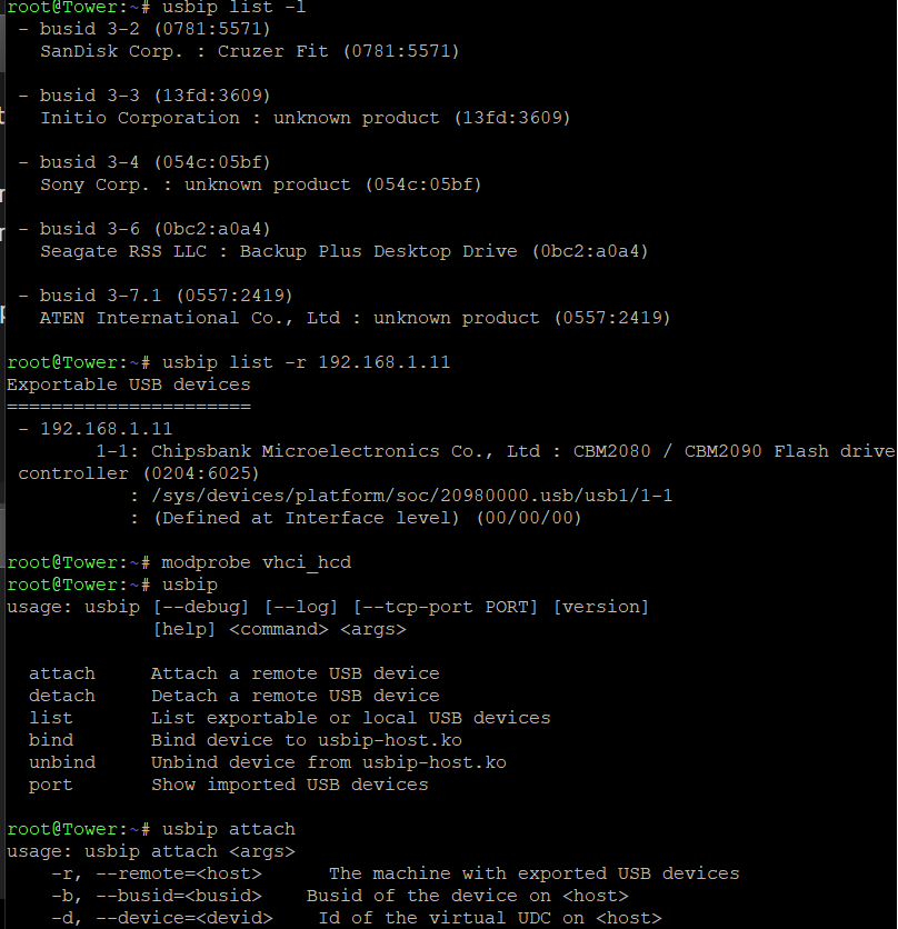

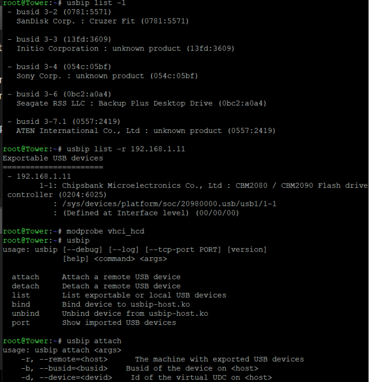

HI @GuilhermeFluis
USBIP can be used to share USB Devices between systems. On the client side they appear as if they are connected directly.
Note that USBIP is not a secure setup so should only be used in local networks.
Uses are for connecting usb dongles/keys to servers etc. i.e. if you have home automation then connecting a ZWave USB controller to Openhab or Home Assistant running in a docker or VM.
USBIP doesn't reconnect automatically if there are failures etc.
You could have a keyboard, mouse, usb flash drive and connected to a pi and shared with remote host if the remote host has client support. There is a windows client, but I have not tested it as yet. But use a test signed driver. https://github.com/barbalion/usbip-win-client
On the client side you need to install the usbip tools. eg on Raspberry pi 4
sudo apt-get install usbip

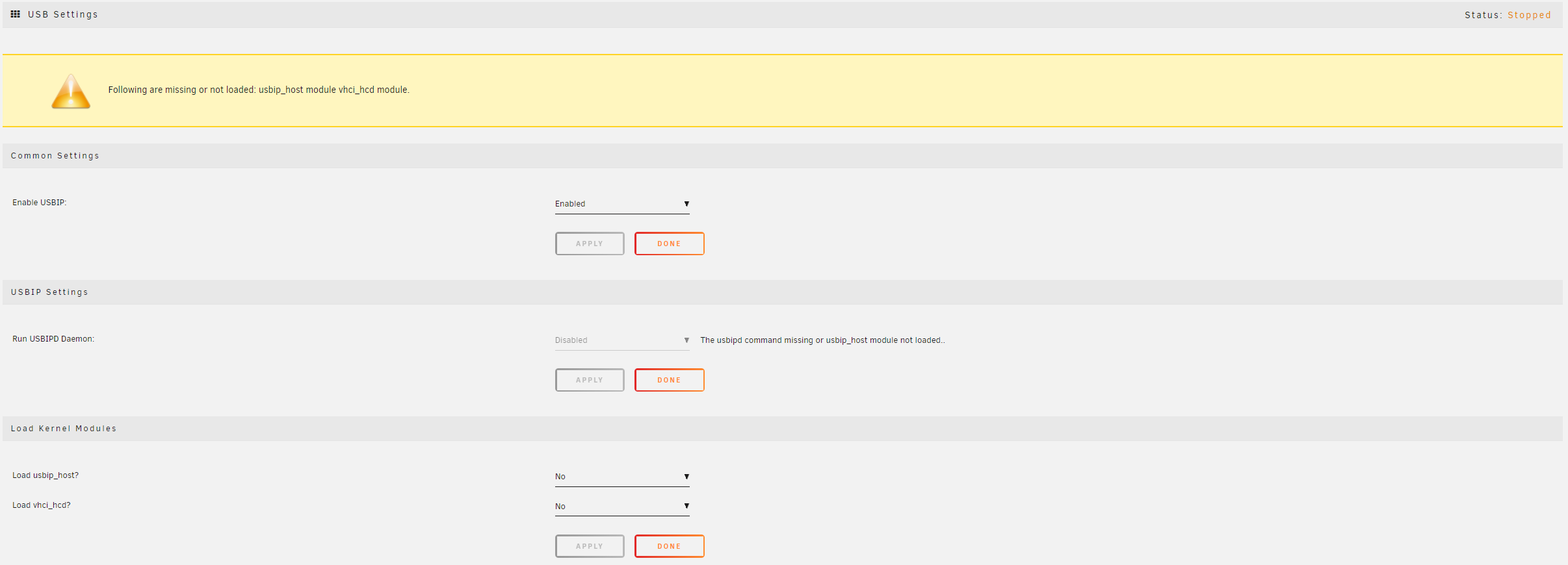

Depending on if you device is the client or the server different kernel modules are required.
Server: usbip-host
Client: vhci_hcd
If they are not installed modprobe the one you need. vhci_hcd loads two(USB2 and USB3) virtual USB hubs for devices to be connected to of the remote system
pi@pi-gud:~ $ sudo apt-get install usbip
Reading package lists... Done
Building dependency tree
Reading state information... Done
The following NEW packages will be installed:
  usbip
0 upgraded, 1 newly installed, 0 to remove and 0 not upgraded.
Need to get 683 kB of archives.
After this operation, 778 kB of additional disk space will be used.
Get:1 http://www.mirrorservice.org/sites/archive.raspbian.org/raspbian buster/main armhf usbip armhf 2.0+4.18.20-2+rpi1 [683 kB]
Fetched 683 kB in 1s (1,069 kB/s)
Selecting previously unselected package usbip.
(Reading database ... 39839 files and directories currently installed.)
Preparing to unpack .../usbip_2.0+4.18.20-2+rpi1_armhf.deb ...
Unpacking usbip (2.0+4.18.20-2+rpi1) ...
Setting up usbip (2.0+4.18.20-2+rpi1) ...
Processing triggers for man-db (2.8.5-2) ...
pi@pi-gud:~ $ sudo modprobe vhci_hcd
pi@pi-gud:~ $ lsmod | grep vhci_hcd
vhci_hcd               32768  0
usbip_core             20480  1 vhci_hcd

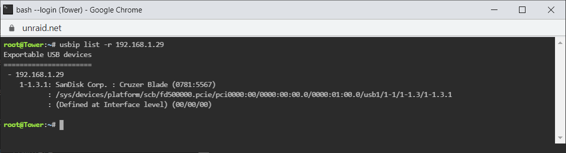

You query the remote server using  usbip list -r <ip> command.
On the server side you need to also have usbip-host module loaded and the usbipd running to service requests from the clients, which can be started with usbipd -D
You have to bind devices to the module for them to be visible on the client.
and on the client.
To attach the device to the client you need to run the usbip attach -r <remote ip> -b <remote busid> i.e. 1-1.3.1
Hope this helps provide a bit more of an overview?

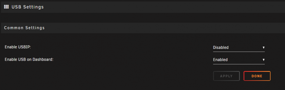

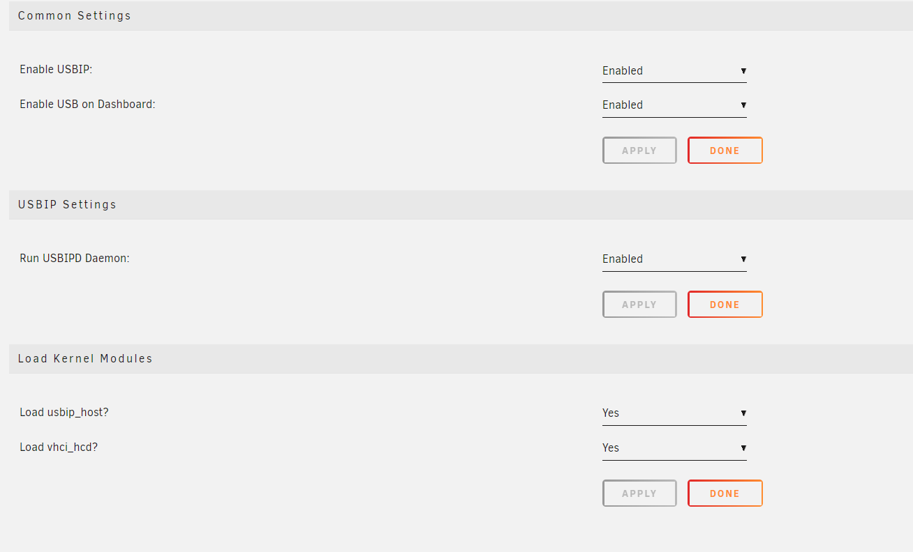

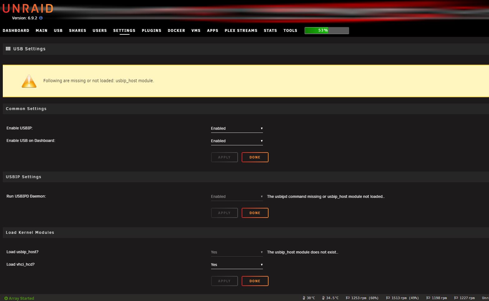

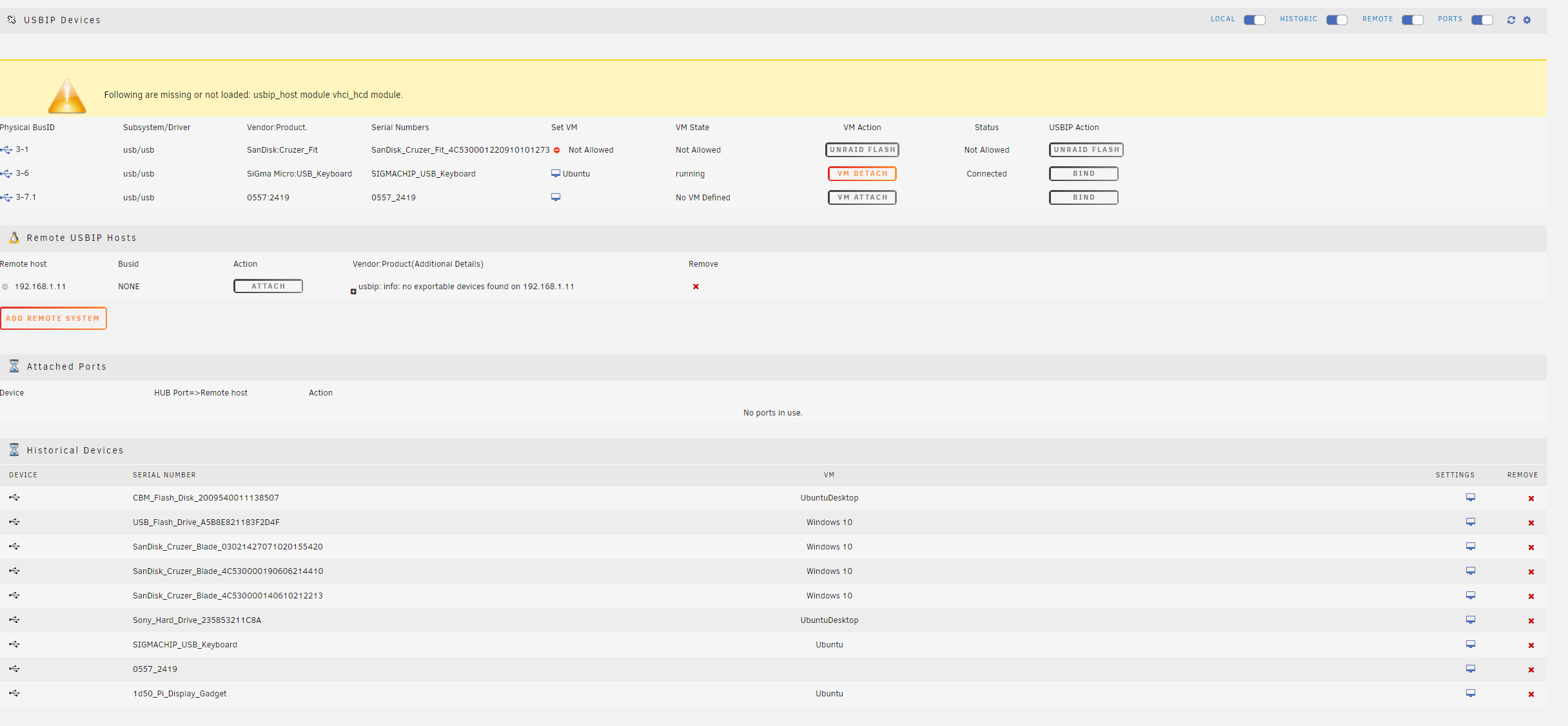

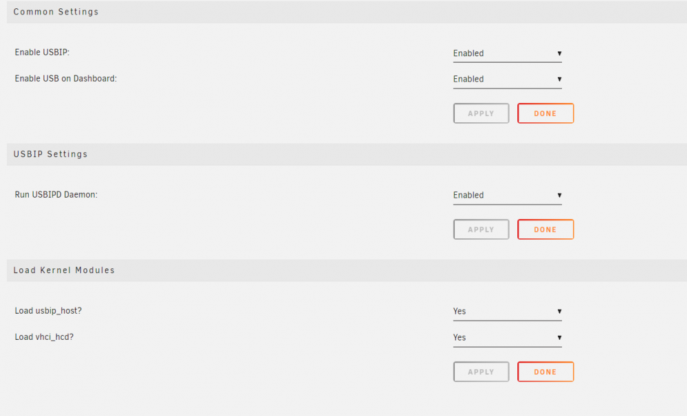

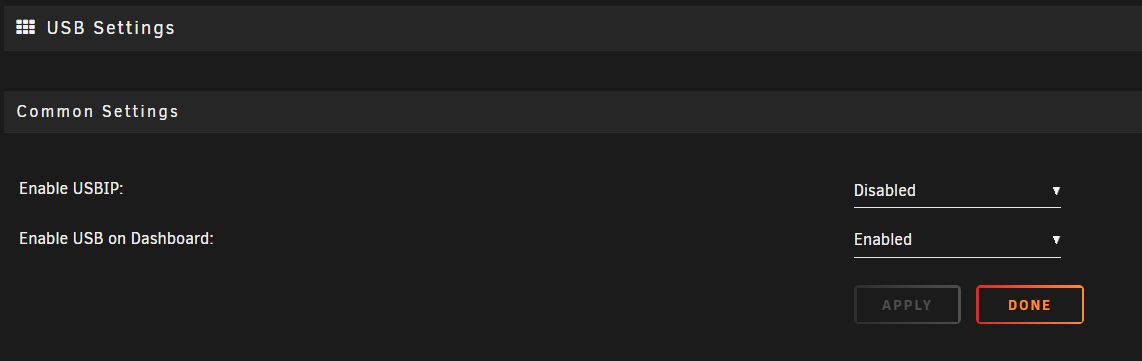

@SimonF Hi, I've installed the plugin successfully, however when I visit the setting page it's empty, just a white screen. How to fix?
Do you have the image.png.d63210ff17e48babd494eb1e1816ceb1.png or is it the page blank when you image.png.937959d1f651c05961119888cc357085.pnggo via this in the settings page?
What vers of OS are you on,
You will only see these two options on the settings page.
Main USB page is via the Menu at the top.

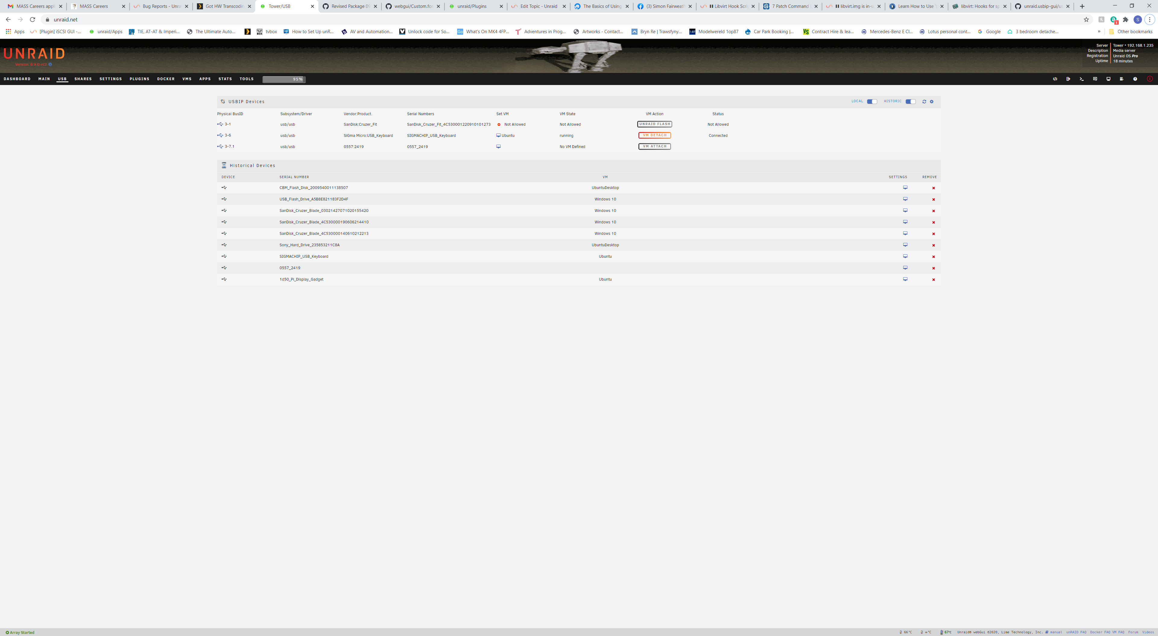

Are you able to provide me a screen print of the usb page pm me if you dont want to post it here
Edited by SimonF

Here's my screenshot btw:
- In my VM setting, the mouse is passed through: https://i.snipboard.io/IGghF4.jpg
- In USB Page, mouse is set to auto connect on VM start, not sure how to use the settings on there tho. Also, I see the virsh error there after waking up the VM - https://i.snipboard.io/fMhSYx.jpg

Since Unraid Version: 6.9.2.
I just get the messege: Following are missing or not loaded: usbip_host module.
Did there got something remove for usbip? With Version 6.9.1 everything worked -.-
Its working for me on 6.9.2.
Did you upgrade before the usbip package was built? Have you tired uninstalling and re-installing?
What does your settings look like?
Edited by SimonF
I attached my settings there are like yours but with the error as mentioned. I already uninstalled both plugins and reinstalled them. But I still see this "error/warning".
Looks like the additional USBIP package hasn't been installed. The vhcd are included in stock unraid.
You should be able to remove plugin and reinstall to fix.
