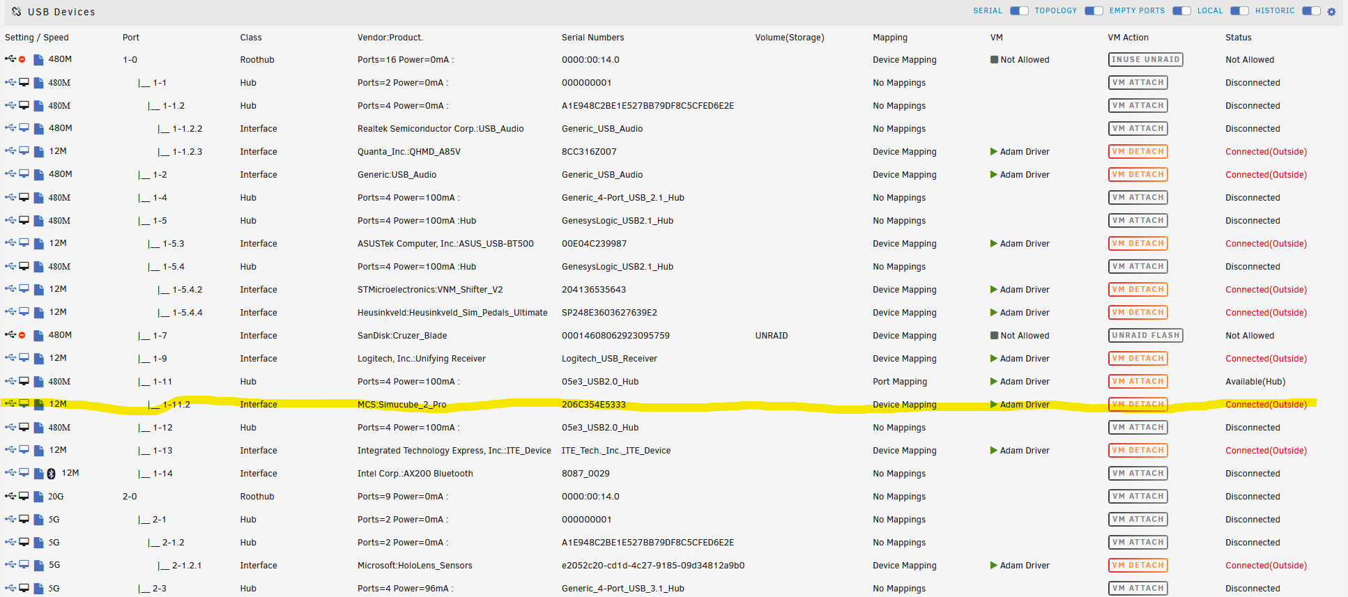

  2. I borrowed a PCI USB card from a friend to try that, Unraid see's it as an extension of the USB network. I cannot seem to pass through the entirety of the PCI card, just the Hub 3-1. Still doesn't seem to work with or without the auto-connect options.

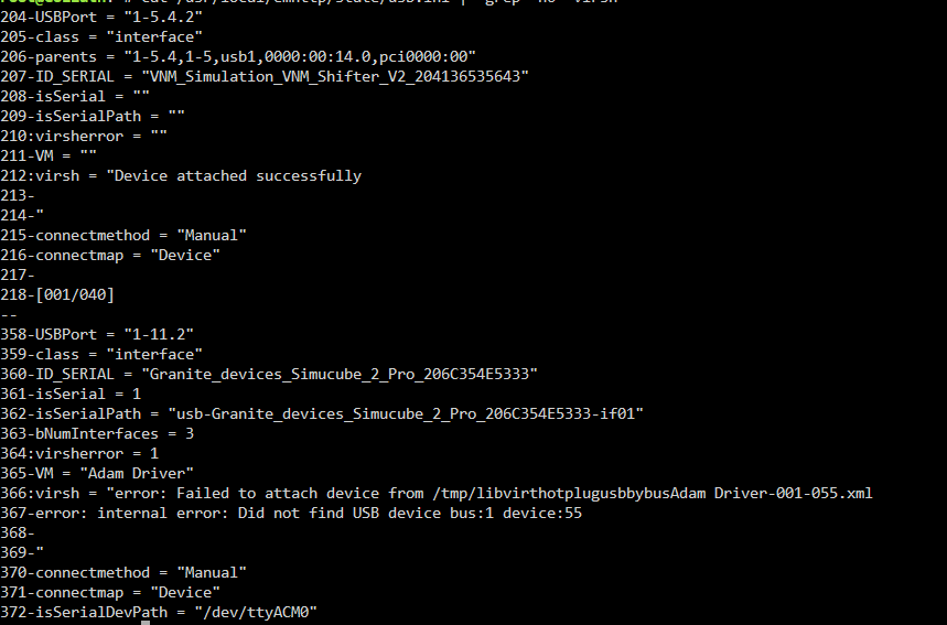

  4. I created and ran the file as instructed, and get this error. The device is still listed as device 55 and that's what it is written as in the script, so I'm not sure where the 45 comes from. Although the UI no longer says Virsh error when I attach the device.
  5. Adding in the serial connection option did not get it working. I do not have any USB PCI cards. I am basically passing every USB device through I can, so I am happy to pass all my devices through on the hubs.

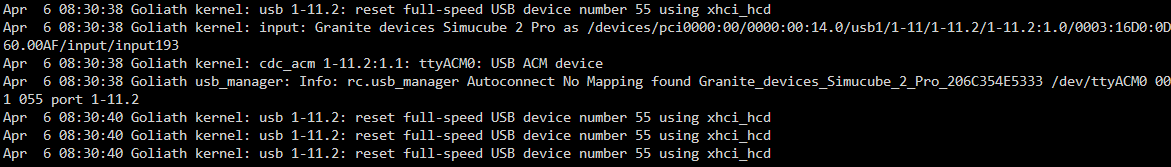

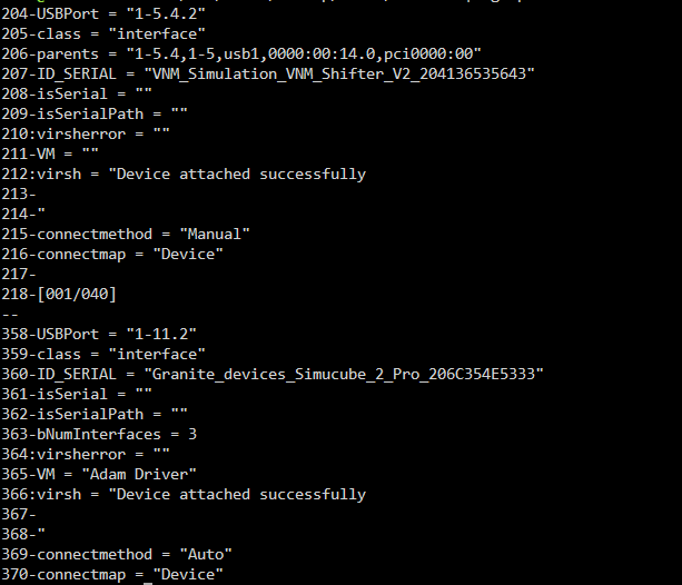

  10. By enabled serial in the mapping do you mean the "Connect as serial only" option? If that is the case then no. I do have the pass through selected as part of the VM settings, I set it up like that initially but had the issues and installed the plugin to try and troubleshoot. Here is the output of the command

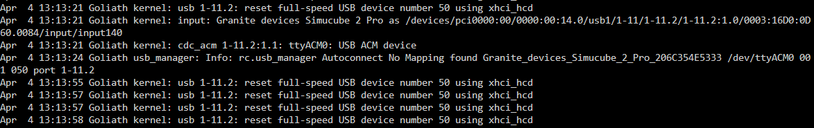

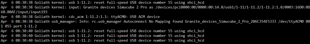

  11. Hello, I'm having issues passing through one specific USB device to my windows VM. The device will not show up in the windows device manager. When i start the VM it says its connected, but the log says "no mapping found". If I detach and re-attach it I get a Virsh error, which I'm not sure what that means or what might cause it. I have the device and the 1-11 port already set up to auto connect on plugin and VM startup. All other devices seem to be working fine except this one. Any ideas what might be the issue?
