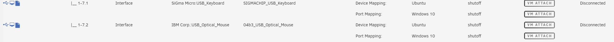

I wasn't able to do a screen grab earlier of an example
Here is an example of a Ubuntu and Window 10 machines.
Edited by SimonF
Thanks @SimonF - really happy with this plug in... well done.

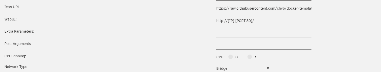

Hi
I am only a basic docker users, but can you not add that in the extra parms section in the template? I am guessing you have --device=/dev/ttyUSB0 in there already?
I am looking at adding the auto attach options and thinking on how to link to specific devices, would you be willing to share the info below? also the scripts you have created so I can see the process you are using. PM me the info if you don't want to post here.

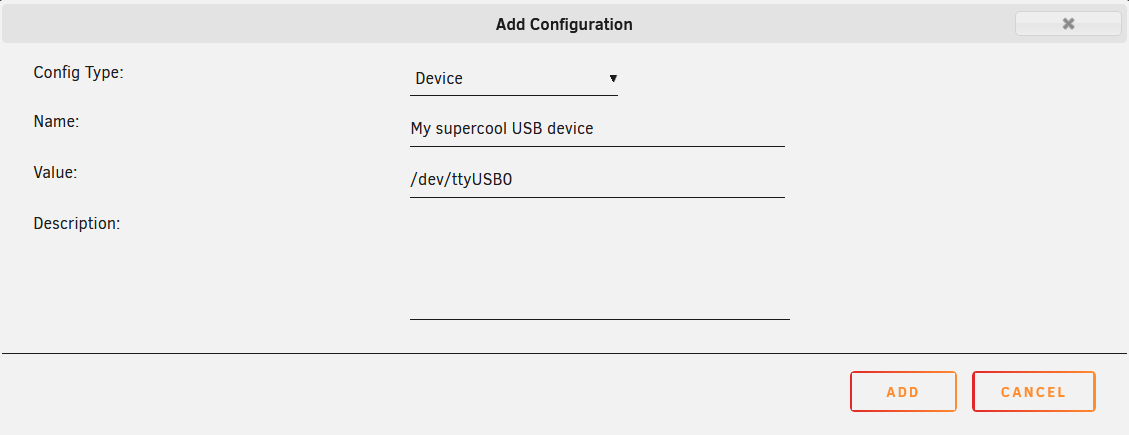

@batesman73 just a suggestion from my side, actually because it's a little more convenient I think, do it like this if you want to add a device to a contianer:
  1. In the Docker template click on: grafik.png.e5e4d62826ff85515dd016058154455f.png
  2. Change the "Config Type" to: "Device"
  3. (Optional) give it a Name
  4. As value use the device path: "/dev/ttyUSB0"
  5. Click on "Add"
  6. Click on "Apply"
  7. Enjoy
I have learnt something new today, didn't know that option existed. Thanks.
