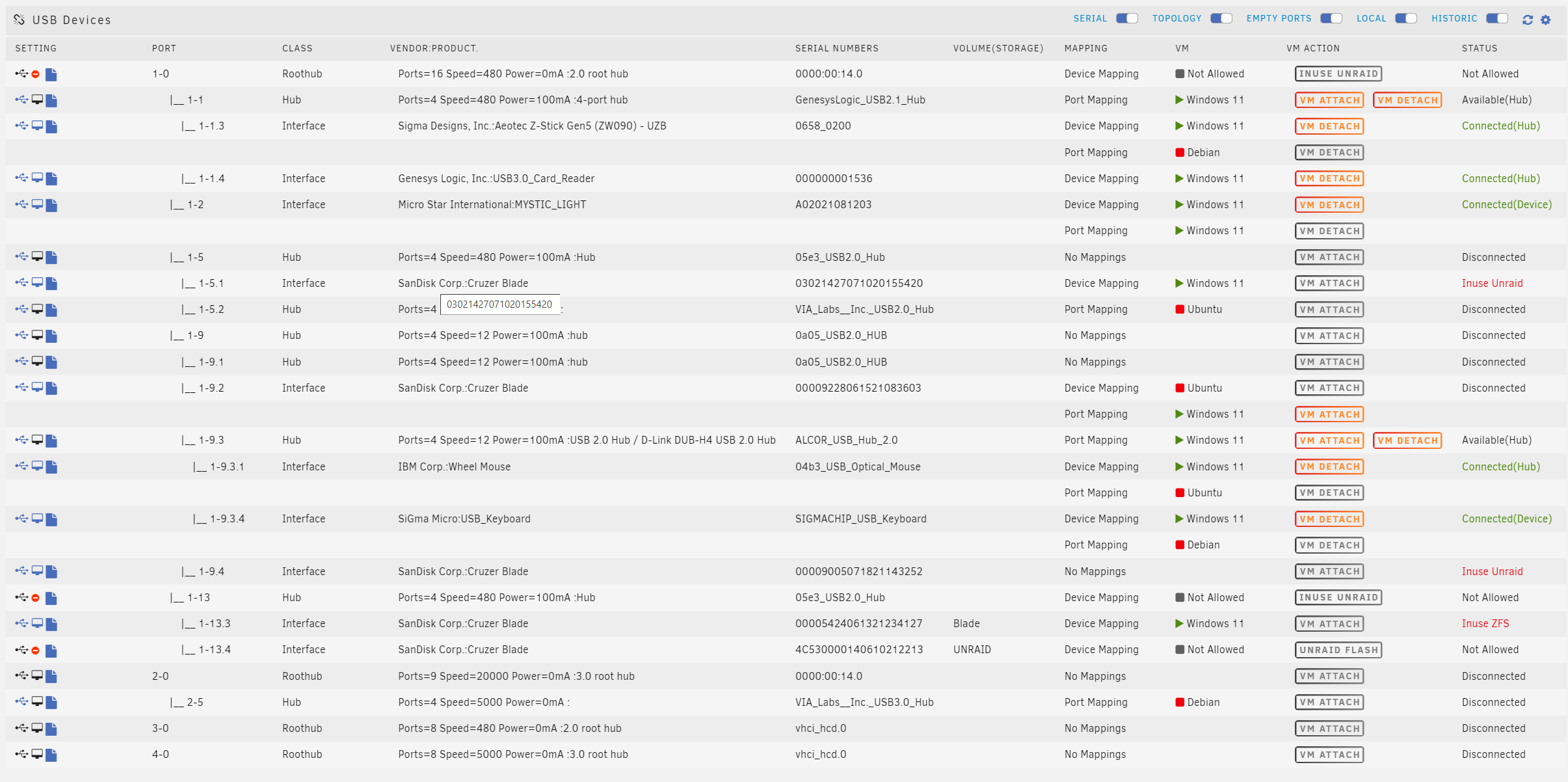

21 minutes ago, CIA said:
Noticed Status: Stopped with
Yes that is for the USBIP Daemon that is only valid if USBIP is enabled. I am going to remove that and put the status against the config item.

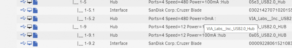

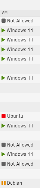

8 hours ago, CIA said:
I'd like to see "VM STATE" intagrated with the "VM" column in the same way or some small visual / icon instead of the text, and then maybe the "STATUS" column with the small visual / icon too.
Is this what you are thinking.

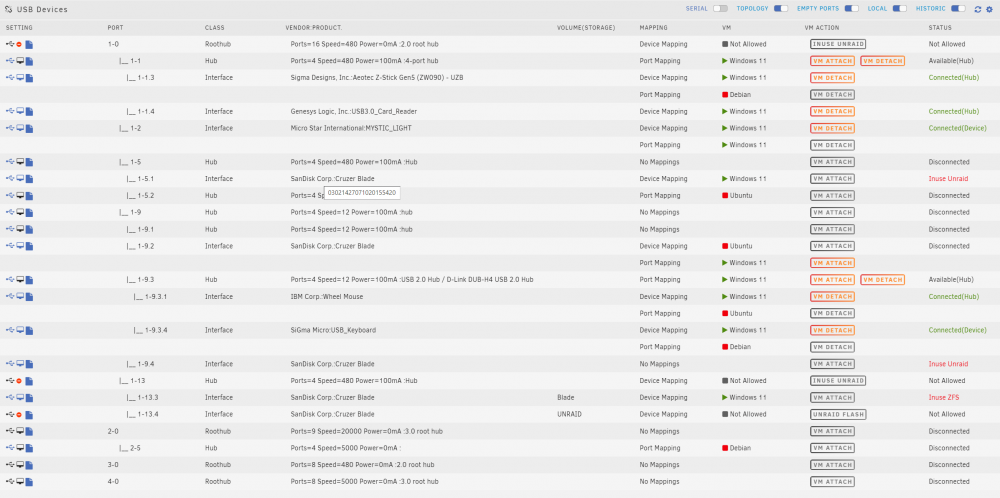

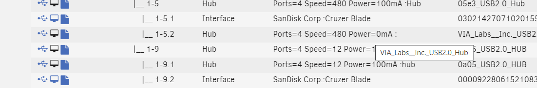

Would people prefer hover over text for Serial numbers or a toggle to hide serial number. Hover example.
What about just having a small info logo linked to a small popup that could contain whatever relevant information. Something like this-
Current View
Revised View with Serial slider and hover over.
And with Serial Slider set to hide serial.

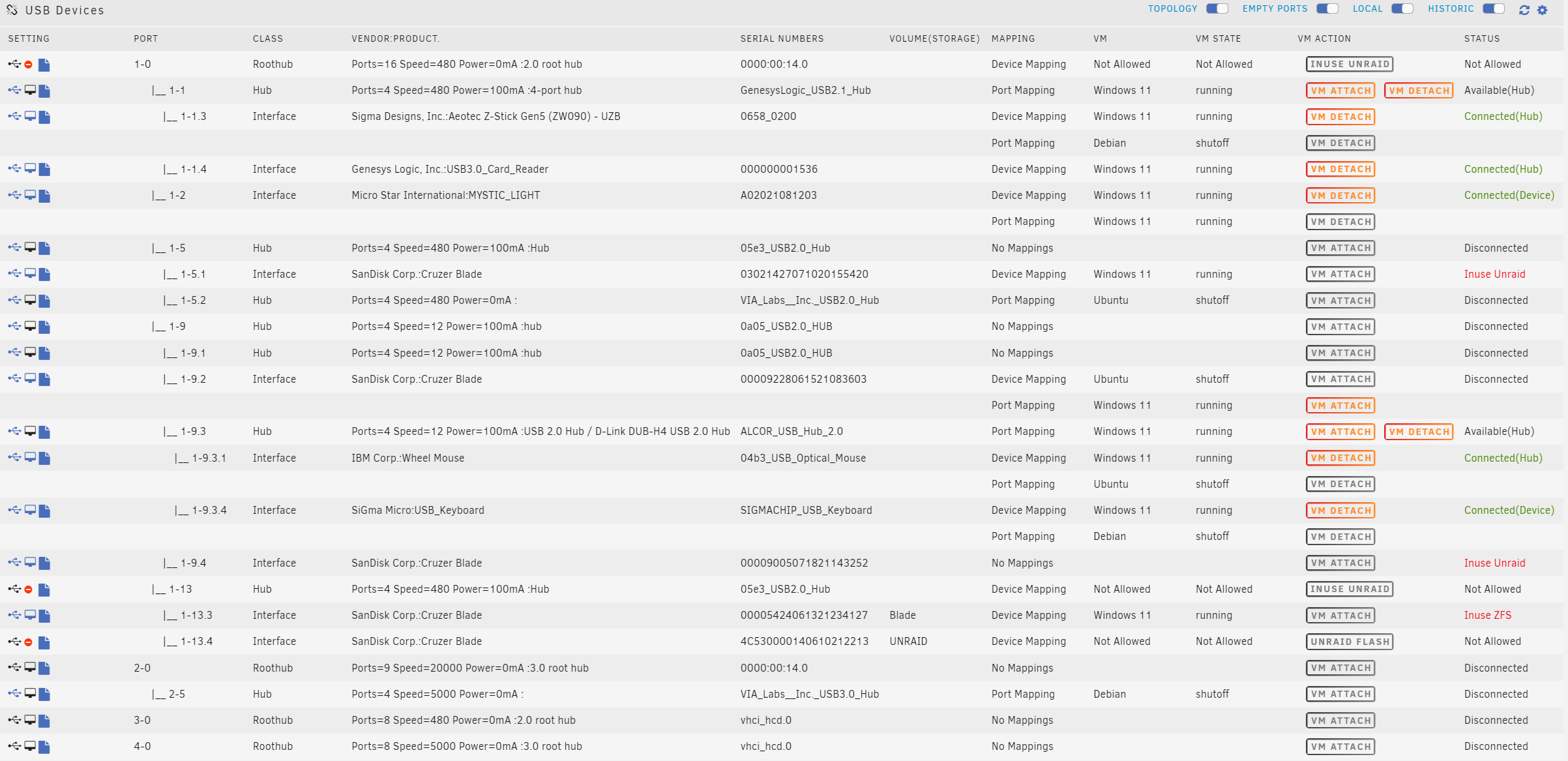

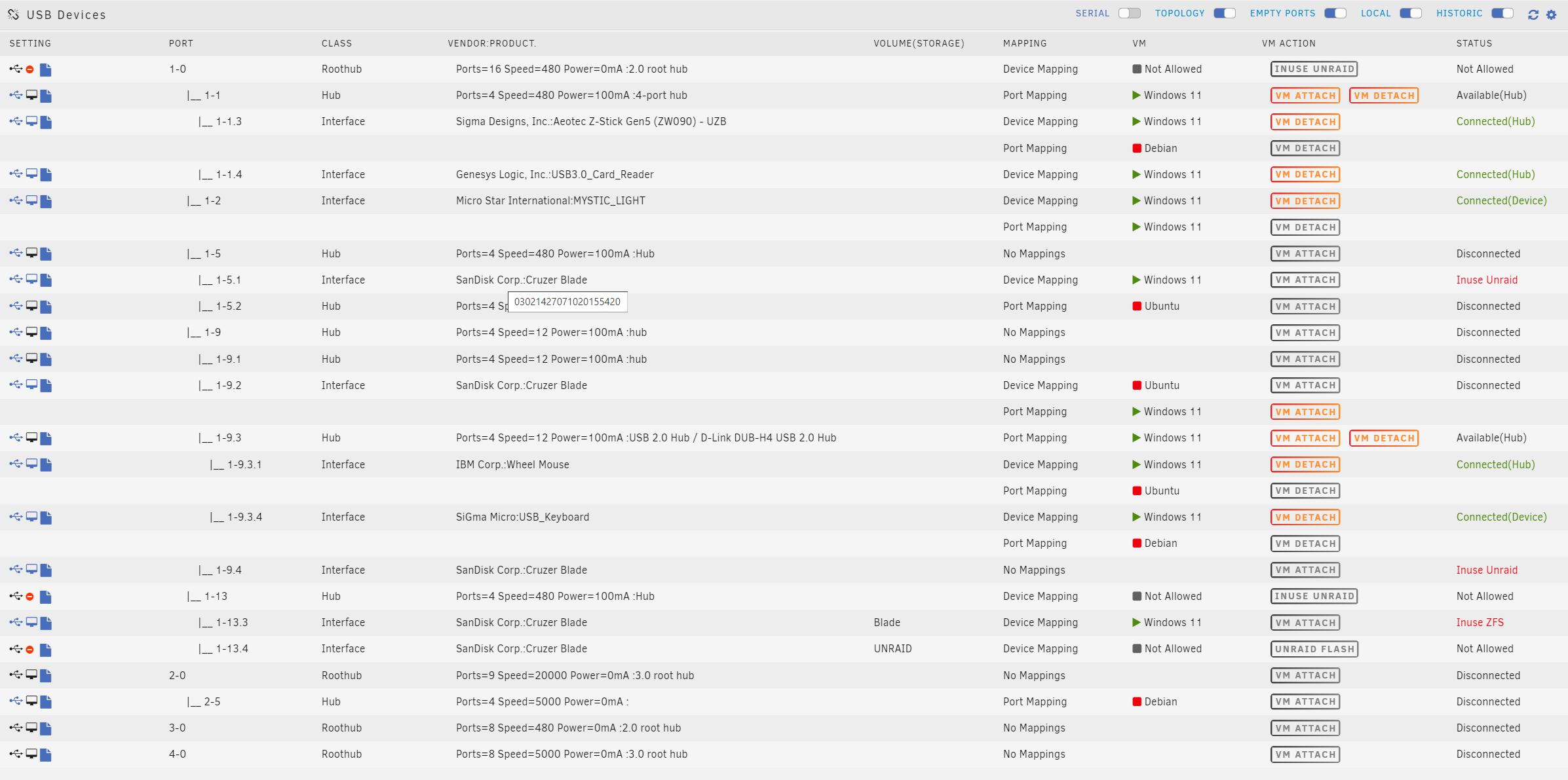

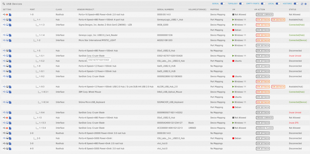

Yup, That's a lot cleaner.
Didn't know you were going to do both, My vote is "toggle" as this will show all for quick reference and the hide for screenshots as I know people like to sratch out the info when helping people.

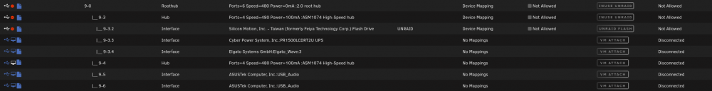

@CIA
Can you advise on the hardware changes you were making. If a usb device is change it will update the plugin.
State file is /usr/local/emhttp/state/usb.ini.

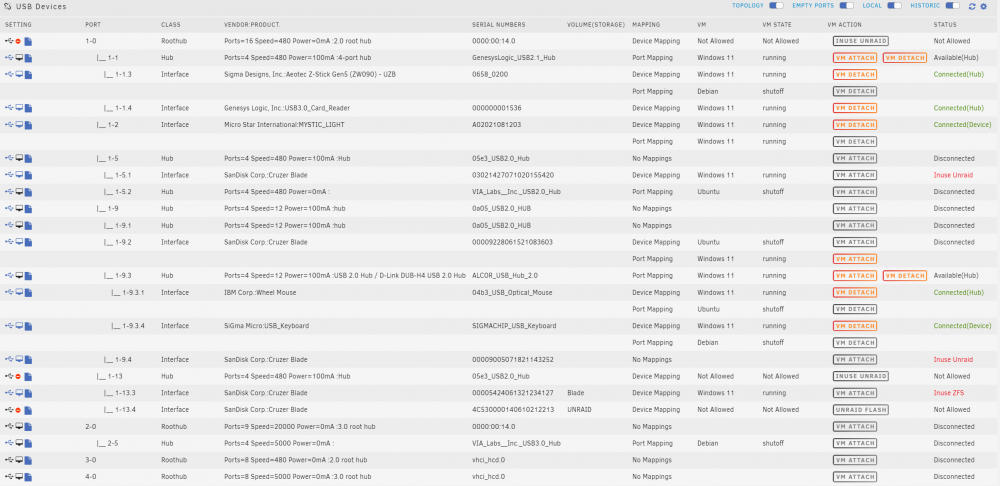

I meant port... The port the device is attached to...
This device only passes through while the port is passed... and not with the device method...
In the image I set both cause I was unsure if it was the issue, and I needed it.
And as stated, I deleted the folders, cause it was the only way I knew to get VM back up and running /w the USB Manager again.

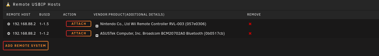

not sure if its because of resent updates on the RC branch but the clicking the "Attach" button does nothing. it sees my server, and my devices, but clicking attach does nothing.
Thanks for reporting I will look into it. Was working fine on Internal rc3 releases.
i'm on rc3....  i uploaded my diagnostics just in case. i'm not sure whats going on. i thought it might of been dynamix plugin of some kind. i recently installed his file manager and wasn't sure if something with the gui messed up... i've used your usb plugin before. i was trying out virtualhere so i removed all the usb stuff. now i've readded. is there anything else i can send over that could help? it could just be my server setup? i followed the wiki. i added them to usbip-bind@hardware:id.service instead of 1-1.2 this time. not sure if thats the issue. i can see them just clicking attach nothing happens.

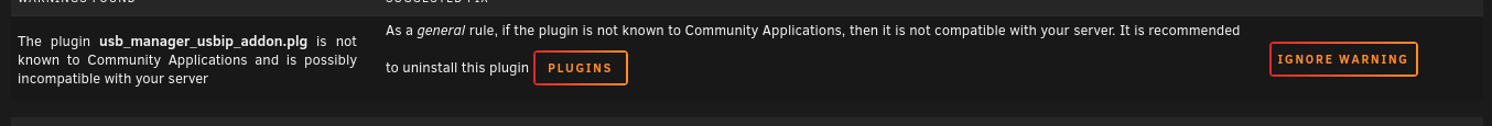

20 minutes ago, letrain said:
just saw fix common problems plugin is throwing an error at me.
Thats fine as it is not in CA.
56 minutes ago, letrain said:
i'm on rc3
Install 2022.03.13 for fix.
nice. thank you for all your efforts. i really do think usb-ip is underrated.
