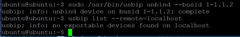

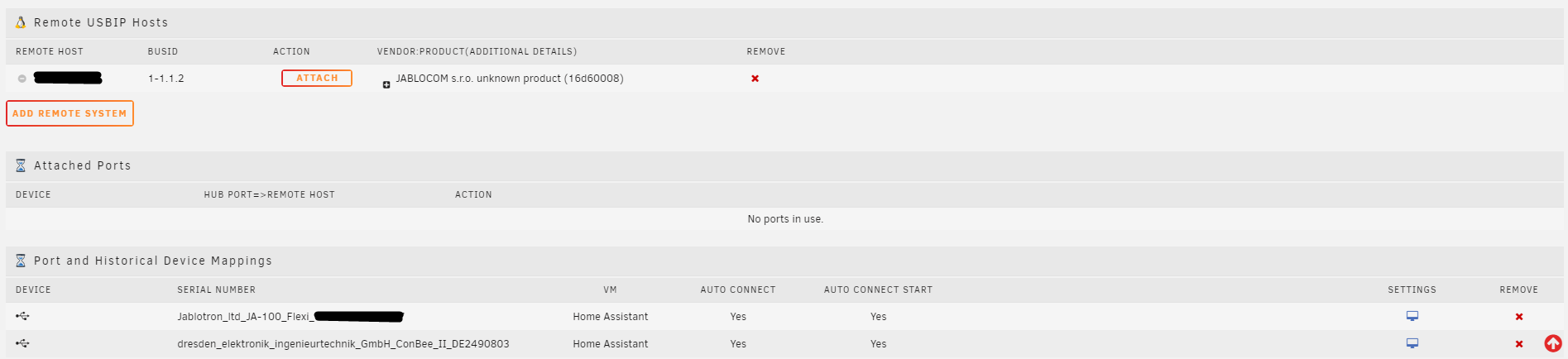

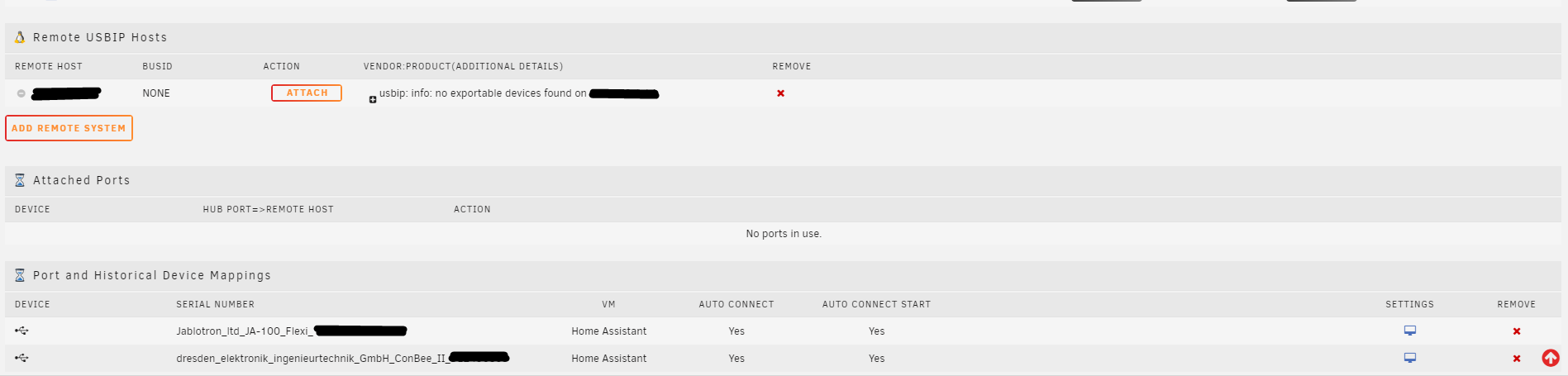

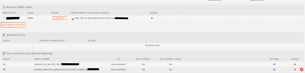

first of all thank you for the great plugin. The thing that I'm trying to accomplish is regarding usbip, so my usb device is on the remote system.
When there is no binded device on remote raspberry pi
I see this in Unraid USB plugin.

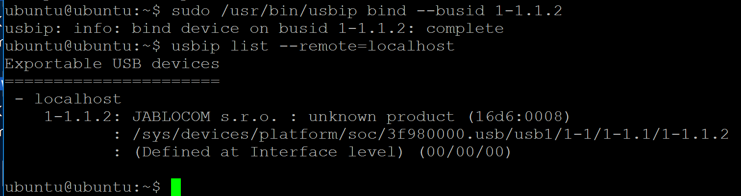

When I bind the device
then in USB plugin I see the usb device and I can manually attach it.

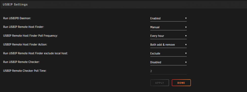

The thing is that I would like for this device to be attached automatically whenever it is discovered. Is there some setting that I'm missing?

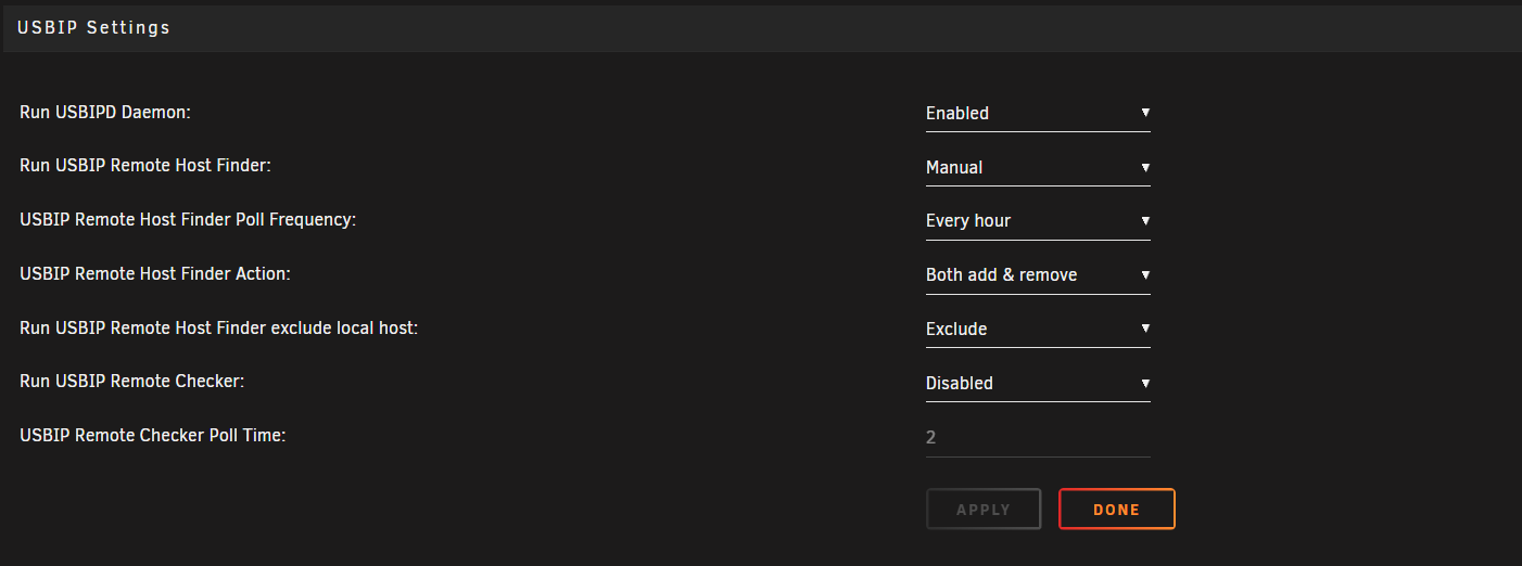

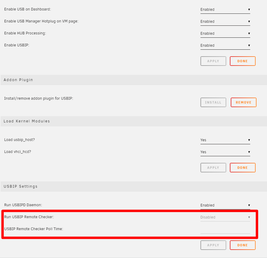

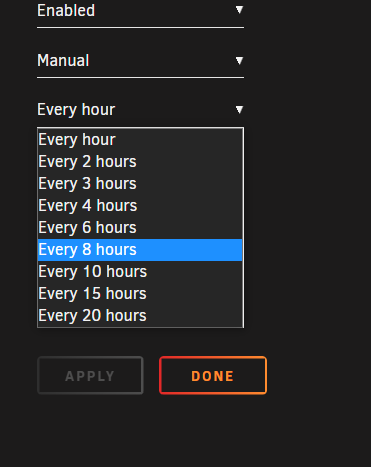

I have also found this in the settings.
Is this somehow related to the functionality that I'm trying to accomplish or what is the purpose of USBIP remote Checker?
Also I'm not able to make it enabled whatever settings I apply it is always grayed out.
Thank you very much for your help.

Hi
I think you may be using the beta vers, Its something I have started thinking of adding, but I forgot to hide the values when I released the beta version to handle the change in state processing.
It may appear in the future but currently no time frame.

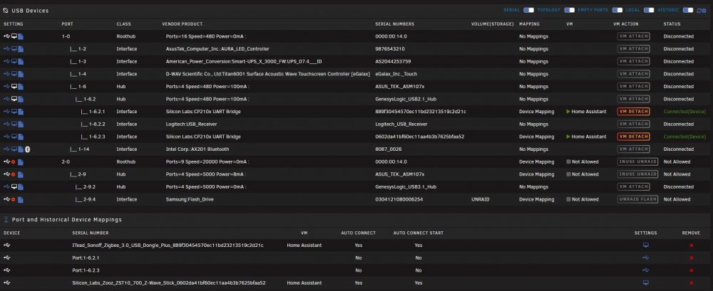

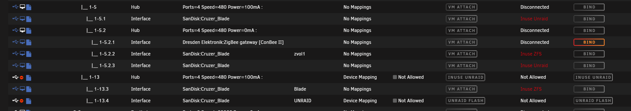

I have a Home Assistant VM that has a zwave device (zooz 700 stick) and a Zigbee device (sonoff zigbee plus). Both devices have the same info and show up as "silicon labs cp210x uart bridge (10c4:ea60). I can pass one through without issue, but if both are connected both get selected to pass through and I get an error stating that I can't pass duplicate devices through. Would this plugin "fix" this for me? I'm relatively new to unraid and certainly new to VMs, so take it easy on me. What settings would I ideally use if this is a viable solution? Thank you.
From my experience with this plugin, even if you don't use it for USB/IP it can act as an extension of unassigned devices (UD) plugin where you can hotplug (attach/detach) USB devices on running VMs, yet UD has limitation where it cannot handle devices with the same name.
However, this plugin distinguishes the devices by their bus/id allocation and can hotplug them even when they share the same name or manufacturer info.
If I'm mistaken I hope someone can correct me since I don't have an Unraid machine nearby to back up my claims, but I'm fairly confident it will solve your problem at least when it comes to hotplugging the devices (attaching them to VM after it started).
Yes it will allow that and was one of the reason for creating the plugin as  VM Manager uses the vendor and product to add to a VM where I use bus and dev to do the mapping. Do they show the same serial number?
You can attach using the USB port or by the device.

@SimonF Thank you very much for the reply. I haven't installed your plugin yet, but intend to do that. Will the devices just show up like your second picture and I just click "vm attach" or "bind" in order for them to show up in the HA VM? attached are a picture of my usb devices. Thank you for your help, and for the awesome plugin.

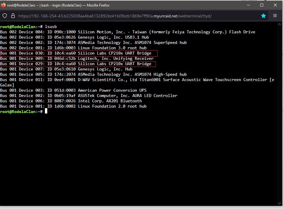

Does
lsusb -vs 001:030 | grep Serial
lsusb -vs 001:029 | grep Serial
provide different serial numbers, no need to share just confirm if that is the case or not.

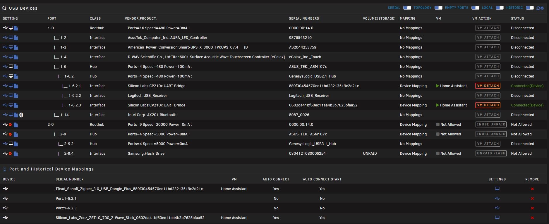

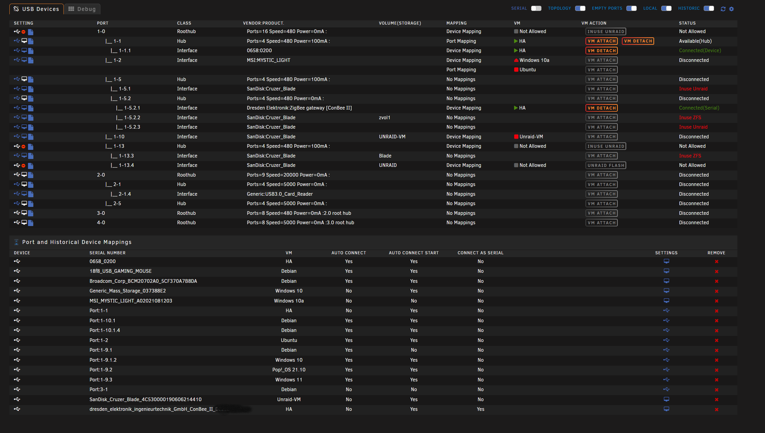

You may need to use the Beta vers so it shows the connection as the stable version was using serial number as the key for state. Also you will have to map by port as device uses the serial number to ID the device.

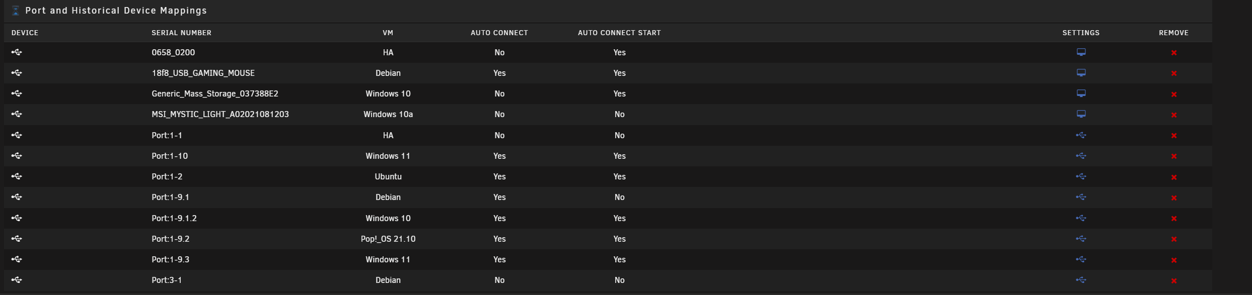

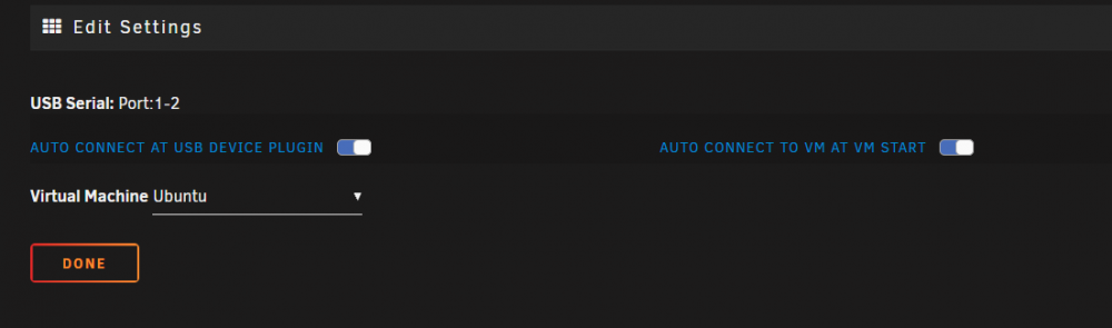

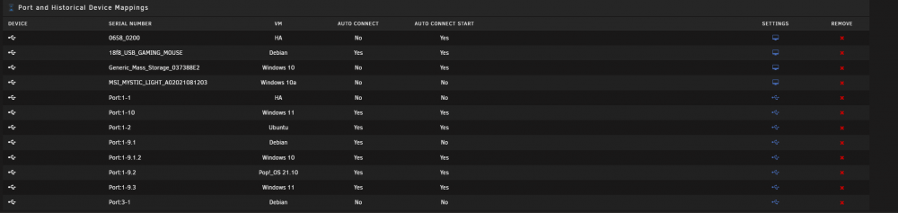

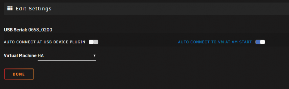

with each entry you can specify if the device is connected automatically when you plug in or start vms etc.
You should remove any mappings for the usb device in VM Manager or you can just click attach if you want a manual method.
You do not need USBIP function so BIND will not show unless you enable USBIP.
Example Mappings.
image.thumb.png.8799aa408a1d9cd0c44f7f0e0f11ca1e.pngimage.thumb.png.4fd3651e02c90686fa8fbc83f10acccf.png
@SimonFI have confirmed that both devices are showing different serial numbers.
@SimonF I installed the plugin, and then on the usb tab, I have changed the device mapping to "auto connect at usb device pluging" and also "auto connect to vm at vm start" and selected HA as my VM. However, when I start the HA VM, the devices don't appear to connect automatically uniess I manually click "VM attach". Am I doing something wrong?  If I click VM attach, then they show conntected and everythign appears to work as expected (which is awesome by the way). I just don't understand why they aren't connecting automatically when the VM starts?

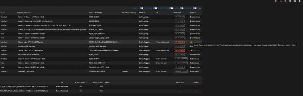

Thank you again @SimonF. I guess I'm about to display my ignorance here. I can navigate to my qemu file via terminal; however, i  don't know how to view it. I should possibly also mention that in my /etc directory, I have a /libvert and a /libvert- directory. Both seem to have "hooks" within them. Not sure if that matters. I am on the beta version of the plugin, and also on unraid 6.10.0. Below is the picture that you requested as well as my usb devices (hopefully there isn't anythign in there I should have greyed out). In any case, thank you for the help.

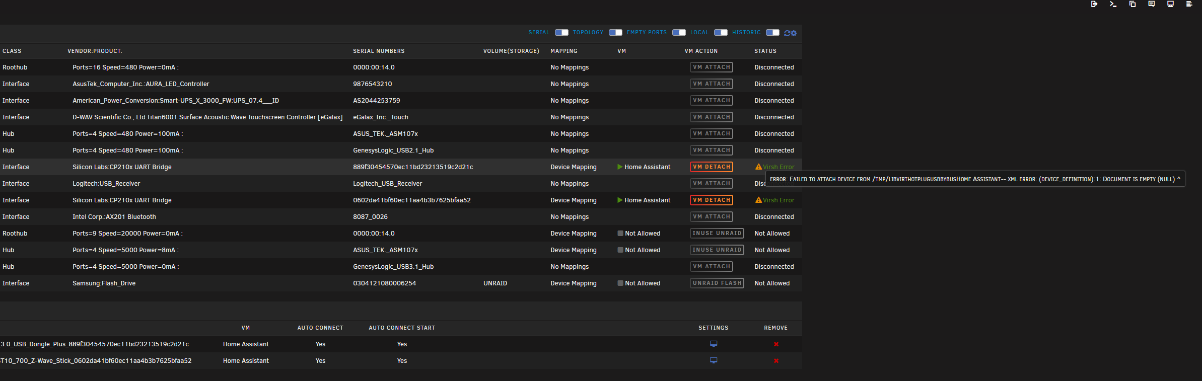

@SimonF Thank you again. I uninstalled the beta version and installed the stable version. Entering the data above in terminal did yield the same results as you indicated above. When I start the VM, now the devices connect, but I'm getting a virt error now (on both devices). I have to hover to get the exact error so it's sort of hard to see, but please see the error. any suggestions or fixing it?
Sorry I forgot to get you to remove the state file. This will rename it.
Remove the plugin, run this command mv  /usr/local/emhttp/state/usb.ini /usr/local/emhttp/state/usbold.ini and then reload the plugin from CA.
Edited by SimonF
@SimonF You are the best man! Thank you very much. That worked and has me back in business. I can't tell you how long I searched for a solution to this. Thank you!

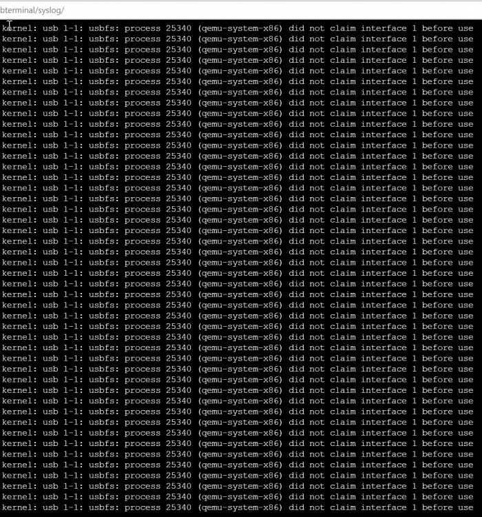

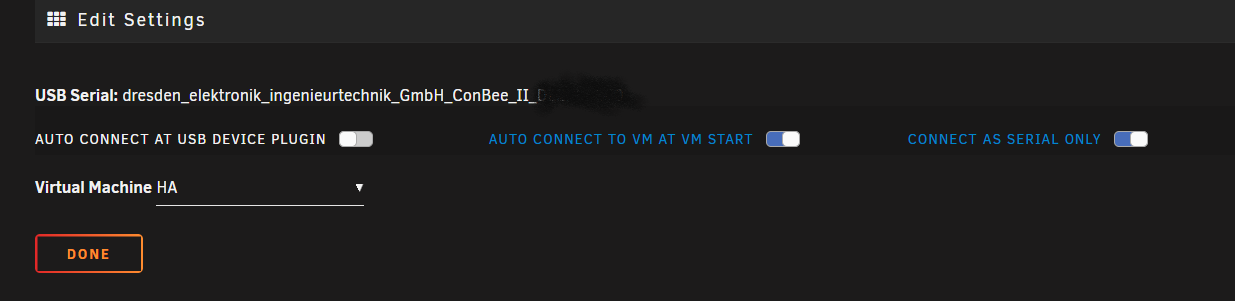

On 4/13/2022 at 1:52 PM, casperse said:
Hi Again
UPDATE: This seem to be a problem in the way Unraid detects the Conbee2 stick USB in 6.10 releases
This would be really cool if the "USB Manager" could fix this?
If the USB manager could resolve the Conbee serial ID and create the correct device path?
OLD POST

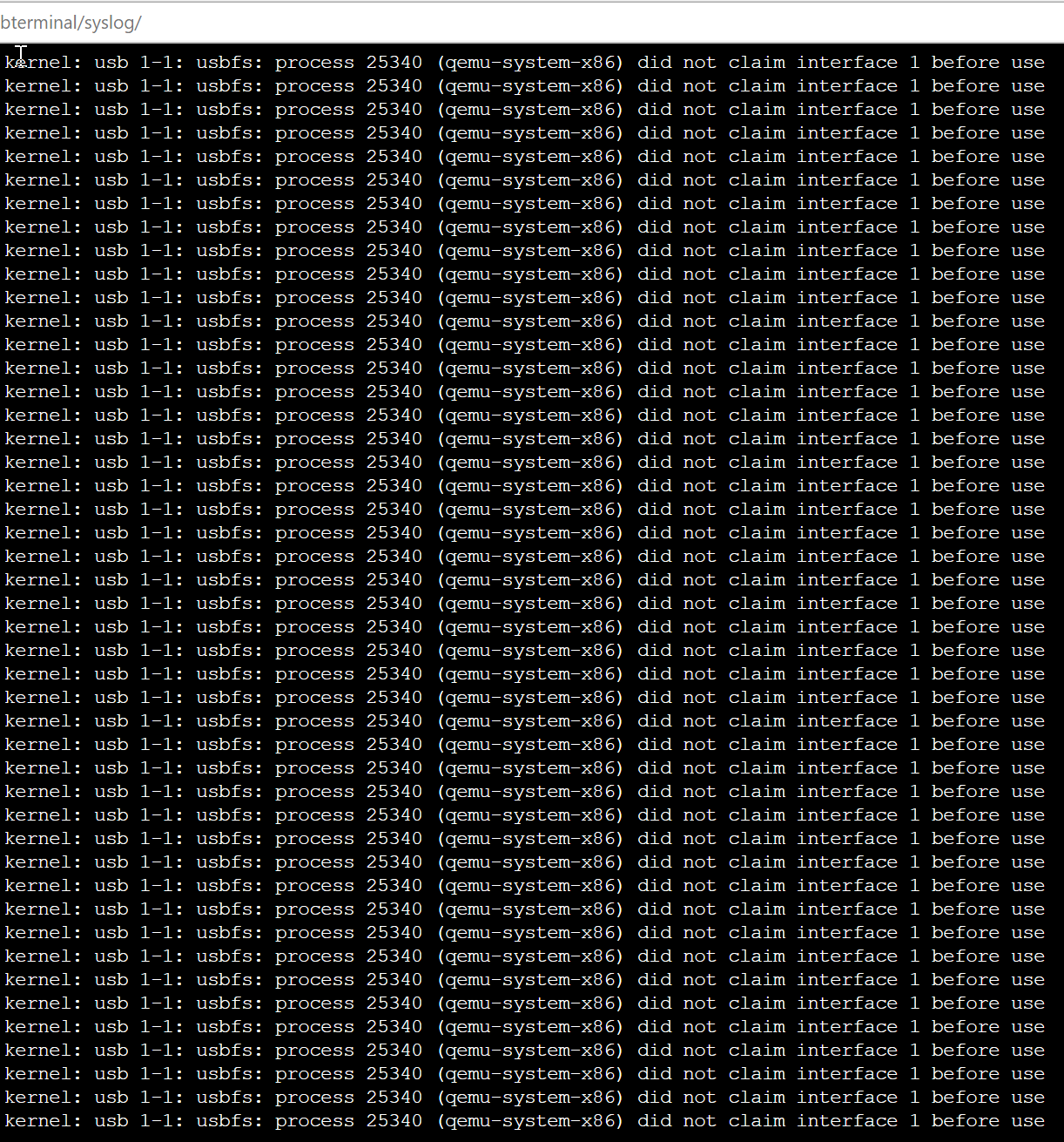

I just upgraded from 6.9.2 -> 6.10.RC4
And I only using this plugin to passthrough USB to my HAssio VM but it seems it dosent work in 6.10.RC4?
But the error I have after reboot is this:
kernel: usb 1-1: usbfs: process 17779 (qemu-system-x86) did not claim interface 1 before use
Its filling up and have been running since my reboot
Again thanks for this great plugin! Thinking about rooling back it work 100% in 6.9.2

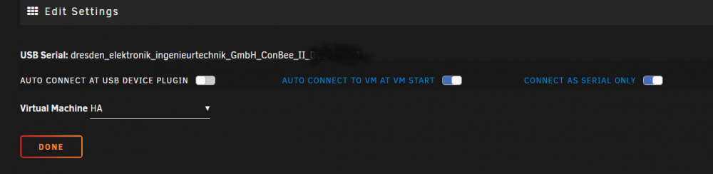

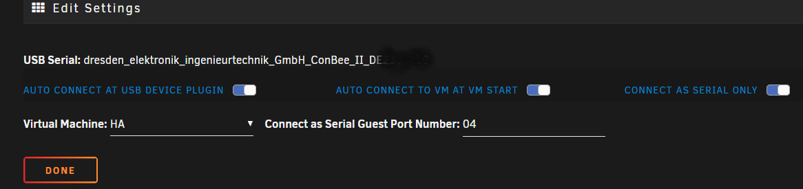

I have started to add support for mapping devices as a Serial connection to a VM. So you wont have to use the XML fix.
Function works for starting/stopping VM, hotplug removal but doesnt work for hotplug add at this point due to the way i need to get the by-id name.
I am using the following for testing for the XML. Will look to make the USB port configurable.
	$usbstr .= "<serial type='dev'>
	<source path='${isSerialPath}'/>
	<target type='usb-serial' port='1'>
	<model name='usb-serial'/>
	</target>
	<alias name='ua-serial${usbbus}${usbdev}'/>
	<address type='usb' bus='0' port='04'/>
	</serial>" ;
<serial type='dev'>
<source path='/dev/serial/by-id/usb-dresden_elektronik_ingenieurtechnik_GmbH_ConBee_II_DEXX-if00'/>
</target>
<alias name='ua-serial001026'/>
</serial>

Verison 2022.07.13a is now available with Serial support.
Edited by SimonF
Version 2022.07.17 released.
Support for hot plugging devices needing to use serial attach method and user definable Guest USB port.

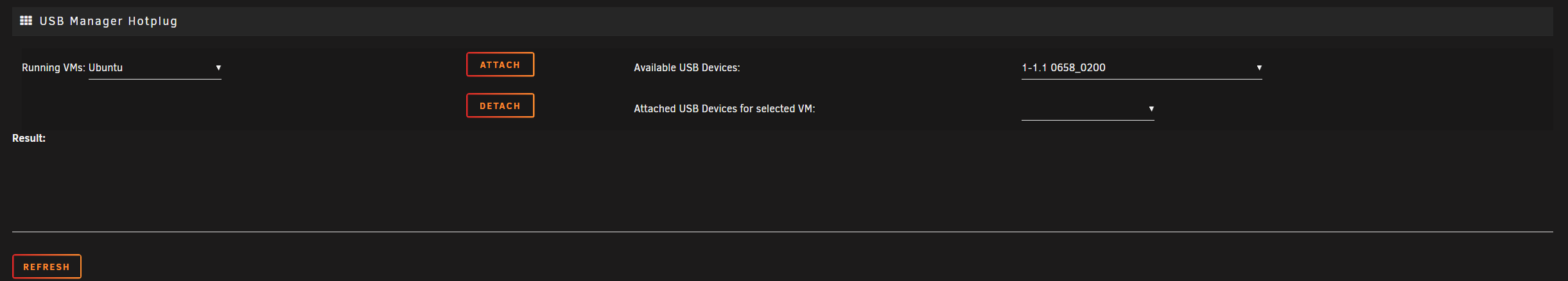

Version 2022.07.18a released.
Reworked the USB Manager VM Hotplug page to only show available devices for Attach, and shows only devices attached to the selected VM for detach.
Edited by SimonF
+1 for this.
It would be great if USB Manager could mount remote USBIP devices automatically if they are discovered.
I have a couple of them set to attach automatically to the VM when they are available, but if I restart the remote host that has the USB devices plugged in, I have to manually attach them so that they then attach to the local VM.
Amazing plugin btw. Keep up the good work..
Edited by muzo178
8 hours ago, muzo178 said:
+1 for this.
Will look in to it.
@muzo178 @Scarat
Started thinking about this. And looking to add two parts. One to detect USBIP hosts automatically and add them into the remote users list. Options to set as Manual i.e. no action or Auto. Auto would then use the frequency an action to add, remove or both, option to exclude the local host if running USBIP. Looking at this being able to run on the following
Second part will be to check if that host is on and attach devices how would you like that to work, any options when connecting etc?
Sample options below.
Release 2022.07.23
I have add the to processes to detect new hosts and check if the host is available and attach the devices. Please test @muzo178 & @Scarat and let me know if that meets your use case or you want additional function let me know.
2022.07.23
Add USBIP host finder and checker options and processing. Checker will attach a USBIP device found not connected to host already. Finder will look for devices in the local subnet using port 3240 and depending on options add or remove the host from the remote USBIP hosts, removal is for a host no longer found.
On 7/23/2022 at 3:11 PM, SimonF said:
Release 2022.07.23
2022.07.23
