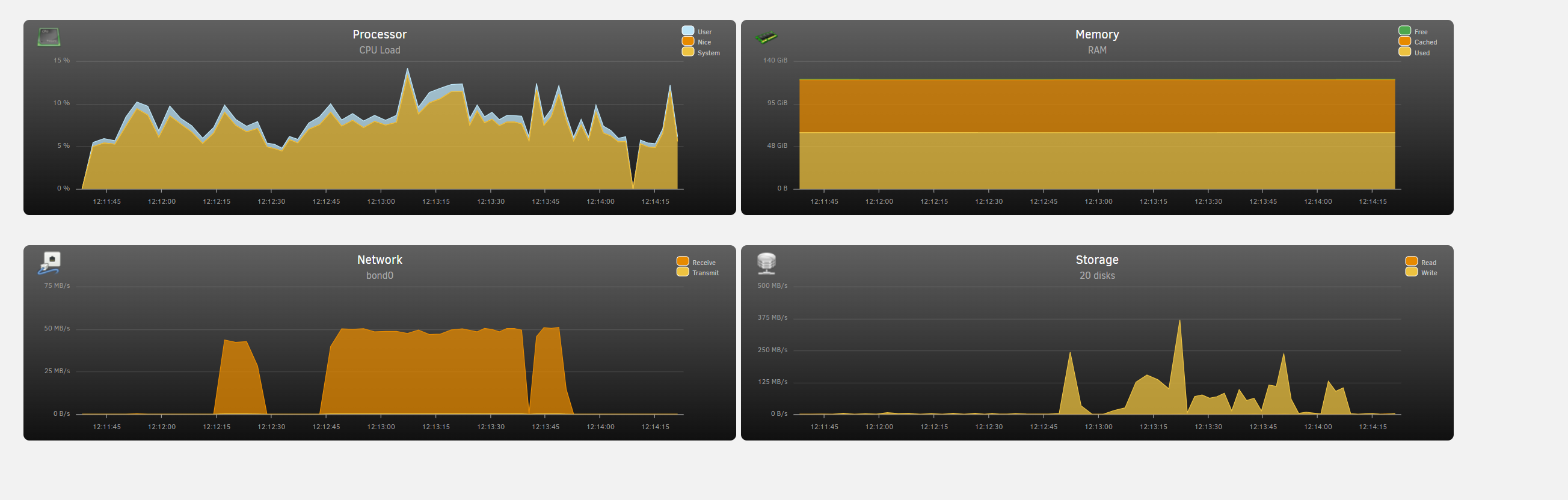

Did anyone test the speed/throughput that is achievable with devices such as USB sticks / drives? So far I can't get it to run with decent speeds (I got 500KBps at best for average and problematic delay at the beginning of the transfer). I'm using Unraid and a laptop under gigabit switch in local network. Is it a problem in my config or is this performance to be expected from this protocol?

3 hours ago, SimonF said:
Are you asking about using usbip or attaching USB devices to VMs?
I'm asking about the scenario where USB stick or other high bandwidth devices are plugged in and exported/bound elsewhere in the local network and then attached to unraid/VMs using USB/IP protocol.

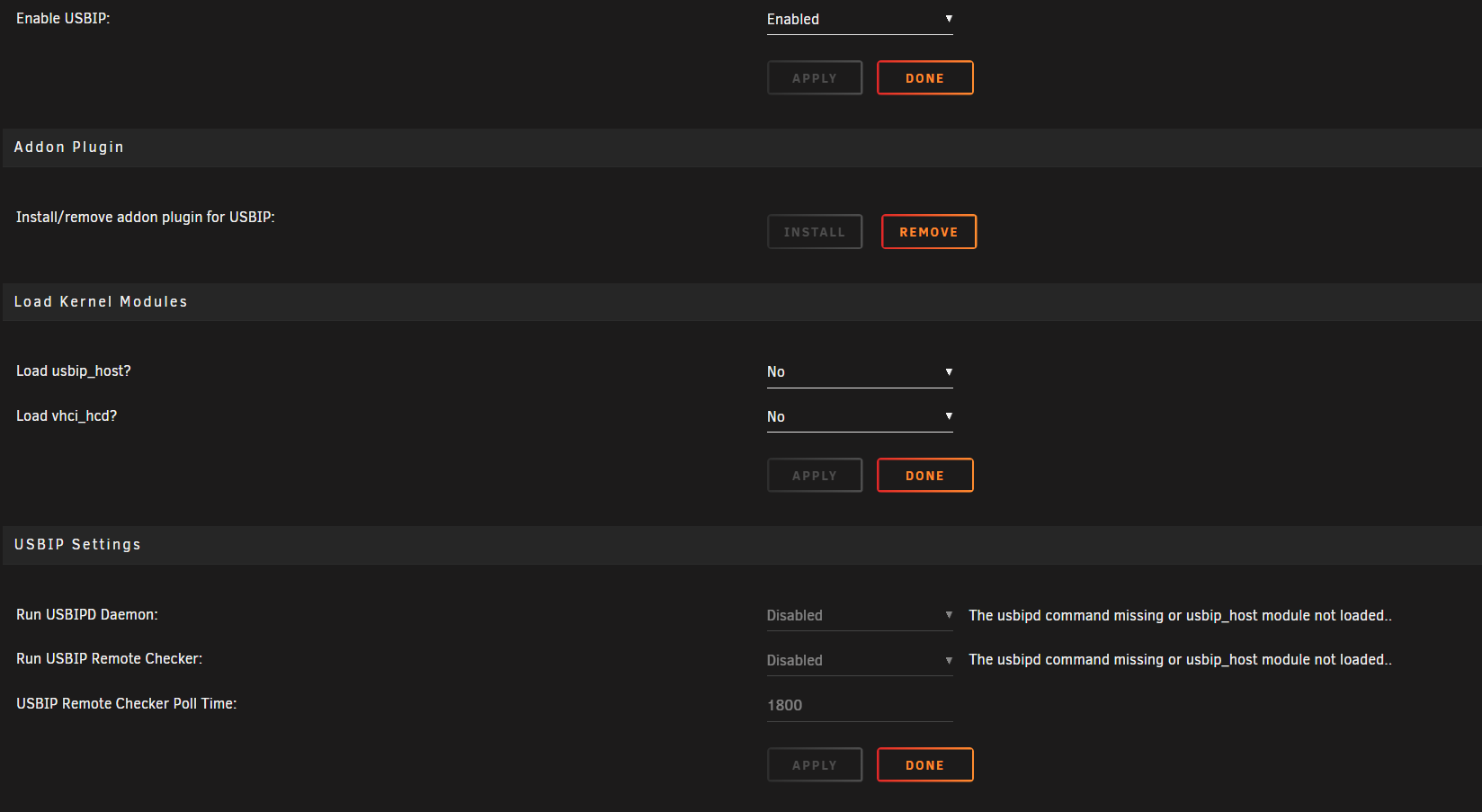

On 6/17/2022 at 3:00 AM, SimonF said:
I notice the usbipd is being started, if you are not using USB over IP you can disable that in the settings. All these options are just for USBIP
Weird. I'm not using USBIP and it's disabled as far as I know.
Also, if I enable it and then disable it, this warning pops up:
Doesn't seem right to me that would appear when disabling.
Edited by Espressomatic

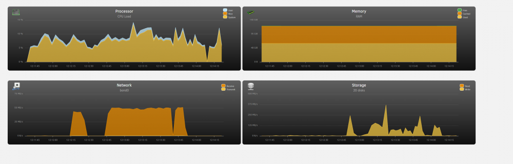

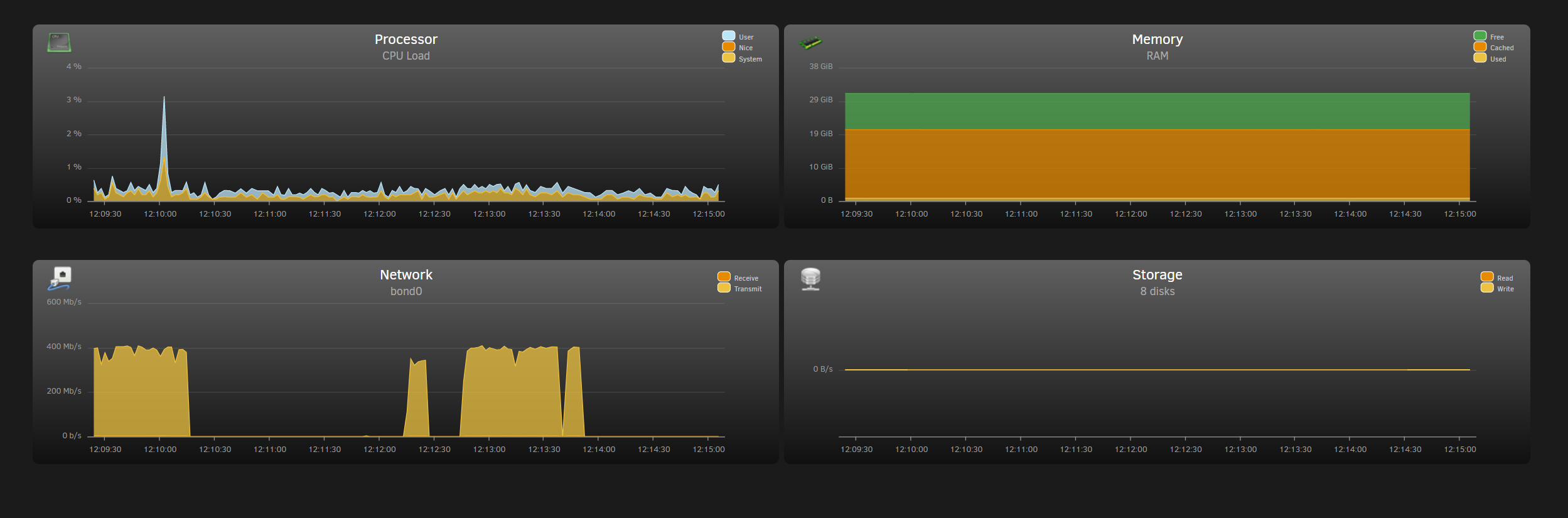

I have done a few tests with USB HD shared and flash drives, HD I got over 400Mb/s, flash about 8Mb write.
HD was on one Unraid server, Ubuntu VM on over a different Unraid server.
I think this is because I dont do a refresh will look into that.

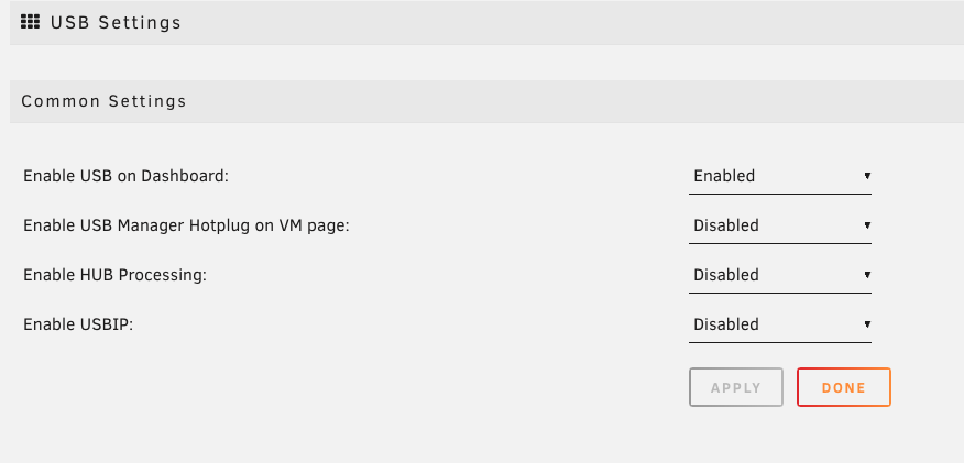

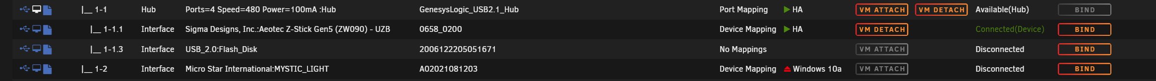

Hey,
Thank you for making / creating this plugin.
I just installed it but im trying to figure out what each option means, and it doesn't seem to be noted anywhere:
Could anyone explain the following:
1. Enable USB Manager Hotplug on VM page:
2. Enable HUB Processing:
3. Enable USBIP:
4. Difference between Edit port Setttings / Port mapping and Device Settings / Device Mapping.
Thank you all in advance for answering these questions!
This enables option to hotplug on the VM Page.
You can set a port mapping for USB Hubs and with this enabled it will process all the device attached to that HUB.
Enable USBIP:
This will enabled USB over IP functions. i.e. sharing USB devices between computers.
Device mappings will map a specific device no matter where it is connected to a VM.
Port mapping will only map USB devices in a specific USB port. Device takes priority over port.
