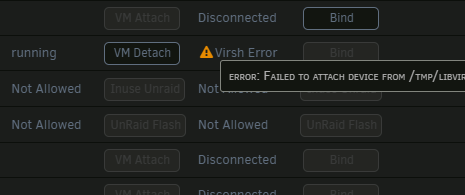

Hello all,
i think this plugin is just what i need.  is there a guide to use this?  youtube video or whatever, for dummies?  thank you!
in addition i am seeing the error on the photo attached. any idea what this means and how i can remedy it?

6 hours ago, knights_of_pine said:
Hello all,
There is not a guide at present, what do you need to do? Can you see the end of the Error line?
If you cannot see it cat /usr/local/emhttp/state/usb.ini will have the error message. Do you have it selected on the VM Template? if so it will try to connect it again. Rest of error message will say in use.

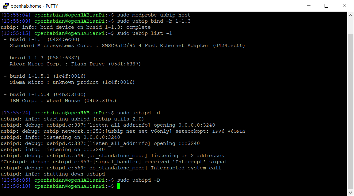

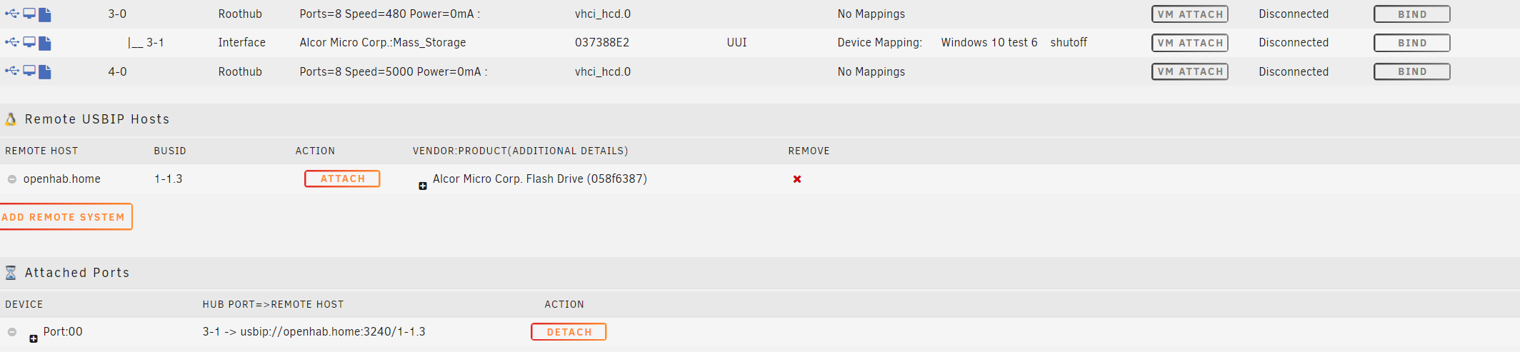

Is it possible to reverse the USB IP? And host a device on something like a raspi, and have unraid be the client?
Yes it is
You need to install usbip on the PI

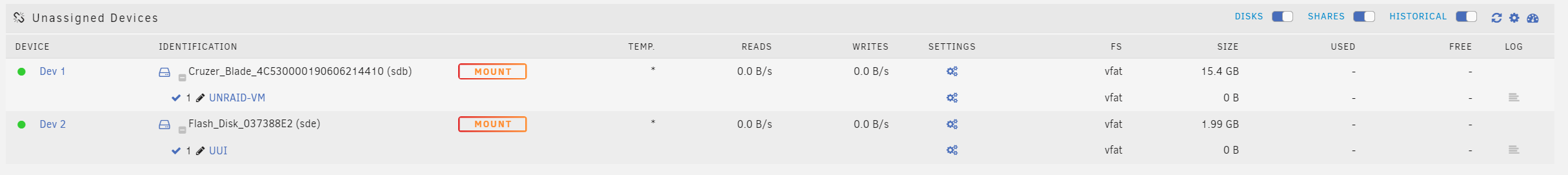

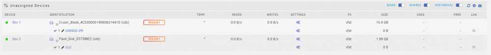

Below are the commands that bind the Alcor USB Flash Drive.
You need to install the addon module in the settings and set just vhci_hcd to be loaded.
Then in the main USB page you can add a remote system and the devices you bound show and you can attach. You will also notice the USB also shows as port 3-1 in unraid,
and it shows as dev2 in my unassigned devices.

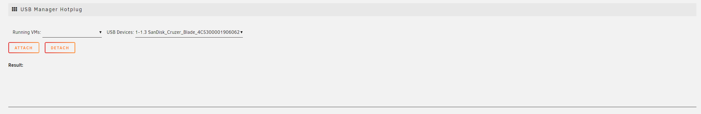

If you have this plugin do you still need the libvirt vm hotplug plugin?
No you don't but they can co-exist. If enabled in the settings there is a USB Manager Hotplug section in the VM Tab.
But this plugin will do automatic hotplugin.

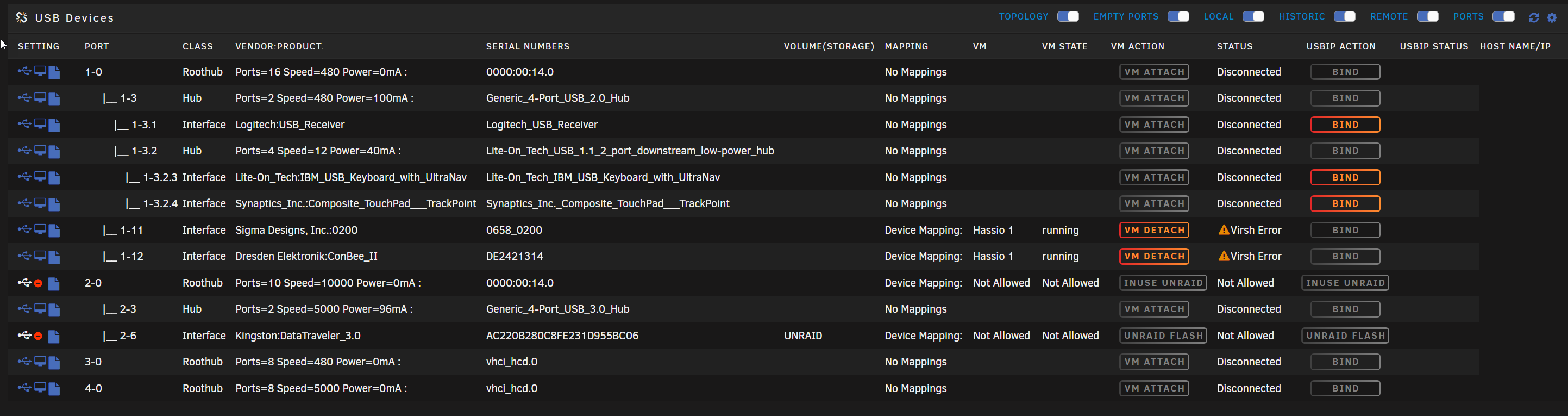

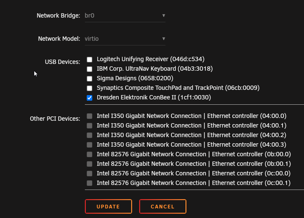

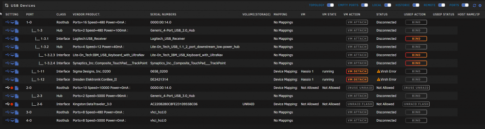

This is a Great application!
Having Home assistant on a VM with USB's for Zigbe and Z-wave is very troublesome!
I have never gotten the VM setting to work? after every reboot I needed another plugin to detach and re-attach the USB's
I now have your plugin installed and it seems to work but I have warnings here:
Should I just remove all USB settings from the VM config and let the plugin handle things?
What does the warning mean?
Again thanks for creating this app its very cool!
If you hover over the error it will say most proberly already inuse.
Yes you dont need them on the VM so they can be removed.
