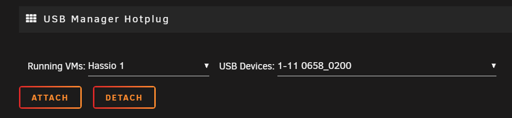

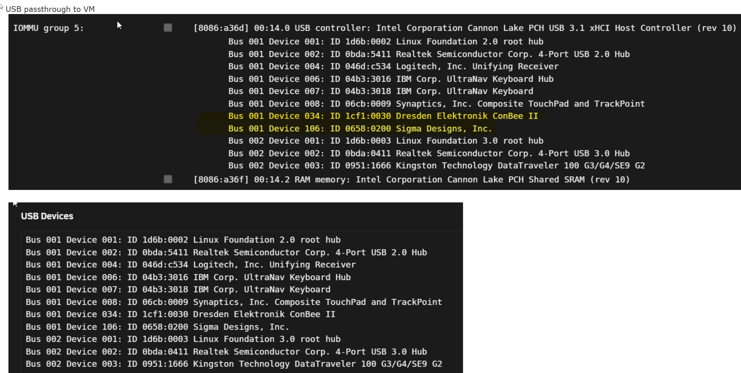

I have removed the USB X from the VM UI but I can see some USB settings in the XML view?
Also here if I try to detach and retach the USB
Another thing is that this plugin doesn't list the USB name of the Z-wave stick but I dont think thats related to the error?
The plugin shows the Sigma as:
Should I bind the driver before using the tool to attach the usb to the VM?

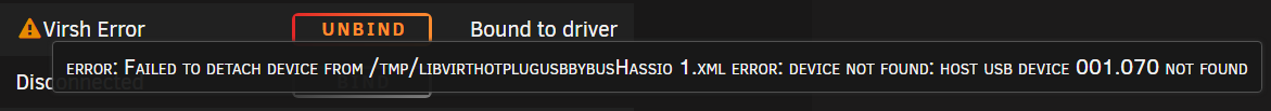

  • What output do you get if you hover over the virsh error?   The port number is only used if you enable connect as serial via the slider which is required for map Conbee II correctly above 6.
You dont need bind as that is only if you are using usbip to attach to another host.

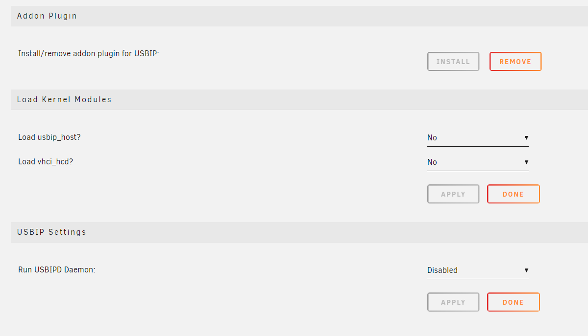

you can set usbip to disable in config.
So like this...  🙂
5 minutes ago, casperse said:
So like this...  🙂
Yes,
Unbind the device from the driver first.

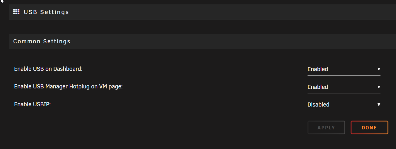

But also set the usbip values as below and remove the USBIP addon plugin before setting to disabled.
Thanks! seems to be working 🙂

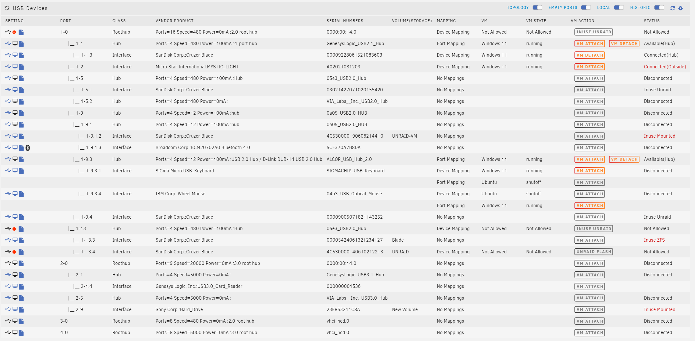

After first reboot it only mapped one of the USB drives but after the secound it looks to be fine, both are mapped:

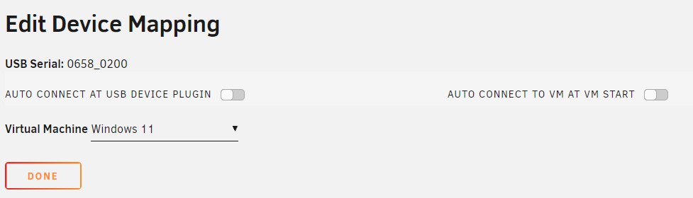

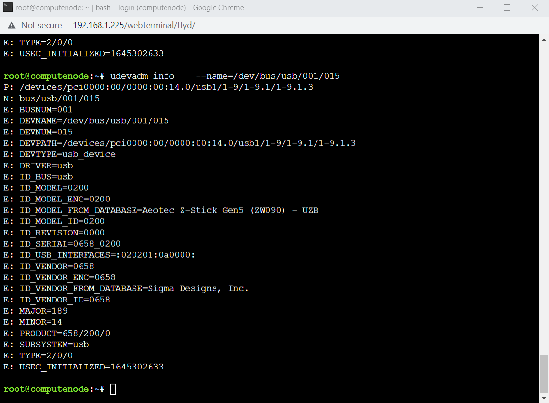

Under the VM's and the USB manager Sigma designs is listed as 1-11 0658_0200 but all others USB's use the vendor name?
Could this have anything to do with this one not being attached after reboot?
Hi @casperse
it shouldn't make any difference. That is the serial number provided which I use for the key from udev.
I can look to use the Model from Database on the Vendor:Product Column.

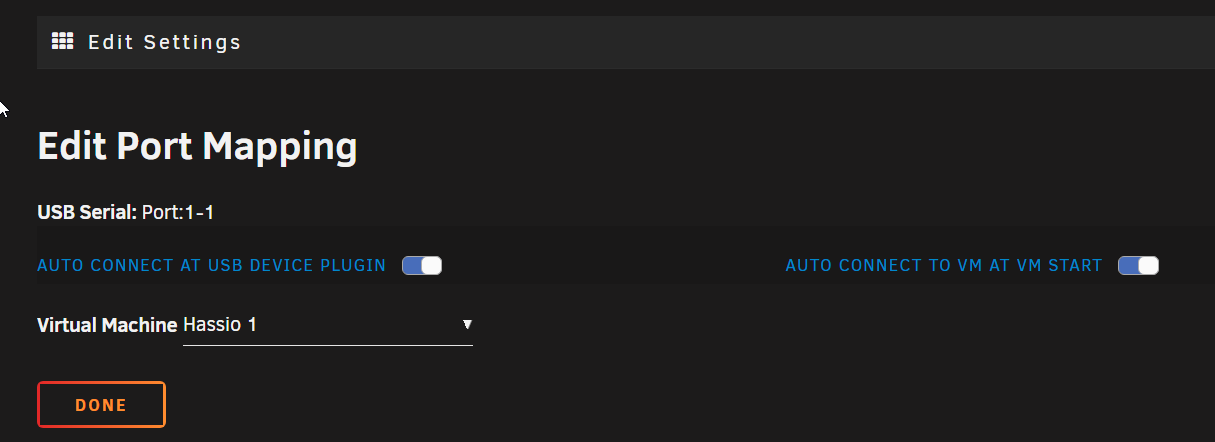

Have you tried setting the Automapping on the device or port? Then you dont need to manual hotplug. Toggle the switch to enable.
On 12/23/2021 at 1:48 PM, SimonF said:
Hi @casperse
Perfect! - Sorry for the late answer I had to many Christmas duties LOL
I didn't find this option before? I have now done this for both USB needed in the Home assistant!
Guess this will  solve all my problems thanks allot! This is a great plugin for Unraid

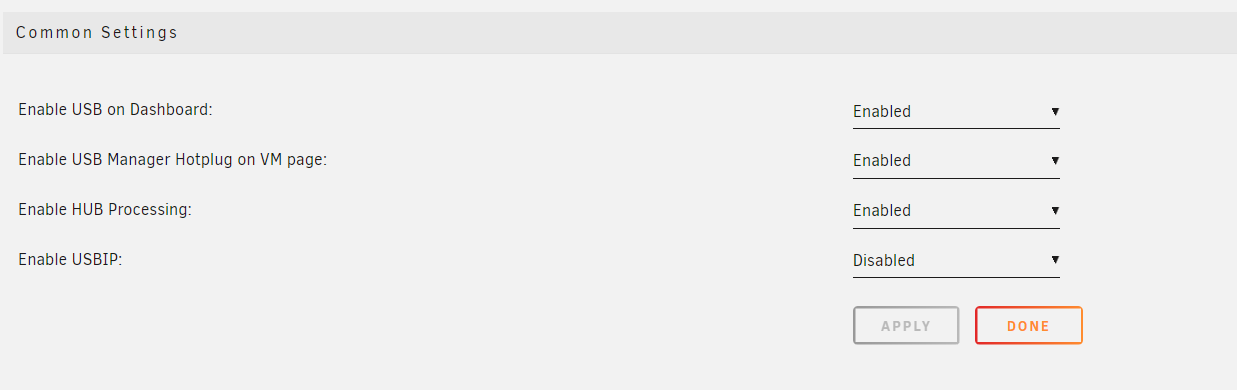

I have been adding functions to allow a hub to be setup and any device connecting to the HUB can be added to the VM. The physical hub is not connected but processes each attached device and maps to VM.
To enable you need to enable Hub process in Settings.

I’m running Home Assistant in a VM on my unRAID server. Every time I have to shutdown the server the device number changes for USB devices connected to the VM and I have to use lsusb to find the new device numbers and then edit the VM to add them. Can I use this plugin to automatically take care of this? Most of the discussion in this thread is way over my head.😁
Yes it should and should be straight forward. Install the plugin You dont need to enable USBIP in the settings.
You will need to remove the allocation from the Vm Template.
On the main page you need to add a mapping: You can select based on the port or device using the first two icons
You will be prompted with the following
Select you VM and more the switches to Connect at plugin and VM Start and you should be set.

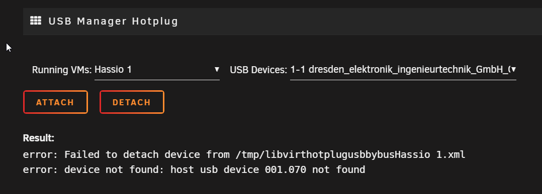

When I use the detach button I get an error-
error: Failed to detach device from /tmp/libvirthotplugusbbybusDebian.xml
error: device not found: host usb device 003.004 not found
545345661_ScreenShot2022-01-04at4_55_23PM.thumb.png.b1ee18bf6e51264acfb627c6e9b75b22.png

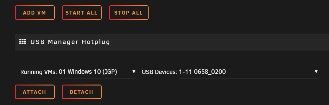

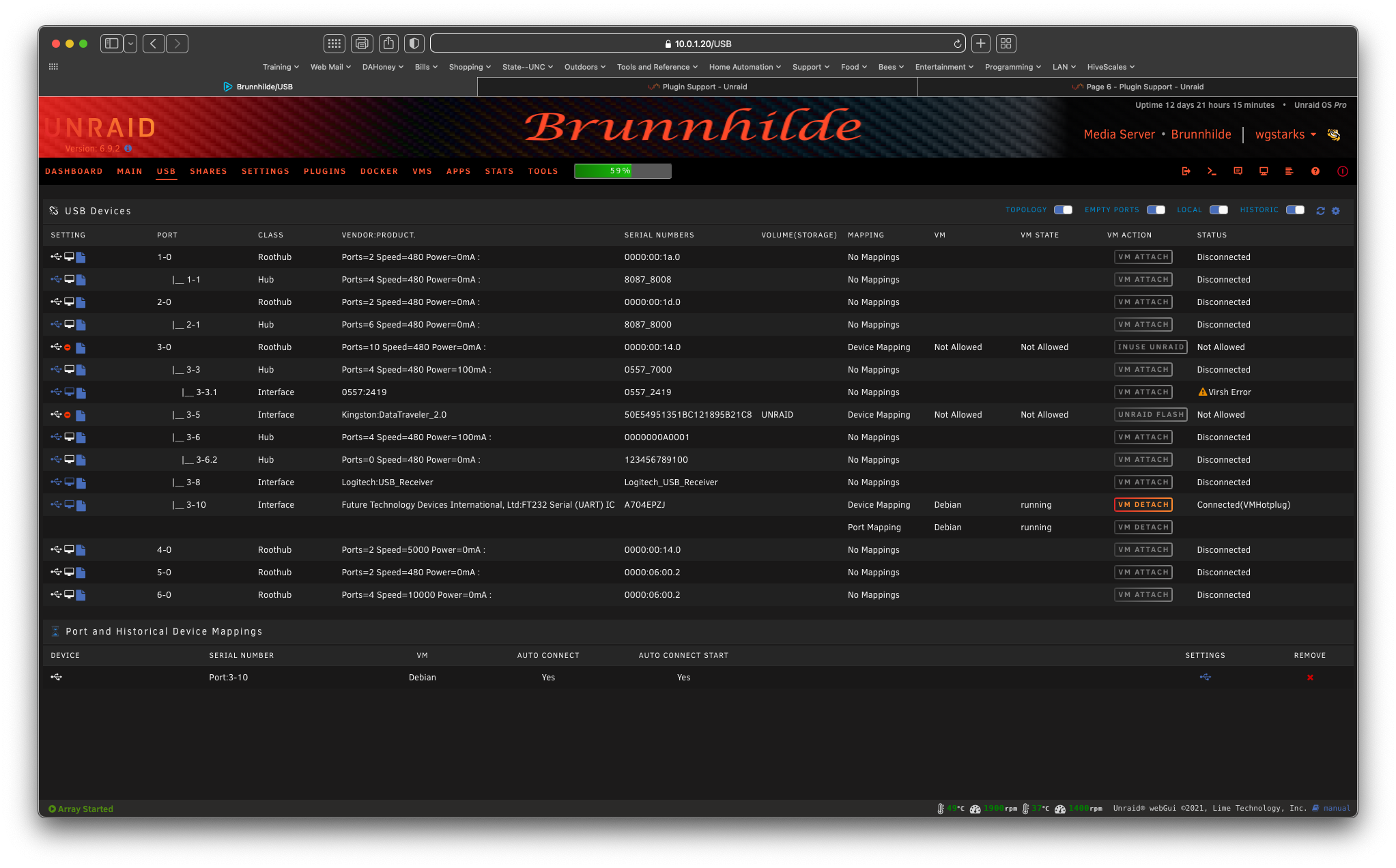

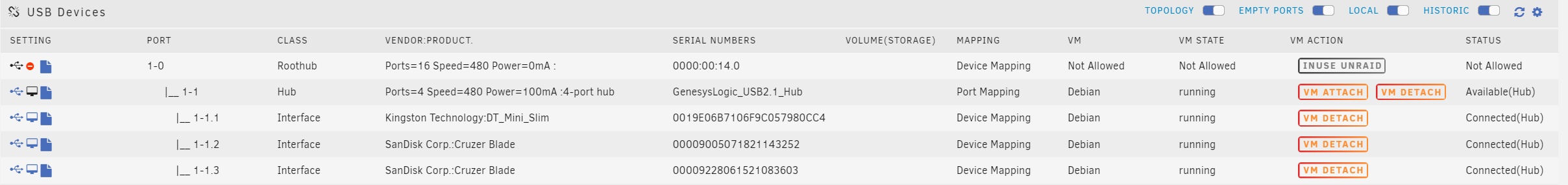

Are you able to provide a screen print of the main usb page next to main on the menu bar.
I think maybe I got it by manually editing the VM???
310903478_ScreenShot2022-01-04at5_11_59PM.thumb.png.b41b3a526d0f94cd15f432b92dc732e1.png

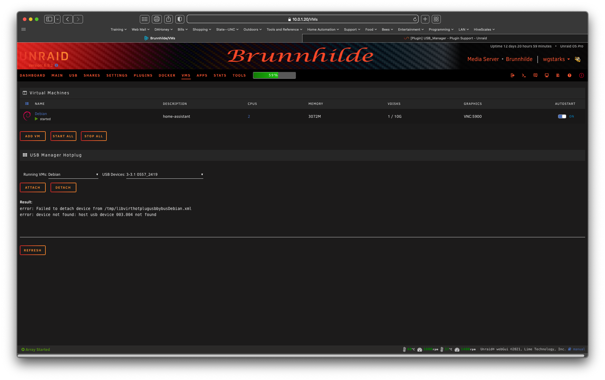

Not sure if this right or not since I didn't get the prompt you mentioned. I edited the VM and then attached the USB device in the hot plug section on the VM tab (I didn't see the new USB tab at first). After that I used the icons on the USB tab to set auto connect prefs.
Not sure what this Virsh Error is though-
2082309393_ScreenShot2022-01-04at5_16_46PM.thumb.png.f51fadca943edad80a05dfa3c19e6c58.png
There is a popup that says something about failed to detach from the debian hot plug but I can't see the entire message. It runs off the edge of the browser.

I think it maybe you detached a none attached device.
You only need the device or port mapping. It wont hurt as device is action first.

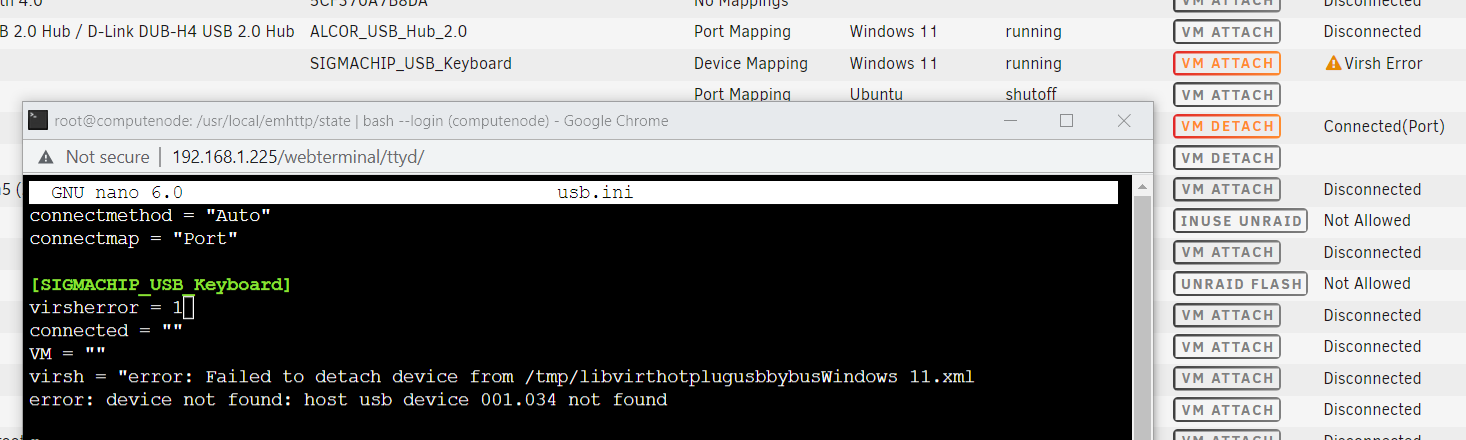

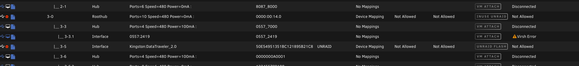

19 minutes ago, wgstarks said:
So everything is good?
When the server is rebooted or the Array is stopped and started the error should be reset.
But if you want to tidy it up you can edit the state file /usr/local/emhttp/state/usb.ini
Find the section that matches the serial number 0557_2419 and set the virsherror="" should say =1
I am planning to change the hotplug page to only allow you do detached attached devices at somepoint.
Here is an example on my test machine for the keyboard.
Worked. Thanks again.
New Release planned for this weekend.
It will include HUB processing

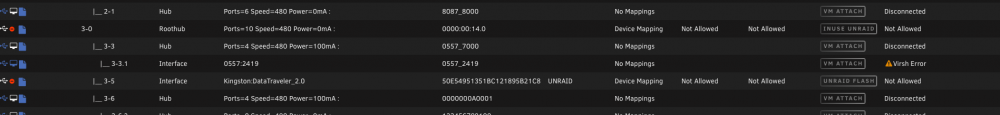

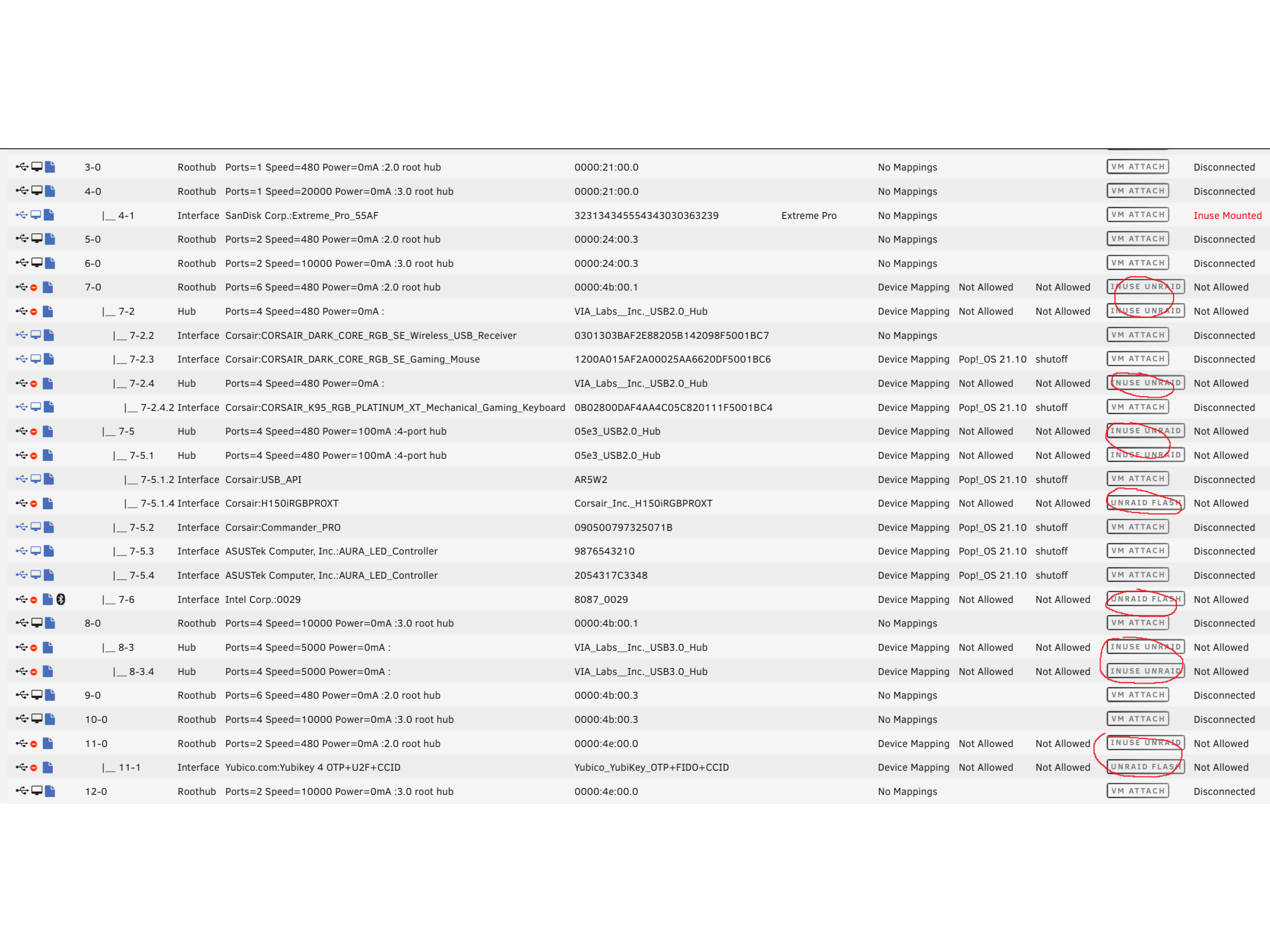

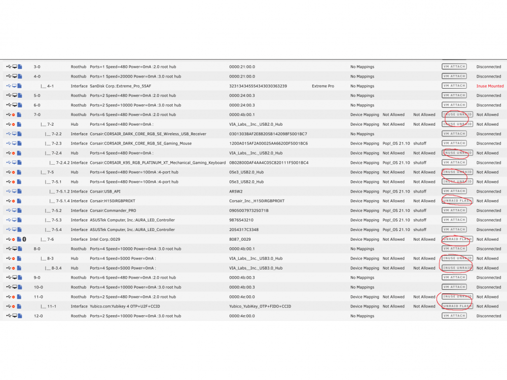

Hi, Just wanted to say I love the plugin and to report a bug and request an adjustment.
The bug @#$%#@ the flash drive which you can see from the image, I have had this happen twice in the last week... But I couched it up to me rebuilding my array and doing alot of changes at the moment while testing out 6.10.RC2... If it happens again I'll try to narrow down to what I was doing at the time.
I like the changes to the "STATUS" column with color.
I'd like to see "VM STATE" intagrated with the "VM" column in the same way or some small visual / icon instead of the text, and then maybe the "STATUS" column with the small visual / icon too.
The purpose is to reduce the overall width of the table and then also make the status visually easier to identify.
Also the "SERIAL NUMBERS" column could be added as hover over effect to the "VENDOR:PRODUCT" column or a switch at the TOP.

Thanks for reporting the issue with flash drive, I will look into it. Can you enable hub processing in the settings to see if the issue appears with that setting also? Can you confirm if you see the same issue on the dashboard view?
I like the suggestions for enhancements and will review.
