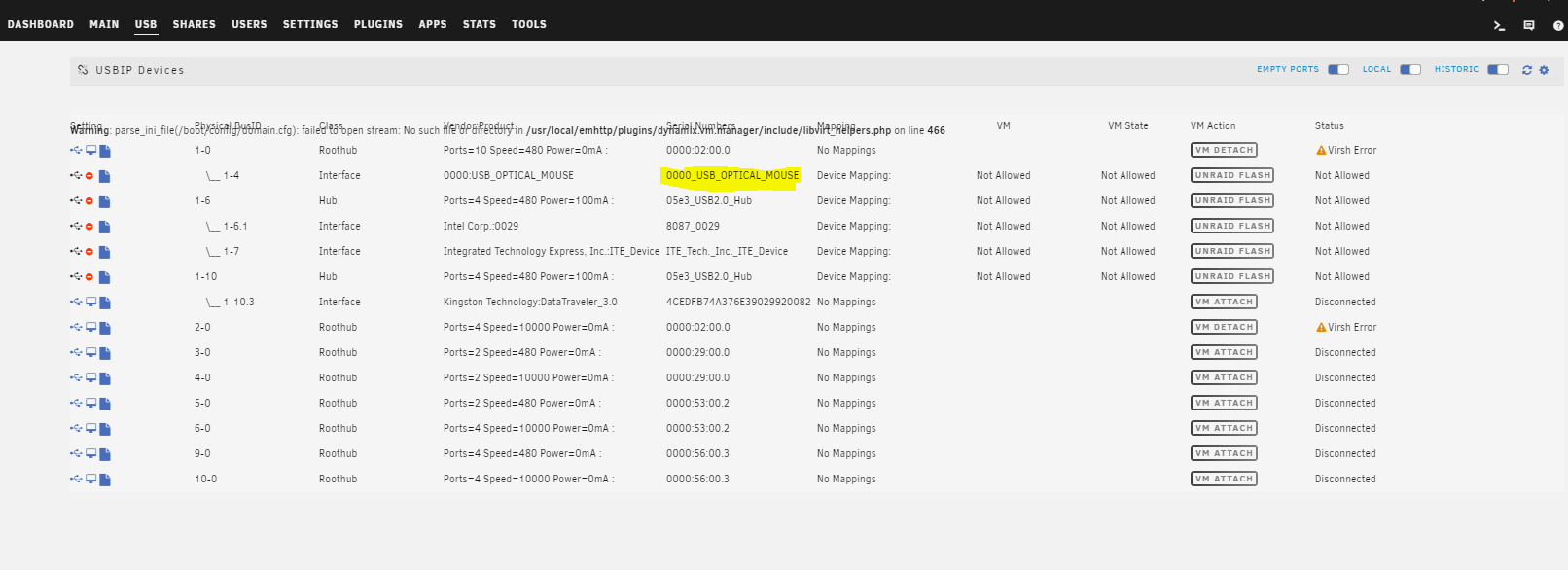

Im getting virsh error on my 6.9.2 machine. AFAIK, I'm not getting this error before.
Attached are 2 kb + 3 mouse.
1 of the kb and mouse is getting this error everytime :
Error: Failed to attach device from /tmp/libvirthotplugusbbybusLinuxMint 20.1.xml error: internal error: No free USB ports
Under Device Log Information:
Apr 10 00:33:03 AORUSPROAC kernel: usb 1-6.1: USB disconnect, device number 5
Apr 10 00:33:03 AORUSPROAC kernel: usb 1-6.1: new low-speed USB device number 17 using xhci_hcd
No other error in unraid log.
@garydapogiEach VM has a limit on the number of Virtual USB ports, I think the default is 5. I think you can increase, not sure why it would have changed in 6.9.2.
You can sometimes clear by powering down VM and restarting. Not reboot has that doesnt release the virtual ports.
Also disconnects can sometimes leave devices connected and not freeing up ports..
This was the post for increasing ports.
You need to change USB type in template to
This will support 15 ports.

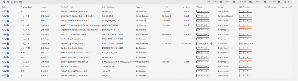

Update 22.04.21.
Added Roothubs and Hubs into the view. Also an additional selector at the top to un-hide empty ports( This can make the list very long).
Additional function to process hubs will be added in a future release. This means tagging of a hub and all connected devices will be attach to the host. It will not connect a hub to the VM as this is not supported in QEMU.
Additional Leveling/indentation will be added for the hierarchy if future releases.

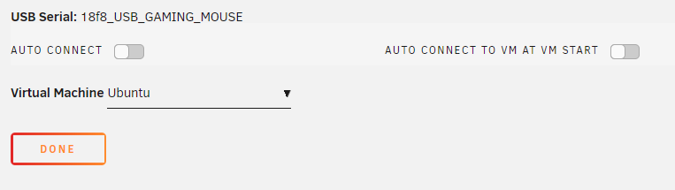

On 12/25/2020 at 2:10 AM, SimonF said:
if ($argv[2] == 'prepare' || $argv[2] == 'stopped'){ shell_exec("/usr/local/emhttp/plugins/unraid.usbip-gui/scripts/rc.unraid.usbip-gui vm_action '{$argv[1]}' {$argv[2]} {$argv[3]} {$argv[4]} >/dev/null 2>&1 & disown") ; } before if (!isset($argv[2]) || $argv[2] != 'start') {
I have the plug-in installed but in the USB menu VM attach is greyed out.
where do I add the code above?
I put it right at the beginning of the qemu file in the place mentioned in this thread.
VM attach button will only show if you have a mapping and the VM is started.
The two icons on the left create the mappings either for the USB port or the USB Device.
The code you added is used if you set the Mapping option to Auto Connect at VM Start.
Yeah I figured out that I had to click on the icon next to the port to actually “assign” it to the VM and device. Once I did that it’s working great. My monitor has built in KVM so switching between my physical machine and an unraid vm now works like a treat.

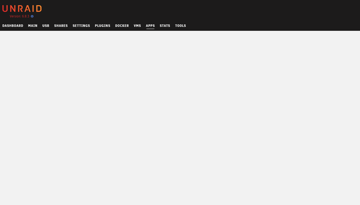

additional when I go to configure it, the screen goes blank

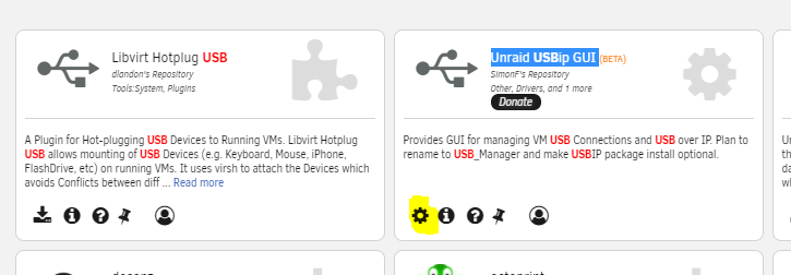

Looks like you are on pre 6.9 so usbip part wont be loaded. Click on usb next to main.
Yes, since USB together with MAIN works fine in UnRaid 6.8.3, it just seemed weird for that to happen.
Okay, now doing a pretty strange test I found this. I have a device (Mouse) that the provider actually put 0000 as VID, this device is not possible to connect it by any means and when trying with USBip GUI, the following was generated.
Warning: parse_ini_file(/boot/config/domain.cfg): failed to open stream: No such file or directory in /usr/local/emhttp/plugins/dynamix.vm.manager/include/libvirt_helpers.php on line 466
detect multiple devices like UNRAID FLASH

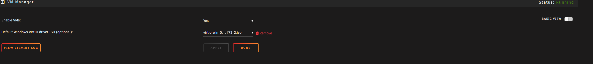

This is a function from VM Manager, I haven't tested on 6.8.3 with VMs disabled so not seen this message before.
It may be causing the issue of multiple Unraid devices as should only be one.
Will look into this issue.  Do you get the same issue without the VID Mouse Connected?
Are VMs enabled on your system?
Edited by SimonF
No
