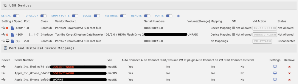

Yes but the VM is Mojave (with Q35-4.2) and the "new" device is an iPhone 5S. I don't want to take your time with what's likely an edge case.

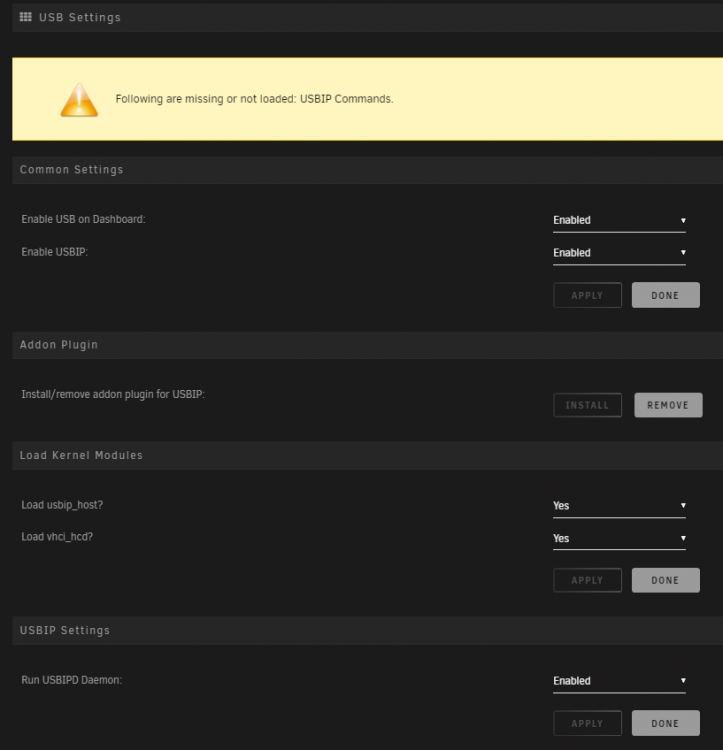

On 7/24/2021 at 8:40 AM, SimonF said:
Change to enable usbip to disable in settings and those messages will disappear.
image.png.e870703135b3785204834ea2c53053cd.pngcontent://com.android.chrome.FileProvider/images/screenshot/16271305008562117425920.png
Thank you!!
I'm new to USB manager and enabled HUB Processing to see what it would do and got that message. Didn't realize that I must have also enabled USBIP at the same time.
I was wondering what I broke...
What is USBIP? Does that allow a VM to access a USB device that's elsewhere on the network?

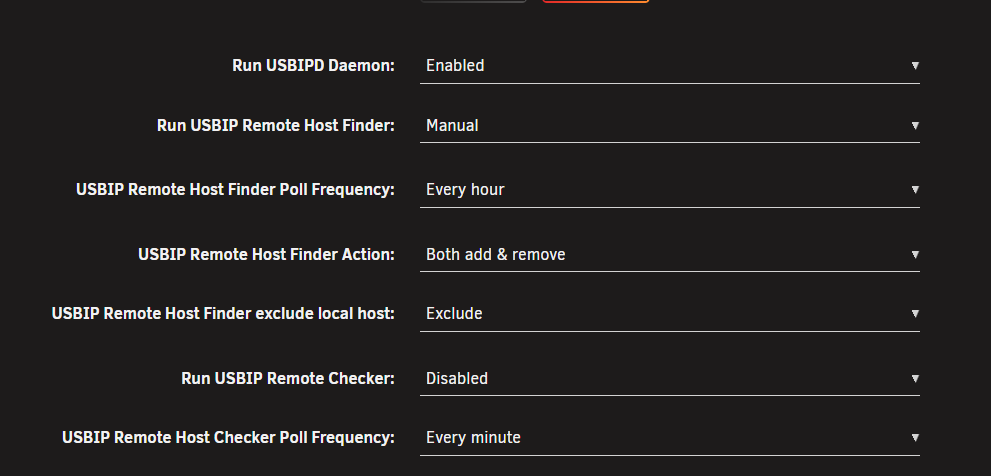

Yes USBIP allows connecting a USB device from another, i.e. a Raspberry PI could be the USBIP server and the Unraid server uses it over the network. You need to install an add on plugin for the usbip binaries. Note USBIP is not a very secure comms session.
Hub processing will connect all of the devices on a specific hub as you cannot passthru hubs. It will go through each of the devices and attachment to a vm.
Here is a post showing usbip.
