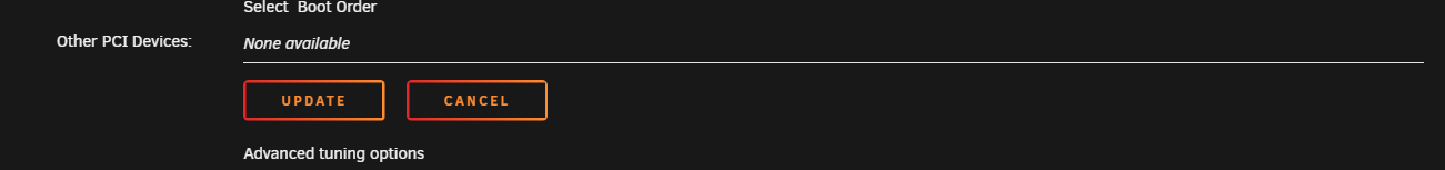

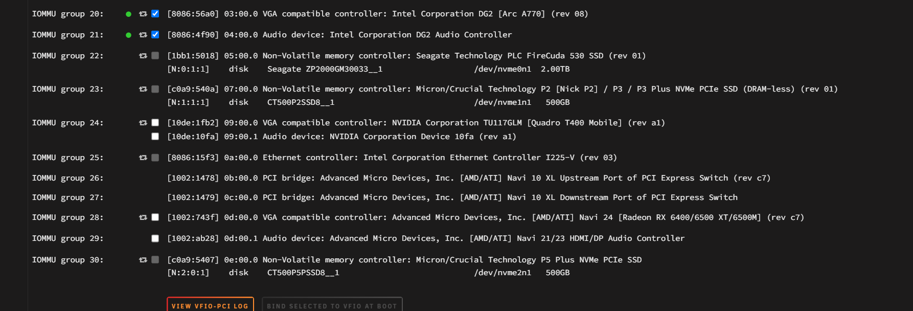

I borrowed a PCI USB card from a friend to try that, Unraid see's it as an extension of the USB network. I cannot seem to pass through the entirety of the PCI card, just the Hub 3-1. Still doesn't seem to work with or without the auto-connect options.
If you have a PCI card you should passthru that to the VM.
In system devices bind that new card to vfio. I dont have a dedicate PCI USB, but like my A770 click the check box next to the card. Then the bind button will allow you to save the setting.
You will need to reboot the server for that to take effect.
Then in the VM you should see the card. in this section on the VM Template. Other PCI devices. Select the USB card and update. Now when the VM starts the whole card is connected to the VM and any USB devices connected will be on the VM.
For devices connected to the card they do not need to be in the VM template and should not even show as the card is not bound to the host but the VM.

As soon as i start array and VM gets started, unraid flash is passed to VM
I can't go to VM settings to check it, as it does not show up after array start.
Any ideas how to get out of this loop?
