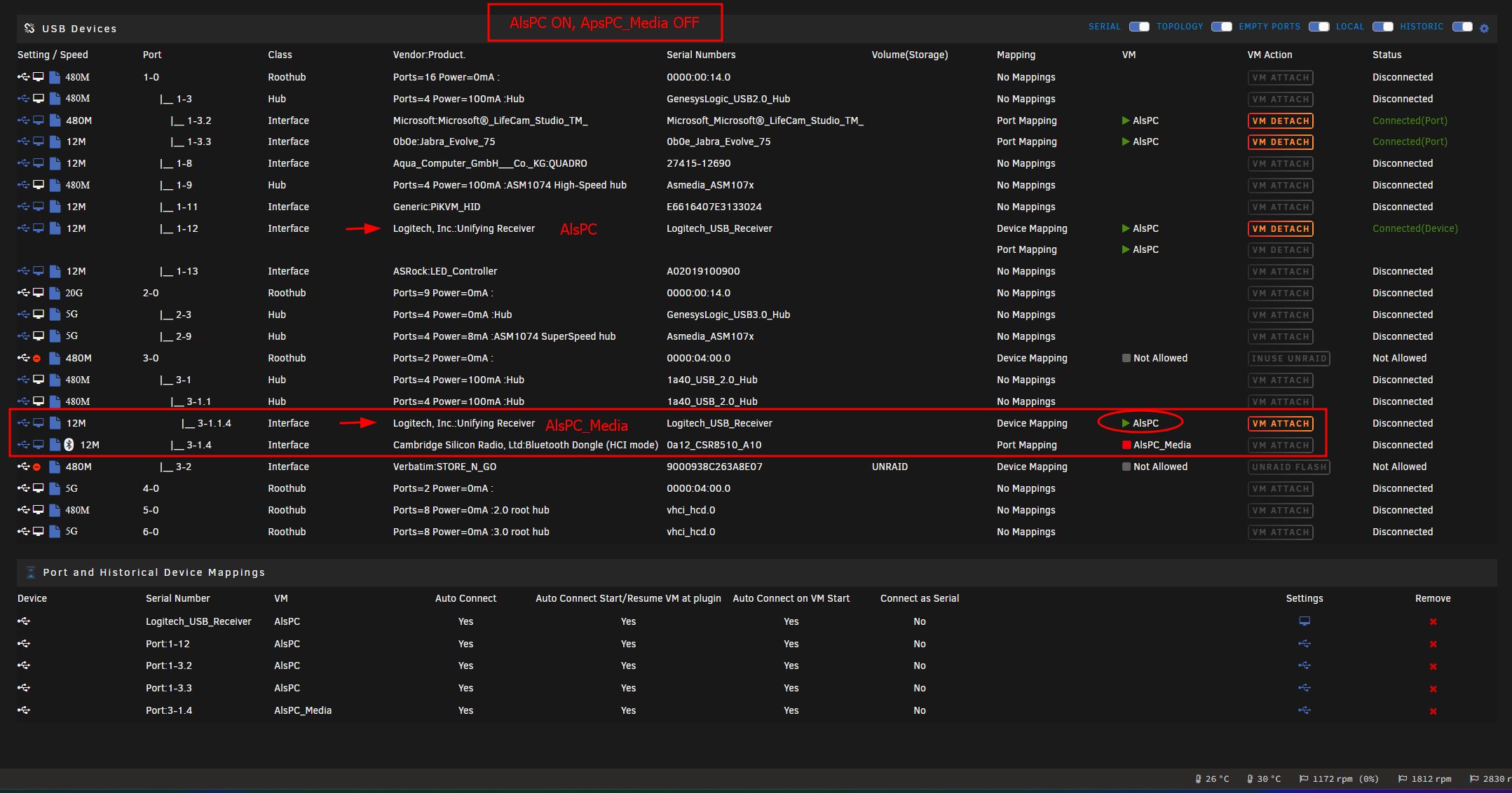

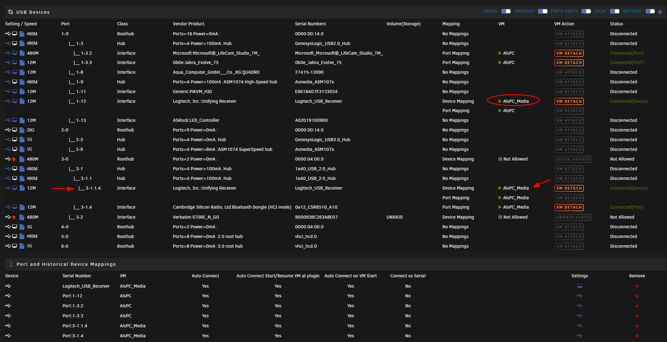

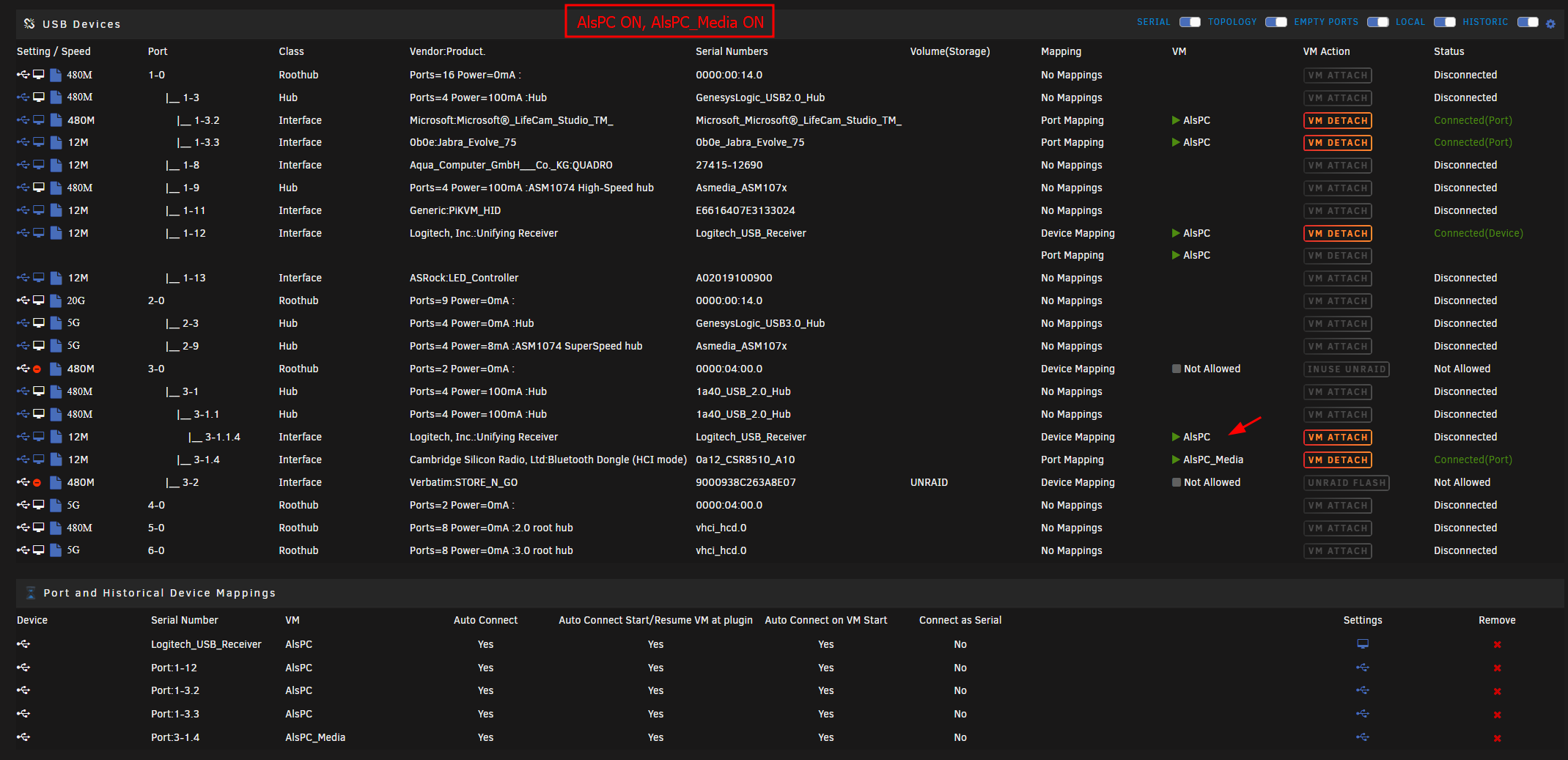

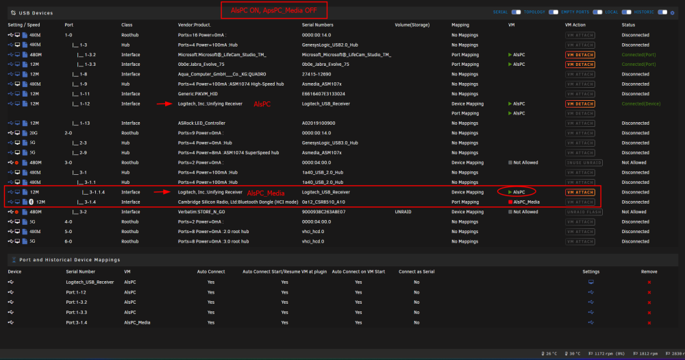

i have 2 Logitech Unify Receivers here for 2 VM's (1 GPU connected to a Mon, 1 GPU connected to a TV)
1/ AlsPC (Desktop VM Monitor)
2/AlsPC_Media (Gaming VM TV)
so i assigned the different ports to the different VM's, but it looks like, depending on the last VM state it "mixed" the assignements in the GUI at least (and also not auto connecting the 2nd one here)
now, when i start VM 1, i see the following screen
as i see in the bottom, the device on Port 3-1-1-4 changed to AlsPC while device on Port 1-12 is auto connected to VM 1 (as it should)
now, when i also start VM 2, i see the following screen
the device on Port 3-1-1-4 stays on VM 1 (AlsPC) and is not auto working in VM 2
when i now change it again (3114) it will also change the upper setting in the GUI from VM 1 device (1-12) ...

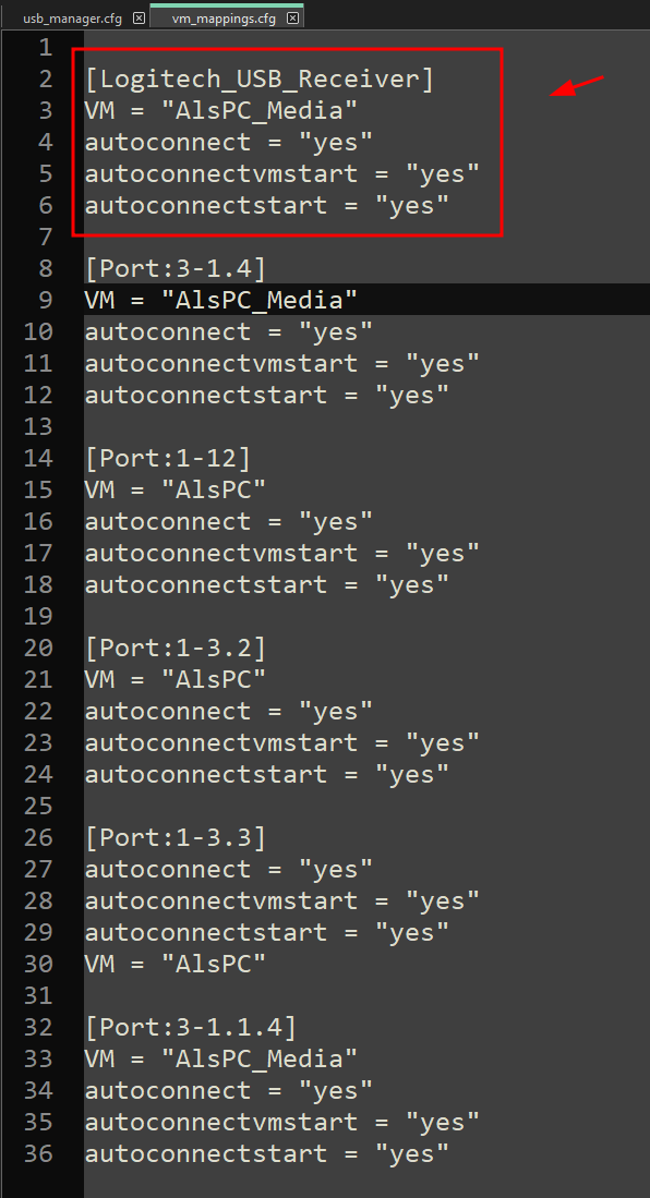

while the usb vm_mapping config looks like this, possible that the 1st entry is "shuffling" around ?
my next step would be to delete this entry and look what happens ;)
or is there somethinng "special" todo with 2 simultan uuid devices ?
31 minutes ago, alturismo said:
may a question as i seems to missunderstand some config ;)
As it looks like both devices have the same serial ID you cannot use the device mapping. Just setup a port mapping per device to the correct VM.
ok, i thought thats what i did, but may didnt klick on the right spot and didnt notice im on "device" instead "port", seems removing device fixed it ;)
sorry and thanks.

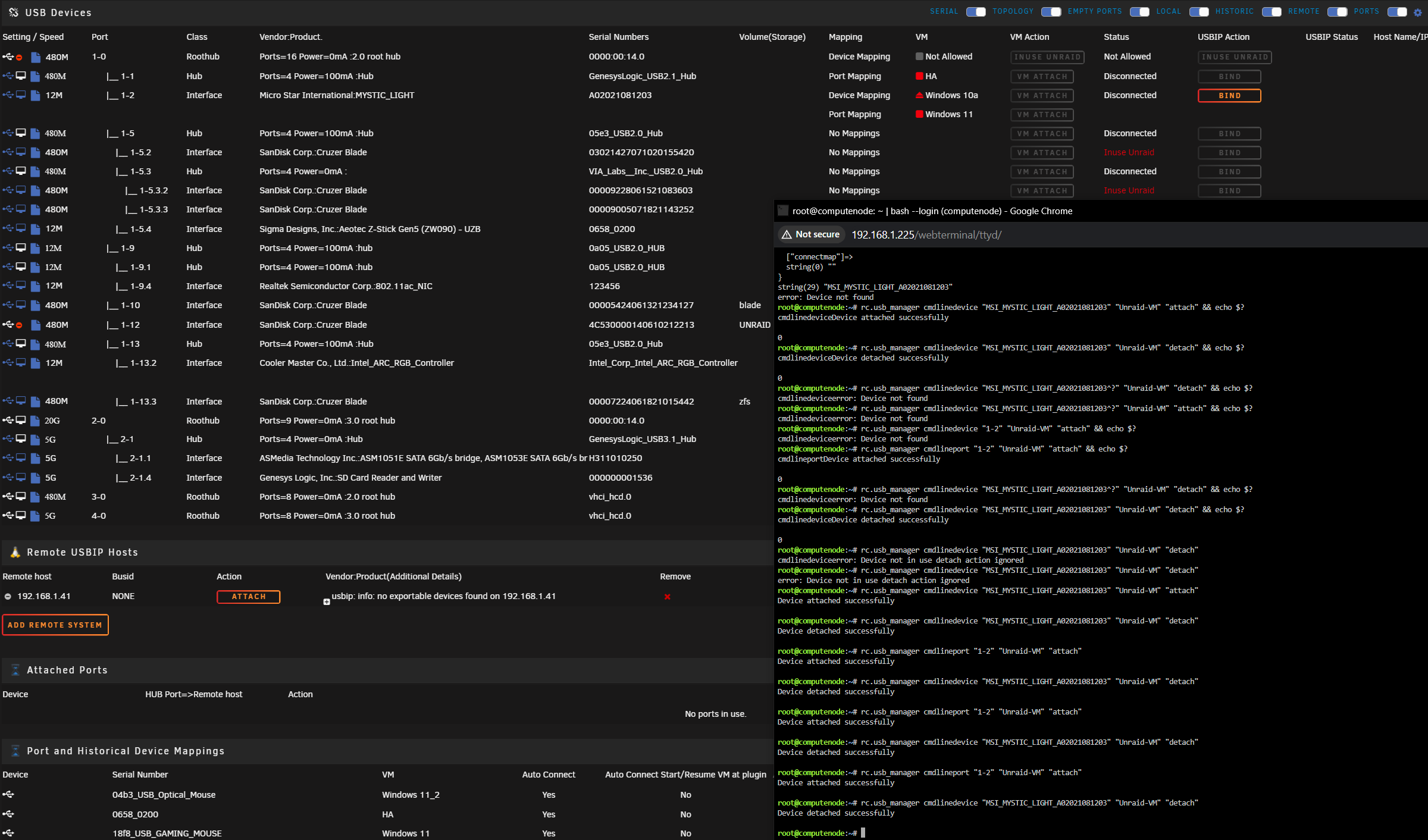

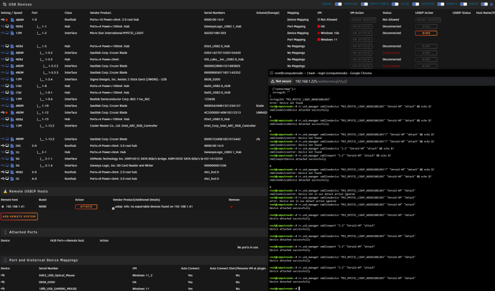

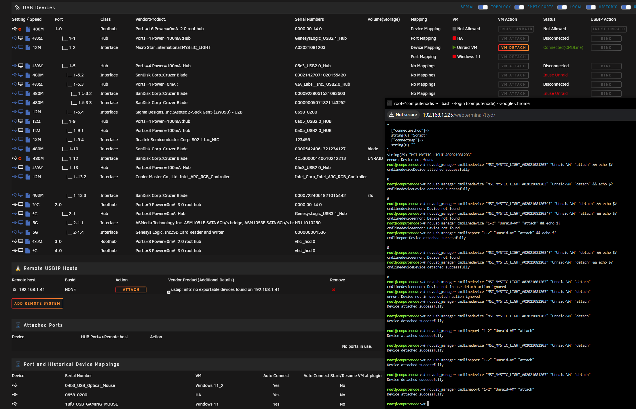

root@computenode:~# rc.usb_manager cmdlineport "1-2" "Unraid-VM" "attach"
Device attached successfully
root@computenode:~# rc.usb_manager cmdlinedevice "MSI_MYSTIC_LIGHT_A02021081203" "Unraid-VM" "detach"
Device detached successfully
root@computenode:~#
https://github.com/SimonFair/USB_Manager/commit/552567430e0d67d6f3bb08920578ca99ad4e00f6

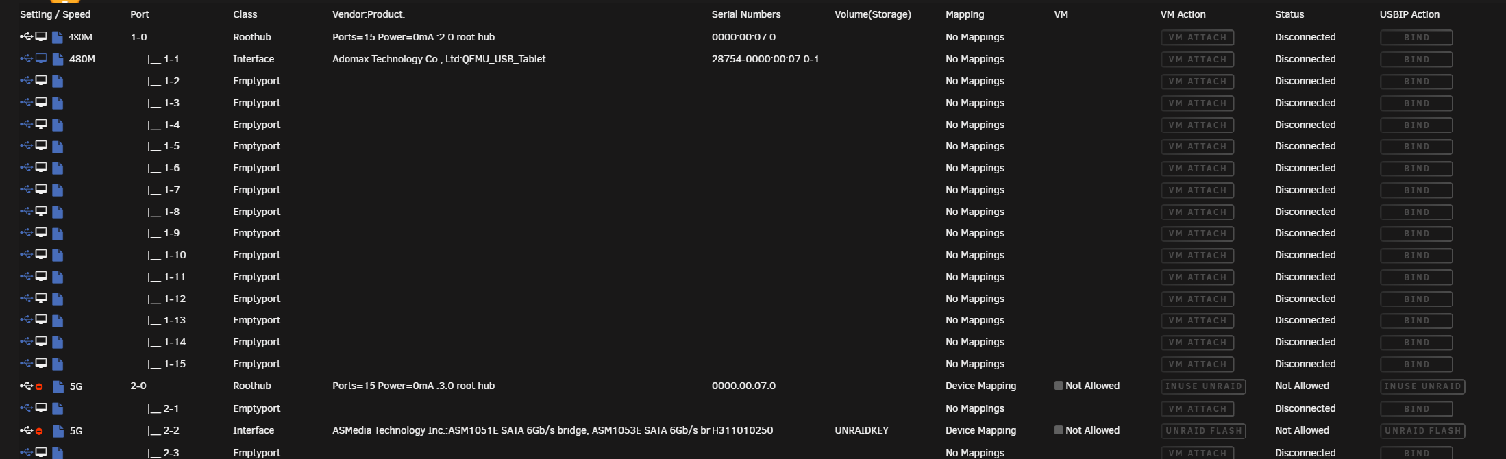

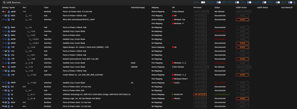

Hi Simon, thank you for your work and your patience answering all the questions.
I have a Gigabyte C246M-WU4-CF Mainboard. This Motherboard has in total 12 USB-Ports, but it seems that this Motherboard has only one USB-Controller (Link: server_manual_c246m-wu4_e_1101.pdf (gigabyte.com), Page 7).
My goal is to passthrou 2 USB Ports to a Win 10 VM.
I installed the USB-Manager and the additional USBIP plugin. After the installation, all buttuons i see are grey. Does that mean that i can not passthrough single USB-Ports to a VM?
Thank you very much.

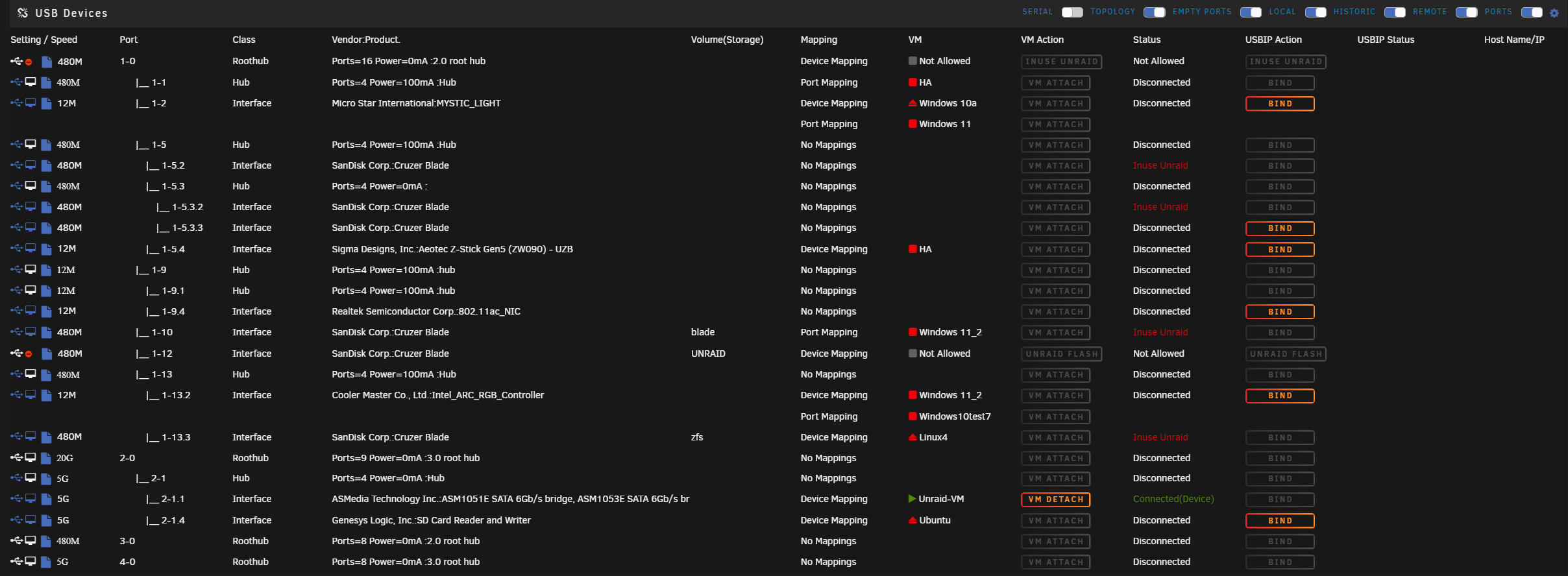

I guess you dont have any devices connected. If you connect a device you will see it appear and then you can create a port or device mapping.

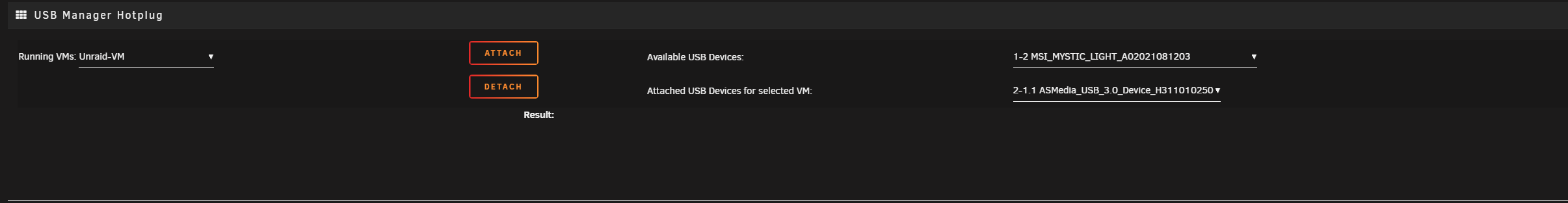

If you have enabled hotplug you can attach devices via the VM tab also.
If you toggle empty ports it will show empty ports also.
Example with empty ports.
Click on these icons.
Left is for ports, right for Device Mapping and you will see.
The settings.
This is for a device.
This is where you can specify VM and actions.
Auto connect at plugin will attach usb device when connected.
Auto connect at Start will attach at VM start.
Start/Resume will start/resume a VM when as device is connect and and connect at plugin is enabled.

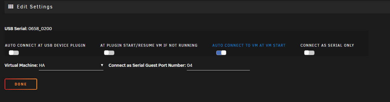

Serial only is if you need to attach as a serial port, Things like ConbeeII needs this. Default is port 4 but if you have multiple you may need to change this.
Port mapping is the same as a device but will connect any device on that port to a VM. Device will only do that device but will work across any port.
Hope this helps.
ps usbip extra is only required if you want to use usb devices over networks from/to other ser ers pcs etc
1 hour ago, SimonF said:
Hope this helps.
I love you man, this works great

Here is the output of the command
Strange I would expect to see an error
Sorry I ran that after rebooting the VM where it says its connected, but detaching and re-attaching and then running the command here is the output.
