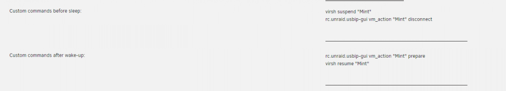

Another users was doing something similar in the early days. Example of commands to run.
rc.usb_manager is the name of the functions now the below was before the plugin was renamed.
I edited these commands by replacing and name of the VM with "HomeAssistant"... But somehow it calls a halt of the system and shut my sytem off when I wake it from sleep. Ah ah ah. I will investigate :).

It works. Reboot bug was because somehow virsh wasn't interpreting the VM name when using parenthesis.
So the script part for sleep is :
virsh suspend HomeAssistant
rc.usb_manager vm_action HomeAssistant disconnect
And wake up :
rc.usb_manager vm_action HomeAssistant prepare
virsh resume HomeAssistant

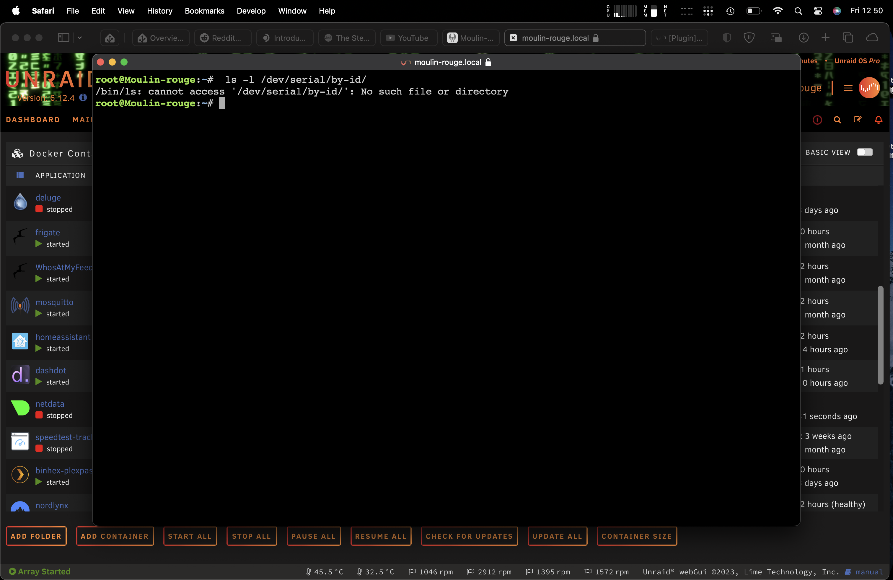

1648385179_Screenshot2023-11-10at12_50_50.thumb.png.bf0cfbd3762437ca78bcd54a7034fb6f.png
Do you have an example type of device and how you find the mapping? This is one of the ways I get info. adding -a will walk up the tree.
udevadm info -q  property -n /dev/bus/usb/001/012
root@computenode:~# udevadm info  -q property -n /dev/bus/usb/001/012

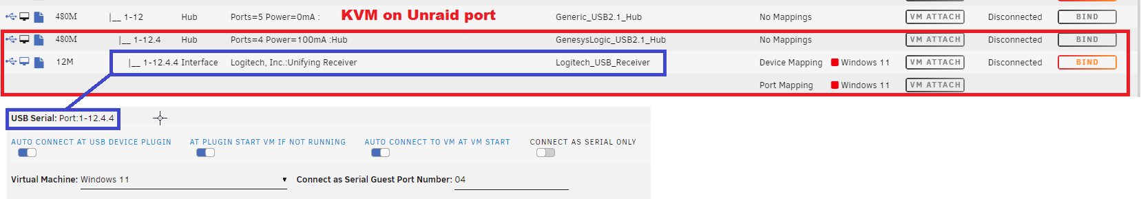

Is there a way to run a script when it detects a device? I have a KVM that has a USB hub that passes a USB keyboard/mouse dongle. I would like it to start a VM if it is not already running. Is it possible to add the option in the plugin to start the VM when a USB device is detected?
15 minutes ago, jzhvymetal said:
Love the plug, and it works great.
I did start to look at adding option to run a script but have not implemented as yet. But if it is just starting the VM if not started that should be a simple-ish add. Or option to run a user script from squids plugin may also be do-able.

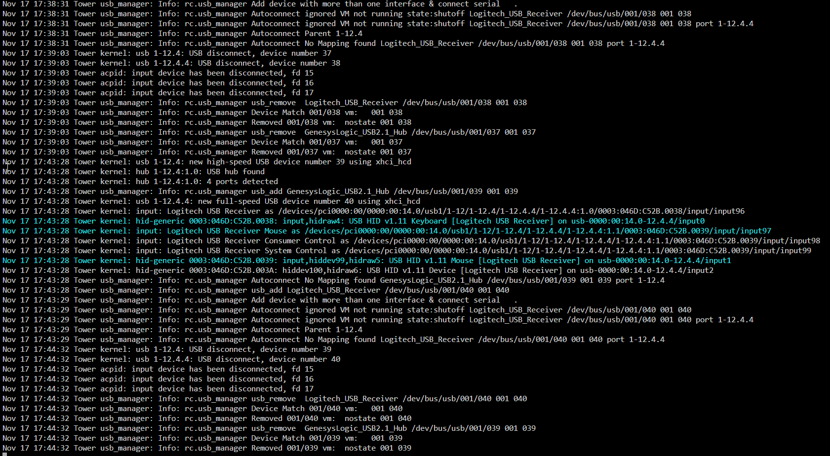

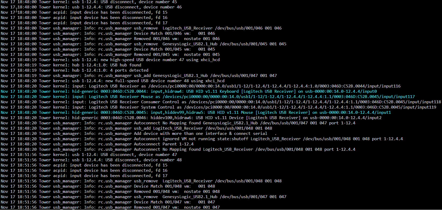

Thanks you work fast.  I tried it but does not seem to start the VM.  Is at the start of the Plugin or when the USB device is plugged in and discovered?
Edited by jzhvymetal

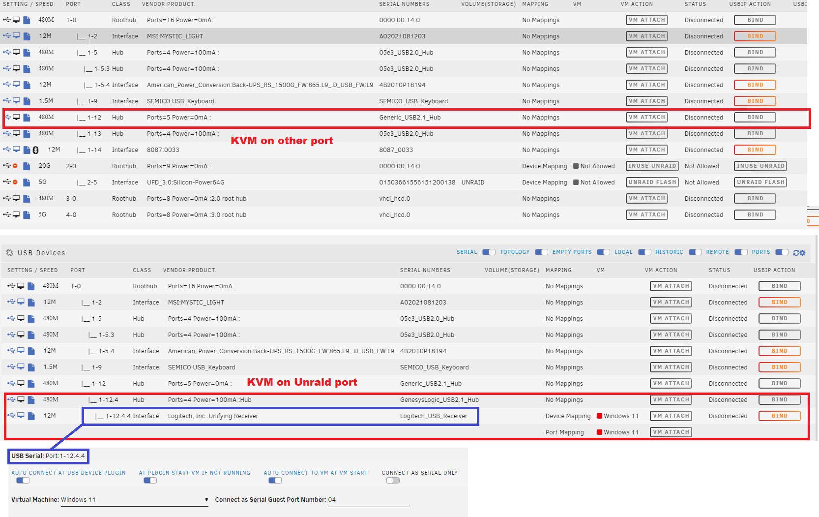

Mapping in post above.  Logs are below.  I just updated the usb plugin do I need to restart Unraid?

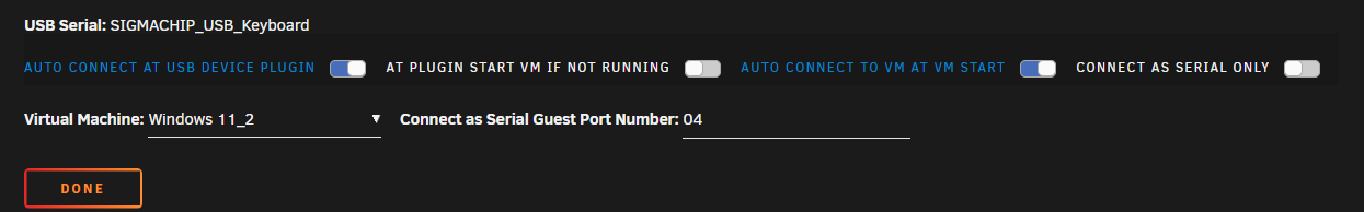

No need to restart unraid. Have you set the switch in the device mappings as per my screen shot you will need to enable start vm switch.
Yes I did.....see below.  The KVM switches in a USB hub that the dongle is connected.   Switching KVM port, It works perfect when the VM is on.  When VM is off it does not start the VM.
I updated my post above. Will do some more testing tomorrow
Ok thanks.   No rush.  I have my Unraid server 20m away in basement but I have my work laptop to start the VM.   Most say to leave the VM running but I notice there is 40w less draw when it is sleeping.  The goal is to start the VM remotely by just switching the KVM.

Again no rush......I tried renaming the VM to "Windows_11" and remapping the dongle and sitll does not start.  It might be that the device is casecaded with multiple USB hubs?    Let me know if there anything else needed for testing.  BR
Here is my setup
Unraid Server -> Active USB cable -> Powered USB Hub -> Powered KVM with switched USB HUB -> Logitech Keyboard/Mouse Dongle
