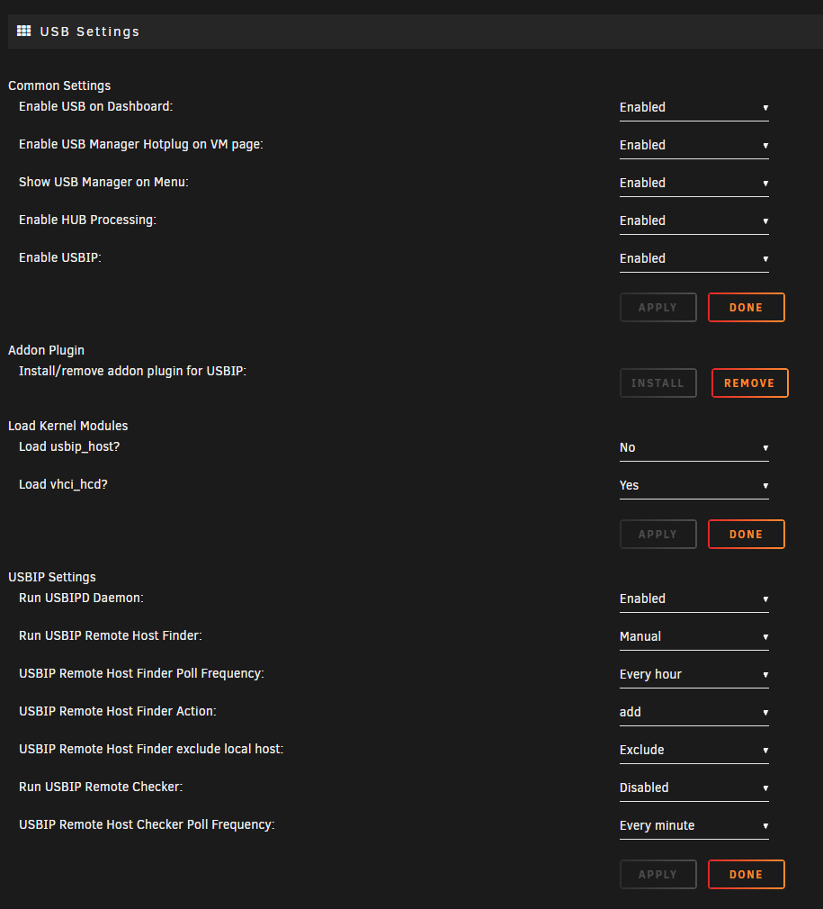

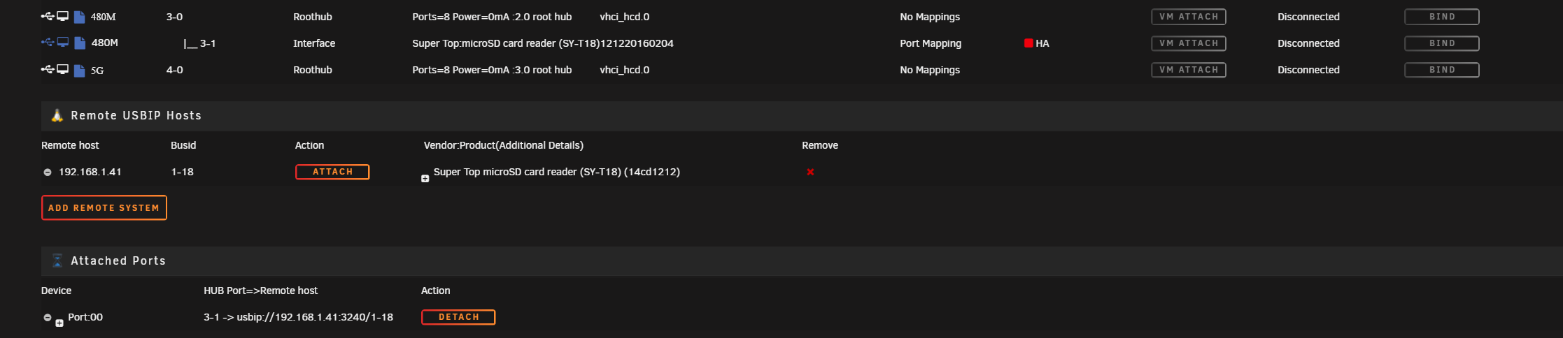

Thank you for replying. I have a Pi running dietpi and usbip with 2 usb devices attached. On Unraid I have passed those devices to a VM. This is all working fine.
Here's a screenshot of my USBIP page. Is it set correctly?
Any pointers to help me diagnose the log entries would be much appreciated please 🙂
Not found any issues running same config my side,No options I know of to stop the logs as looks like a connection is failing. USBIP Debug is not enabled in the Kernel.

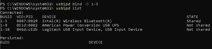

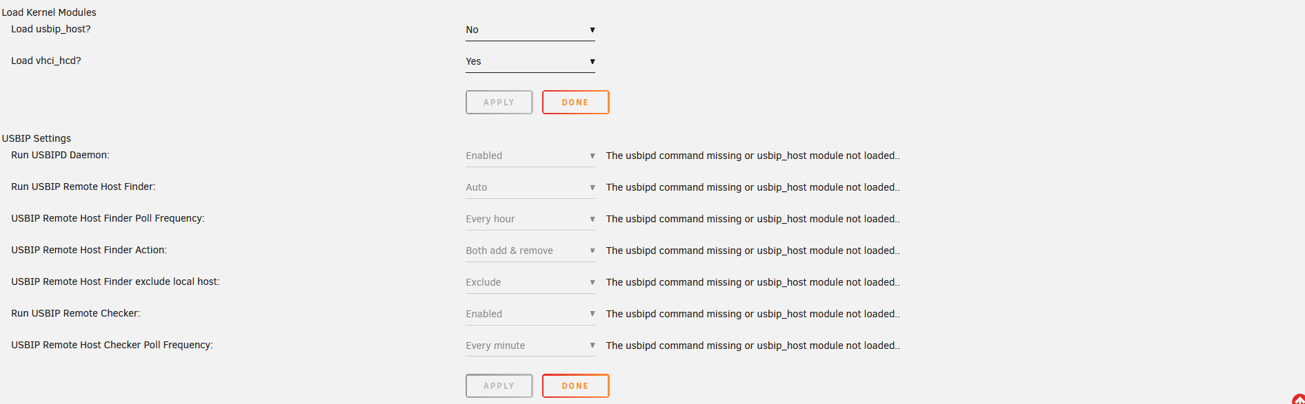

I'm attempting to connect a built-in bluetooth device on a separate PC via usbipd/usb_manager so that I can map it to my Home Assistant Docker. I have usbipd win installed on the "remote" PC (same LAN) and have the following settings configured. When I click attach in USB Manager, I get the following in the logs. Any ideas? I've Googled for an hour.
Jan 28 11:32:25 arcturus kernel: vhci_hcd vhci_hcd.0: pdev(0) rhport(0) sockfd(8)

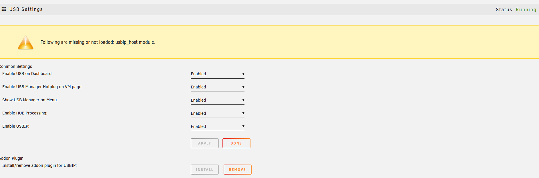

Ended up getting this to work via USB Manager. Thanks Simon for the excellent plugin! Leaving all my notes here for future me or others:
Steps to use USB Manager to connect a remote Bluetooth USB dongle to a Home Assistant docker running on Unraid
  1. Install usbipd-win on the remote Windows 11 PC host that we want to passthrough following instructions here ignore the parts about WSL.
  2. Bind the device using

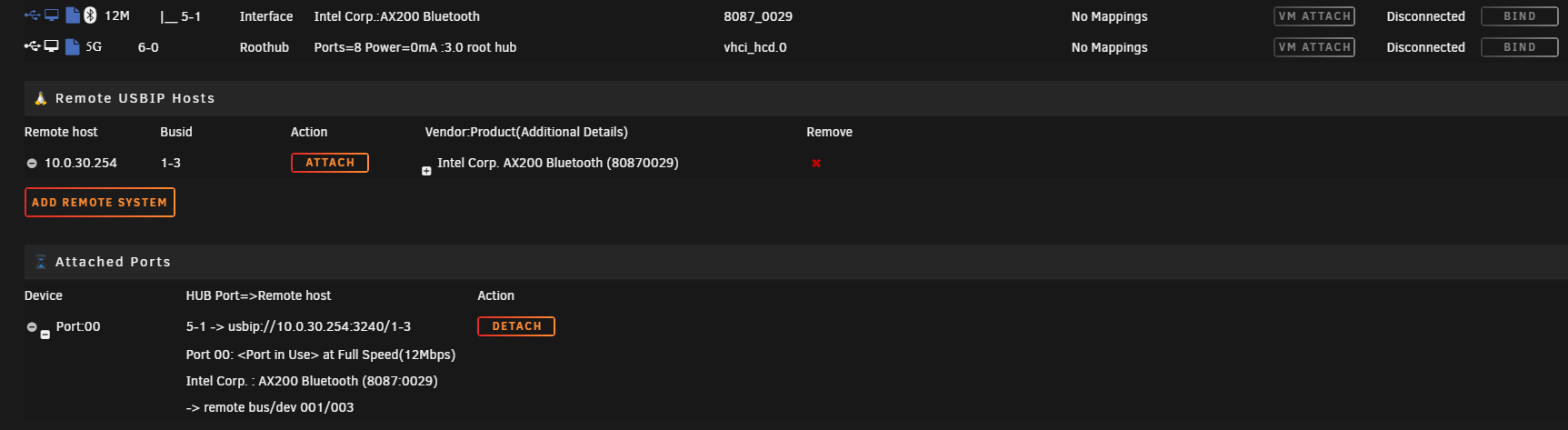

  5. Add the remote host under the USB tab in Unraid and then Attach the shared device.
  6. Check logs and determine driver being used? See my initial errors above.
  7. Install the iwlwifi-cc-a0-77.ucode driver from Intel directly to /lib/firmware and rename the (original driver shown in logs) /lib/firmware/intel/ibt-20-1-3.sfi to /lib/firmware/intel/ibt-20-1-3.sfi.bak.
  8. Attach the shared device again and should look something more like below.
  9. Map the path /run/dbus container to /run/dbus as Read Only in my Home Assistant Docker. (no need to passthrough the actual device).
On restart of the HA docker, the device was automatically detected in the Devices & services menu. And it immediately detected the Airthings Radon BLE device that I started this adventure over.
This is what my logs showed when successfully connecting.

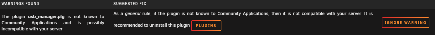

Has this plugin been delisted from CA? Fix Common Problems is showing this after upgrade to 6.12.8 from 6.11.
