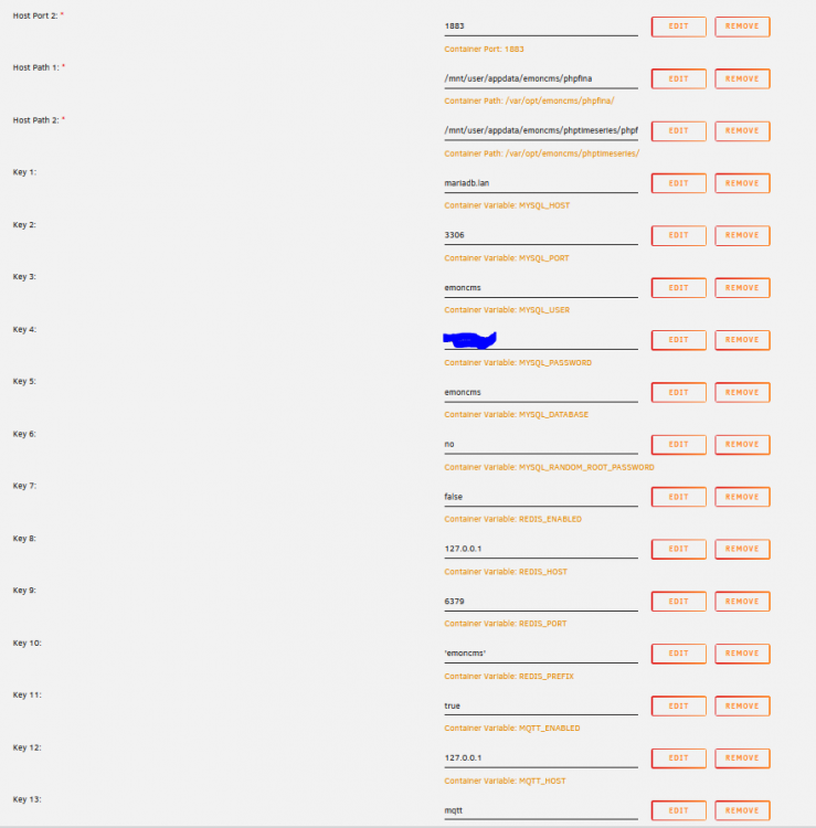

Still not got emoncms fully working. I do have inputs coming in via MQTT, and I can create feeds. It is also connecting to redis and mariadb dockers. But I can'tupdate it due to the error above, and I don't have most of the modules, eg. Sync or Schedule. Anyone any ideas? Cheers.

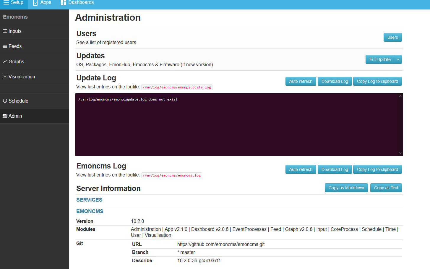

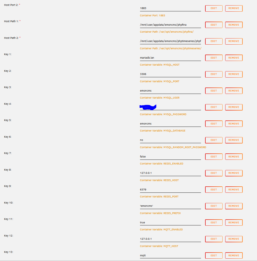

I now have it kinda working, connecting to a mariadb instance but I'm not able to do an update, and much of the left hand side menu is missing. Here's a couple of screenshots.
