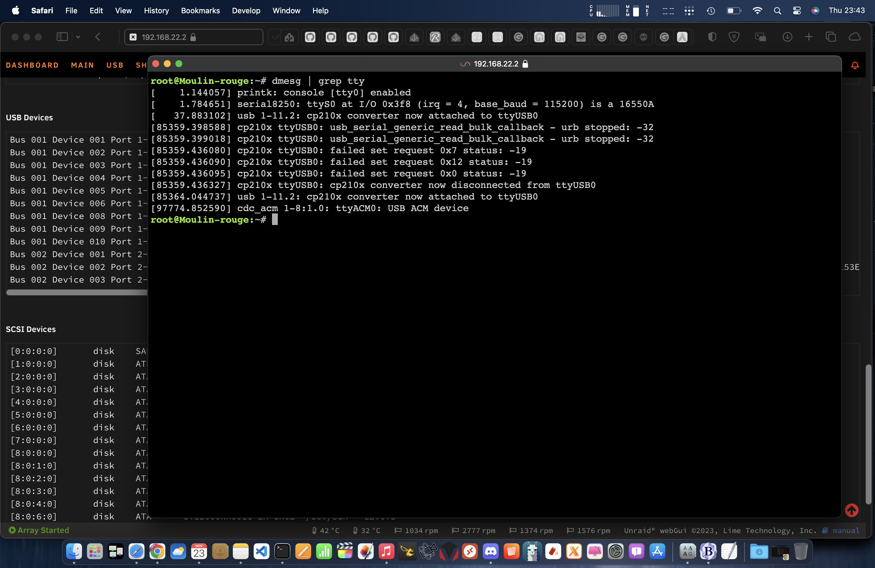

Am also trying to use a newer 'sonoff v2 E' stick as I going to try and flash it with the multi protocol firmware for matter & thread plus zigbee. It's showing this in the logs
Edited by dopeytree
Into a docker or VM.
is docker you can add --device /dev/serial/by-id/xxxxxx or for a vm you may need to add as serial interface rather than the whole usb. Conbee II has this issue also. If using USBM then you need to enable the serial switch.
root@computenode:/usr/local/emhttp/state# ls /dev/serial/by-id/
usb-0658_0200-if00@
root@computenode:/usr/local/emhttp/state# ls /dev/serial/by-id/ -l
total 0
lrwxrwxrwx 1 root root 13 Nov 23 20:11 usb-0658_0200-if00 -> ../../ttyACM0

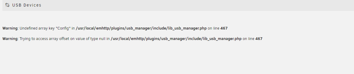

I've been trying to troubleshoot an issue where the usb page on the web ui won't load. Has anyone experienced this and/or have a fix for it? I've uninstalled/reinstalled, even went as far as restoring my flashdrive due to the drive being corrupt from a power outage. Any ports already previously configured for VMs still auto connect and work. I just cannot load the webpage to modify/add/remove port and usb device allocations to VMs.
Also, the hotpatching in the VM tab still works and the display on the dashboard still shows correct and updating statuses/information
Update:
I've identified an issue with the config file not updating correctly when I submit changes in the plugin settings. It prints out as such
start of file

No matter what the same addtional section is printed to the file. Even when deleting, manually editing the file, etc.
Edited by Muffins

Thanks for reporting, I have fix this error but should not have stopped the page from loading.
The cfg file is copied here any only updates the boot one when something is changed. /tmp/usb_manager/config/usb_manager.cfg
Thank you for the reply! I've been busy. I went and adjusted the config in the tmp folder as well. Once I go to the plugin settings, the same issue to the config happens again there as well. This issue does not occur on my other server, having issues troubleshooting it. I'll try completely removing the plugin and all cfg files, reboot and reinstall. Maybe something got hung up after I recovered the flashdrive that corrupted
If you are goto tool-> PHP settings are there any errors in the log? Is VM manager working ok?
This are all the places for config files. Copy vm_mappings.cfg if you want to retain a copy of the mappings. Remove the plugin and delete all of the files below(some may not exist) and then reinstall.

I have went a step further now after removing the emhttp usb.ini file. Right now I'm just combing through the config errors that showed up. I'll update following trying to comb through myself. Thank you so much!image.thumb.png.4f4dfc3a9f31d5e8096dd116249f66d8.png
If you have image.pngenabled this will stop the page loading correctly.
But those messages are warnings so should not stop the page from loading.
The selection has not made a difference in loading. I will share the php error when I have time to. Thank you again!

Greetings, all.  I have a Home Assistant VM running and I've been passing my Z-wave and Zigbee dongles to it successfully for a long time.  Now Zigbee2MQTT is getting twitchy, which appears to be an open issue with the newer versions and my hardware, but I am trying to minimize any hiccups.  As passing both dongles seem to work whether or not I map them both as ports, both as devices, or one of each (even though they both show as CP210N UART Bridges in the USB Manager mapping, my question is this:
Is one of those configurations preferable over the others?  Even when I pass as port I set the devices /dev/serial/by-id in Home Assistant, so it doesn't seem to matter but I just wanted to double-check.
