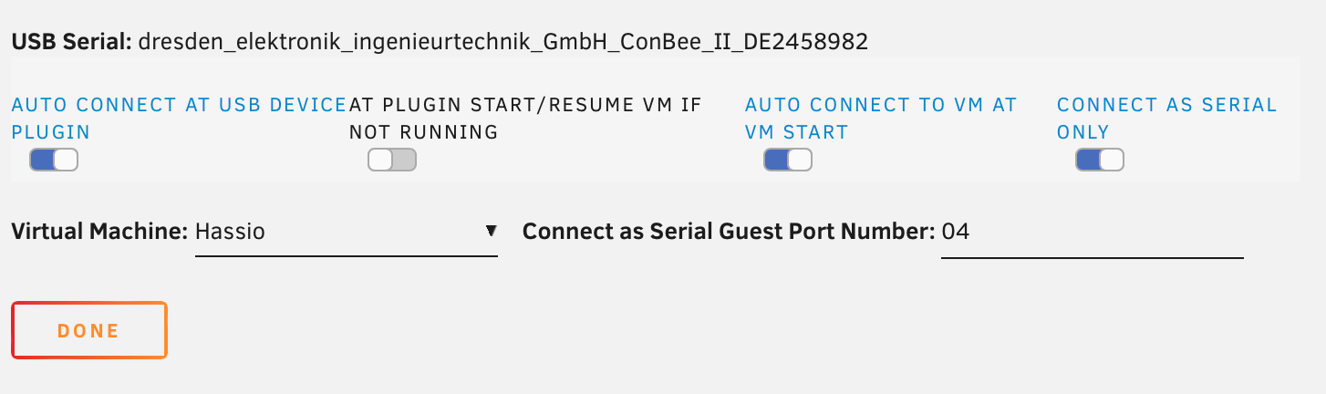

I have been having issues where my HomeAssistant VM will run well for several days. At some point the Zigbee USB stick will no longer be detected (or it has an error accessing it, HomeAssistant states "Could not open port ... no such file or directory" I've attached a screenshot).
I recently moved the pools on my cache drives, which my VM was on, from btrfs to zfs by moving all data to the array, reformatting, and moving the data back. This error has been happening since then, but everything else on the drive (docker) is working as expected.
During my zfs move, I did have issues moving the "/user/system/libvirt/libvirt.img" file, and found a post saying that it would likely be safe to remove as it would be recreated. Which it was, but I'm not sure if that is the reason these errors started. I see these in my USB Manager logs, which makes me think it is connecting and then becoming disconnected repeatedly until it stops.

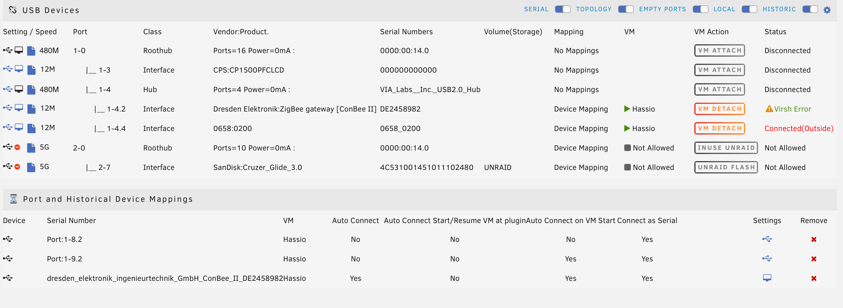

May  2 09:12:54 Tower kernel: usb 1-4.2: new full-speed USB device number 32 using xhci_hcd
May  2 09:12:54 Tower kernel: cdc_acm 1-4.2:1.0: ttyACM0: USB ACM device
May  2 09:12:58 Tower kernel: usb 1-4.2: USB disconnect, device number 32
May  2 09:12:58 Tower kernel: usb 1-4.2: new full-speed USB device number 33 using xhci_hcd
May  2 09:12:58 Tower kernel: cdc_acm 1-4.2:1.0: ttyACM0: USB ACM device
Edited by gustyScanner
What does the error message show if you put mouse over the virsh error
I wish I'd gathered that. For now, I have created a brand new VM of HomeAssistant and used it's backup/restore functionality to see if that solved the issue. So far, so good with the new image. If I see this with the new image I will definitely follow-up.

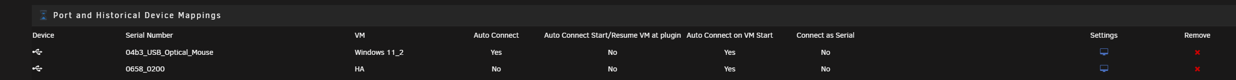

I have a powered usb hub (here) and connected a bunch of devices.  I then passed through all these devices with the plugin. However randomly some of the ports stop working all of a sudden and then I have to like restart everything and unplug and replug it in to get ti to work again. Only for this to happen again.  Is this a known issue with trying to hotplug usb hubs? Or do I have something not configured correctly? Thanks.
Can you provide more information. Maybe your syslog.
 cat /var/log/syslog | grep usb
 cat /boot/config/plugins/usb_manager/vm_mappings.cfg

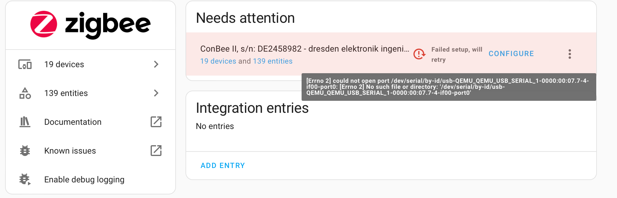

I run the Unriad VM Backup Pluging every week on Saturday Morning to ensure I have a good backup available for my 2 VMs.  These are for Blue Iris and Home Assistant.  A few weeks back Unraid was unresponsive after the backup should have run so I had to restart the server in the morning when I could not access the server.  It seemed to restart fine and performed a Parity check which found no errors.  I do not think the backup from that night had actually completed successfuully.
A week later when the backup ran it seemed to run fine and complete.  However when I checked in the morning all but one of the USB linked Home Assistant coordinators failed to start correctly and as a result my many of my devices and entities were unavailable.  These backups have been running successfully for months and have restarted after the backup with no issues.
I have 4 USB coordinators attached to Home Assistant.  One for ZHA, one for Zigbee2MQTT, one for Z-Wave and a Radio Reciever which collectes data from multiple device that transtmit @ 433Mhz.  The Z-Wave coordinator is the only one that restarts or reconnects when the Home Assistant VM Restarts.  All of these are connected as devices and have worked for over a year just fine.
THis week this same issue occurred with the same 3 devices not reconnecting when the VM Starts.  When I login to the Server I can Manually reconnect all 3 without issue.  I am simply confused why these 3 devices are not reconnecting automatically when the VM Restarts but do if I try to connect them manually after the VM is up and running.
Any thoughts on how to correct this???
