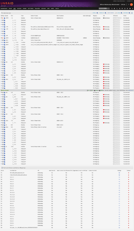

So it turns out that I can't bind any of the IOMMU groups with USB controllers to VFIO without crashing my BMC and stealing the ethernet from Unraid.
So I am now passing through USB ports using this plugin.
I have enabled "USB Hub Processing" but I could see now way to automatically assign "roothubs" to my VM (the little USB icon button is black for roothubs, and can only be clicked for ports). I have instead gone through and manually clicked on every single empty port and set it to automatically attach to the VM.
Is this the right/best way to go about getting my USB ports onto my VM (with hotplub support)? (I don't want hubs 1, 9, or 10 available to the VMs, though the ports for my keyboard and mouse will be passed through).
Screenshot attached.
Thanks for your help.

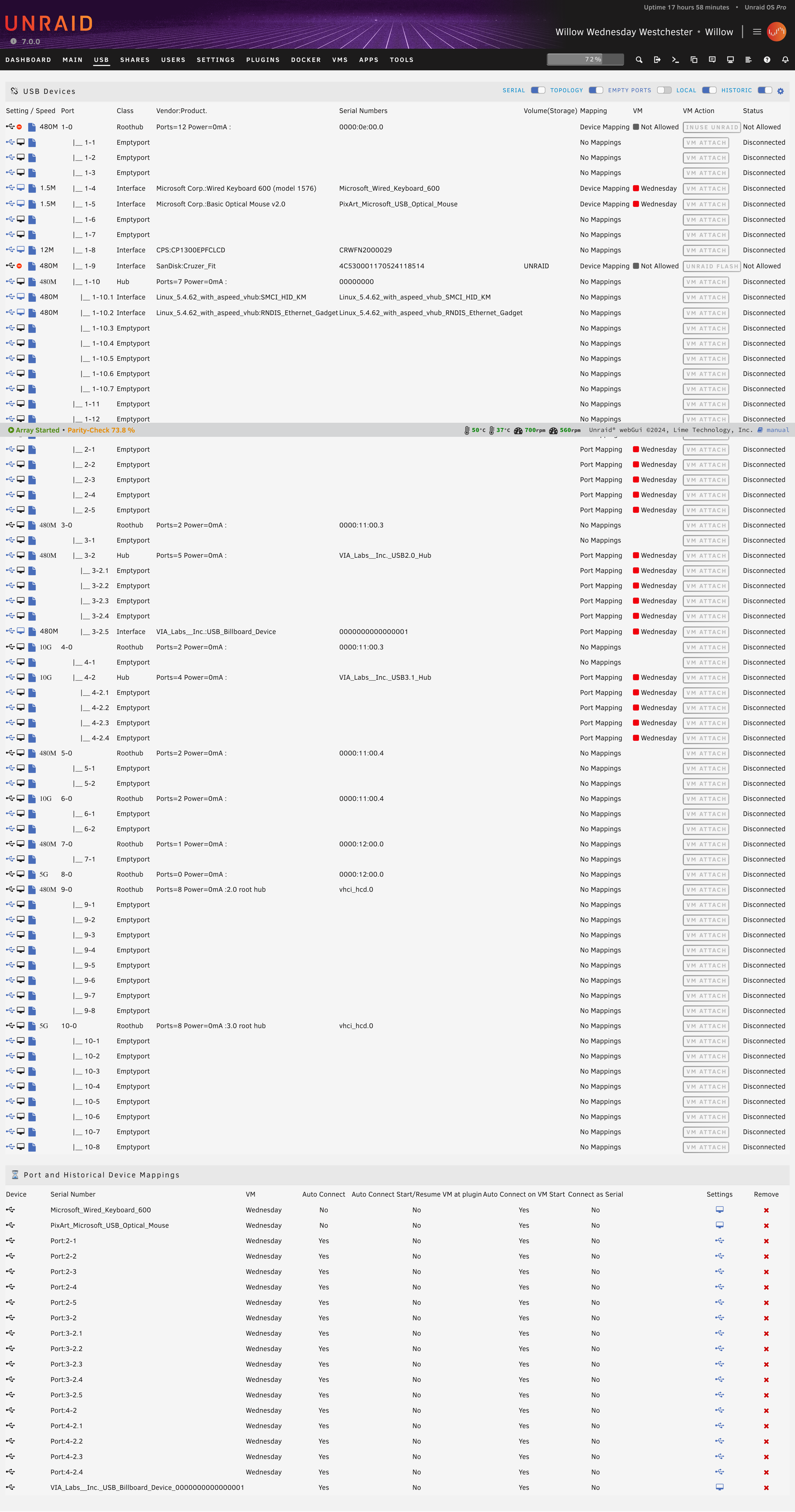

Hub processing is not supported on roothubs. It was put in place to support an external hub, i.e. in the monitor. I normally use device mappings as that will connect a device on any port. I then use a few ports for connecting devices to for ad-hoc requirements. Not sure what your use case for mapping that many ports.
Just so I can plug whatever device into whatever port, but I went overboard haha.
Your approach makes much more sense. I really appreciate your insight, thank you.

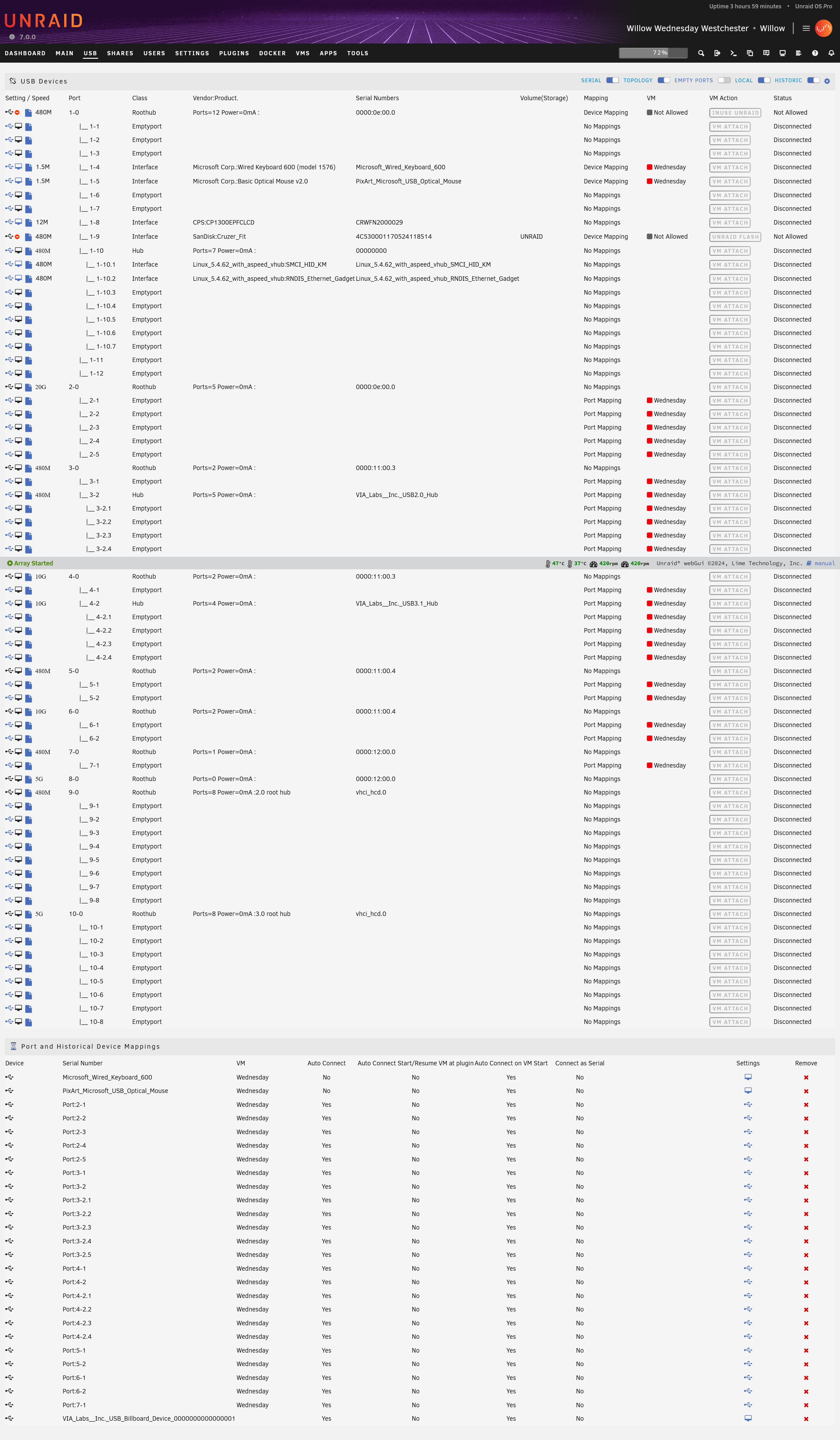

Another question: when assigning a Hub to a VM, do I have to also assign the empty ports? Or is the hub enough?
for eg, I want the Hubs that correspond to port 3-2 and 4-2 to always be assigned to my VM, but do I also have to assign 3-2.1, 3-2.2, 4-2.1, 4-2.2 etc as empty ports, or is their assignment done automatically when I assign 3-2 and 4-2 to the VM?
Screenshot attached (you can also see the 20Gbps port being passed through, which I do want).
Many thanks.
Just the hub. The way it works is it will read all the devices under the hub and connect to the VM at start if enabled.
