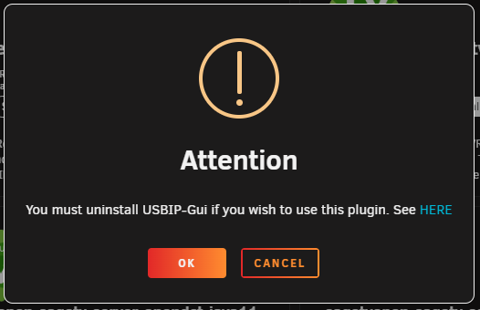

I just wanted to mention a deprecation UX issue that can probably be fixed fairly easily…
I got a notification today from Fix Common Problems that usbip-gui had been deprecated. Following the instructions I got to USB Manager, and when I tried to install it, it said it was incompatible with usbip-gui and said “You must uninstall it first” or something like that. It also linked to this comment, which I read and saw, yes, said you must install it—but that the configs were compatible. So I decided I’d make a backup first.
I returned to the UnRaid GUI to see where the config was, but first I had to dismiss that message from when I tried to install USB Manager, so I clicked “OK”. Oops. It deleted usbip-gui and installed USB Manager (presumably, deleting the deprecated config at the same time?).
I think the problem was that I had an expectation that Unraid’s plugin system doesn’t really make room for: there’s a general consensus in UI that action-gating warnings should never have both an “OK” and “Cancel” button, since it isn’t clear what “OK” means in that context. It’s usually advised to either have a single button to do nothing but acknowledge the warning until the thing being warned about is fixed/forced elsewhere (it doesn’t really matter whether it says “OK” or “Cancel”—whichever makes more sense with the wording of the message), or the buttons should change to “Proceed/Force/Yes, really do it/Delete all my files/etc.” and “Cancel” (preferably with the order of buttons reversed and default swapped, so that someone on autopilot will cancel).
(Sometimes an alternative used is an “I understand, proceed” checkbox that must be clicked to make the OK button do something other than cancel.)
Simon, given you can’t change that UI, I think you tried to make the best of it with your warning and link, but I think the wording strongly implied that the USB Manager plugin would not install until I had uninstalled usbip-gui first. So I was surprised when it did—hopefully I won’t have unexpected issues as a result.
My suggestion would be just to change the wording (I didn’t take a screenshot so I can’t see it now, going from memory) from “You must uninstall usbip-gui first” to something like “If you continue, usbip-gui will be uninstalled. Make a backup of your configuration first: see HERE.”
I know that usually you don’t get anything at all when you hit “Install” from the plugins list before installation just happens—but I still think in this case a little more is needed.
(If I’m misremembering, and the buttons say “Install” and “Cancel”, or the warning didn’t say ‘you’, then my bad—but it just now happened, so I think I’m recalling correctly.) Thanks!

This is what you saw:
Now, it's actually nothing to change the OK to be proceed, but what does "Proceed" actually mean?  Hitting OK or "Proceed" goes and does the installation while cancel gets you out of it.
I could infer that either Proceed or OK would go ahead and uninstall.  How about instead say "Install" instead of OK
Ah—our messages crossed! Yes, if you can change “OK” to “Proceed” as well, please do! I wasn’t sure the flexibility there. But the main thing would be to change “You must uninstall…” to “USBIP-Gui will be uninstalled in order to use this plugin. See HERE.” With a message to backup the config if it fits as well.
CA will NOT uninstall anything as part of an installation.  So far as I understand, you must uninstall USBIP-GUI manually as the replacement does NOT uninstall it either.  Therefore the message is correct.

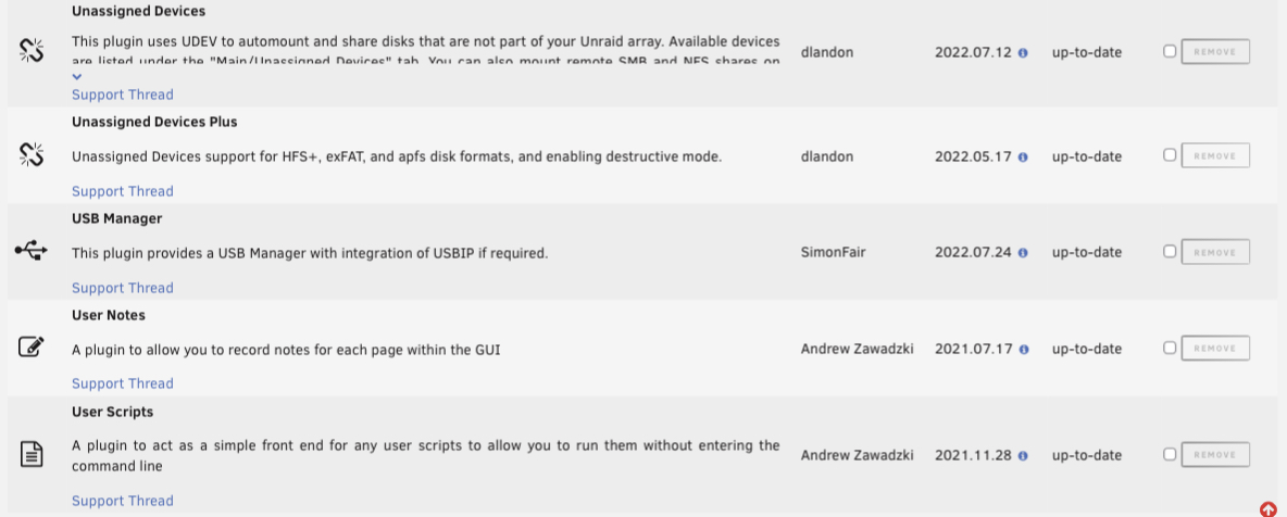

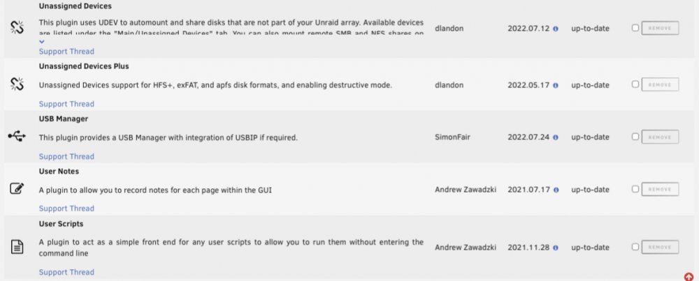

@SimonF and @Squid:
Ok, I don’t know how to resolve this. I can assure you, with 100% certainty, I did not
1. See the dialog message posted above (“You must uninstall USBIP-GUI…”)
2. Open a second web tab to UnRaid
3. Uninstall usbip-gui
4. Go back to the tab in step 1, and click “Install”
But unless I misunderstand you, I hear you saying if I did not do steps 2 and 3 (or the equivalent at the CLI) then 4 should not have worked and/or usbip-gui should still be installed.
But this is not the case. What’s going on here? Again, if the install logs are saved somewhere let me know the pathname and I’ll paste it in; I am 95% certain it wrote “uninstalling usbip-gui…” before continuing with the install.
Edited by TreyH
removing dupe quote

Checking the contents of the dir for anything starting with ‘u’ or including ‘usb’:
root@NAS:~# ls /usr/local/emhttp/plugins | grep -i '^u' unRAIDServer/
unRAIDServer/
unassigned.devices/
unassigned.devices-plus/
usb_manager/
user.scripts/
ls /usr
root@NAS:~# ls /local/emhttp/plugins | grep -i 'usb'
usb_manager/
Looking at the scripts in usb_manager/, I see there’s a $docroot variable set as
$docroot = $docroot ?: @$_SERVER['DOCUMENT_ROOT'] ?: '/usr/local/emhttp';
that is later used in ./event/stopping_svcs:
#!/bin/bash
DOCROOT=`grep -Po '^chdir = \K.*' /etc/php-fpm.d/www.conf 2>/dev/null`
if [ -z ${DOCROOT} ];then
        DOCROOT="/usr/local/emhttp"
fi
logger "Stopping Daemon(USBIPD)" -t"unraid.usbip-gui"
${DOCROOT}/plugins/usb_manager/scripts/rc.usb_manager stop_daemon
#logger "Detach All USBIP Devices..." -t"unraid.usbip-gui"
#${DOCROOT}/plugins/unraid.usbip-gui/scripts/rc.unraid.usbip-gui detach_ports
suggesting to me that if usbip-gui were still installed, I should still have a /usr/local/emhttp/plugins/unraid.usbip-gui directory—but as shown above, I do not.
Sorry error on my part it does remove the plugin. I think the message was added before it automatically migrated @SquidI think you can remove that message now.
Okay, perfect. Yes, that comment link would lead one to believe migration and old-plugin deletion isn’t automatic, so it gave me a scare.
Thanks for running this one to ground!
done
