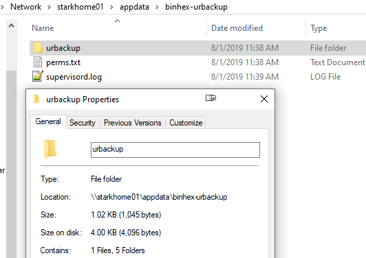

  6. Correct, there are folders however of the four folders within the folder only the config folder has anything and it is one file. The urbackupsrv. Would I be correct in assuming that there should be more files?
  7. Sorry, I should have specified that the screenshot was from after deleting the folder from appdata, but before reinstalling the image. The folder was created when I hit apply. I did however go ahead and run the command. ~# ls -al /mnt/user/appdata/ total 16 drwxrwxrwx 1 nobody users 202 Aug 1 10:06 ./ drwxrwxrwx 1 nobody users 52 Jul 31 15:16 ../ drwxrwxrwx 1 nobody users 62 Dec 1 2018 MakeMKV/ drwxrwxrwx 1 nobody users 20 Dec 1 2018 PlexMediaServer/ drwxrwxrwx 1 nobody users 12 Dec 13 2018 QDirStat/ drwxrwxrwx 1 root root 22 Jul 28 13:28 Shinobi/ drwxrwxrwx 1 nobody users 96 Dec 31 2018 Sync/ drwxrwxrwx 1 nobody users 96 Dec 31 2018 SyncWan/ drwxrwxr-x 1 nobody users 64 Aug 1 10:02 binhex-krusader/ drwxrwxr-x 1 nobody users 64 Aug 1 10:07 binhex-urbackup/ drwxrwxrwx 1 nobody users 80 Jun 26 23:27 clamav/ drwxrwxrwx 1 nobody users 44 Jul 19 20:44 grocy/ drwxrwxrwx 1 999 users 6642 Jul 31 15:29 mongodb/ drwxrwxrwx 1 nobody users 110 Dec 1 2018 unifi/

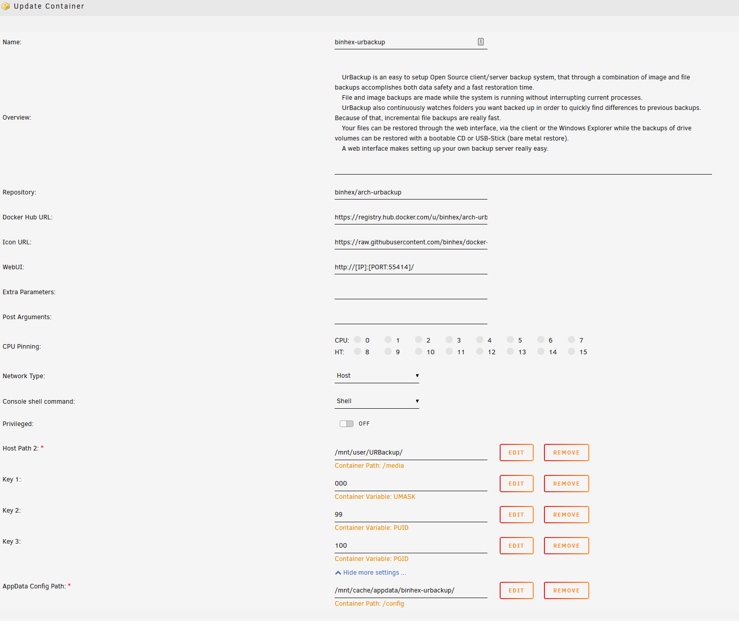

  8. I deleted the image from appdata, and re-downloaded the docker and left everything default with the exception of pointing /Media to an empty share. Still having the same problem. I have attached a screenshot of the config. ur docker log.txt
