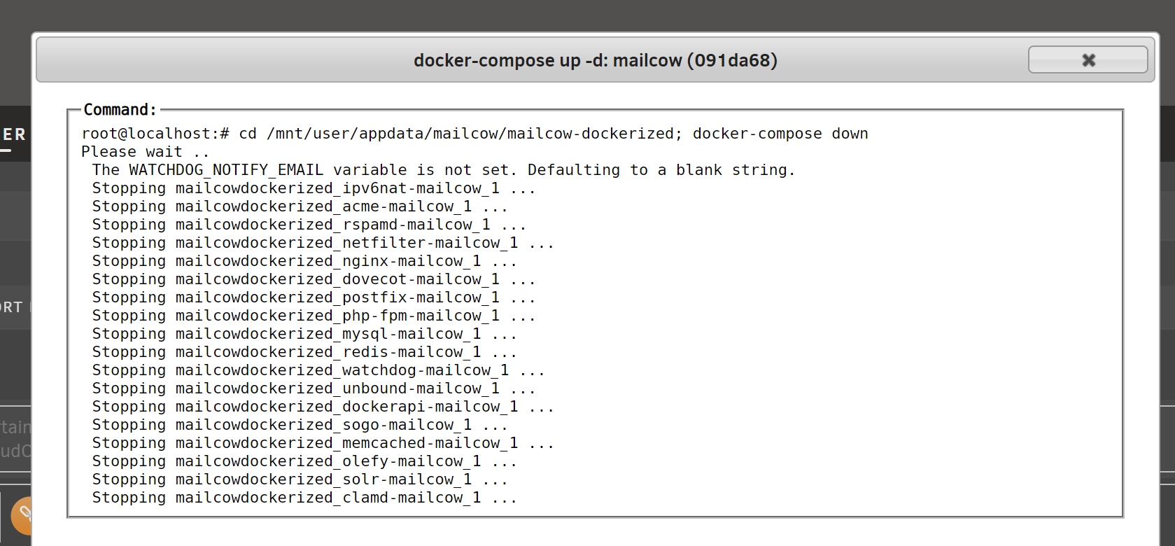

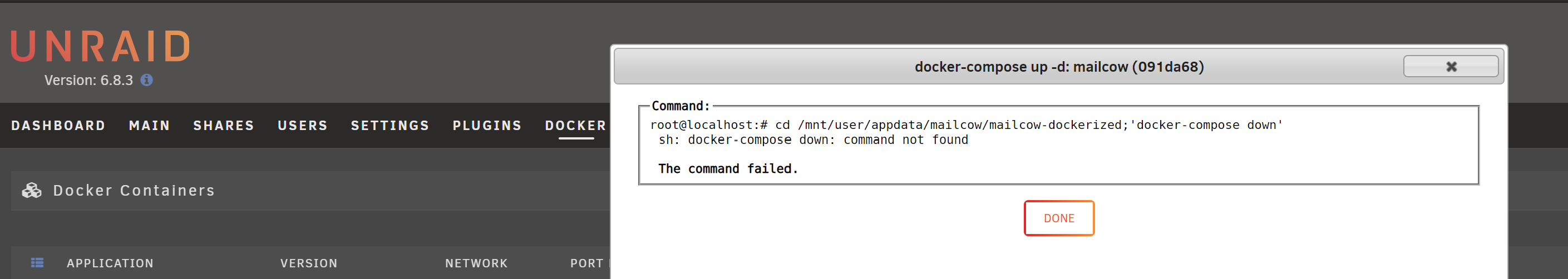

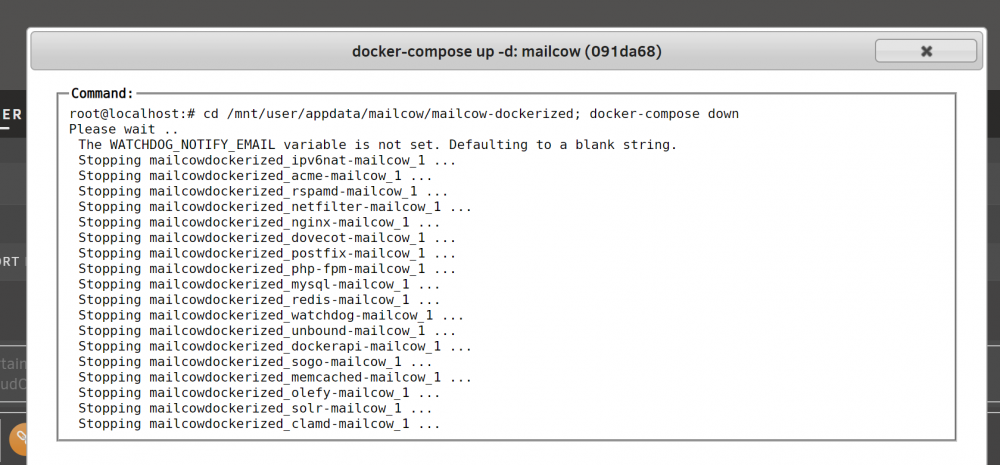

It is written so, but in fact the team does not work, and the Compose does not stop.

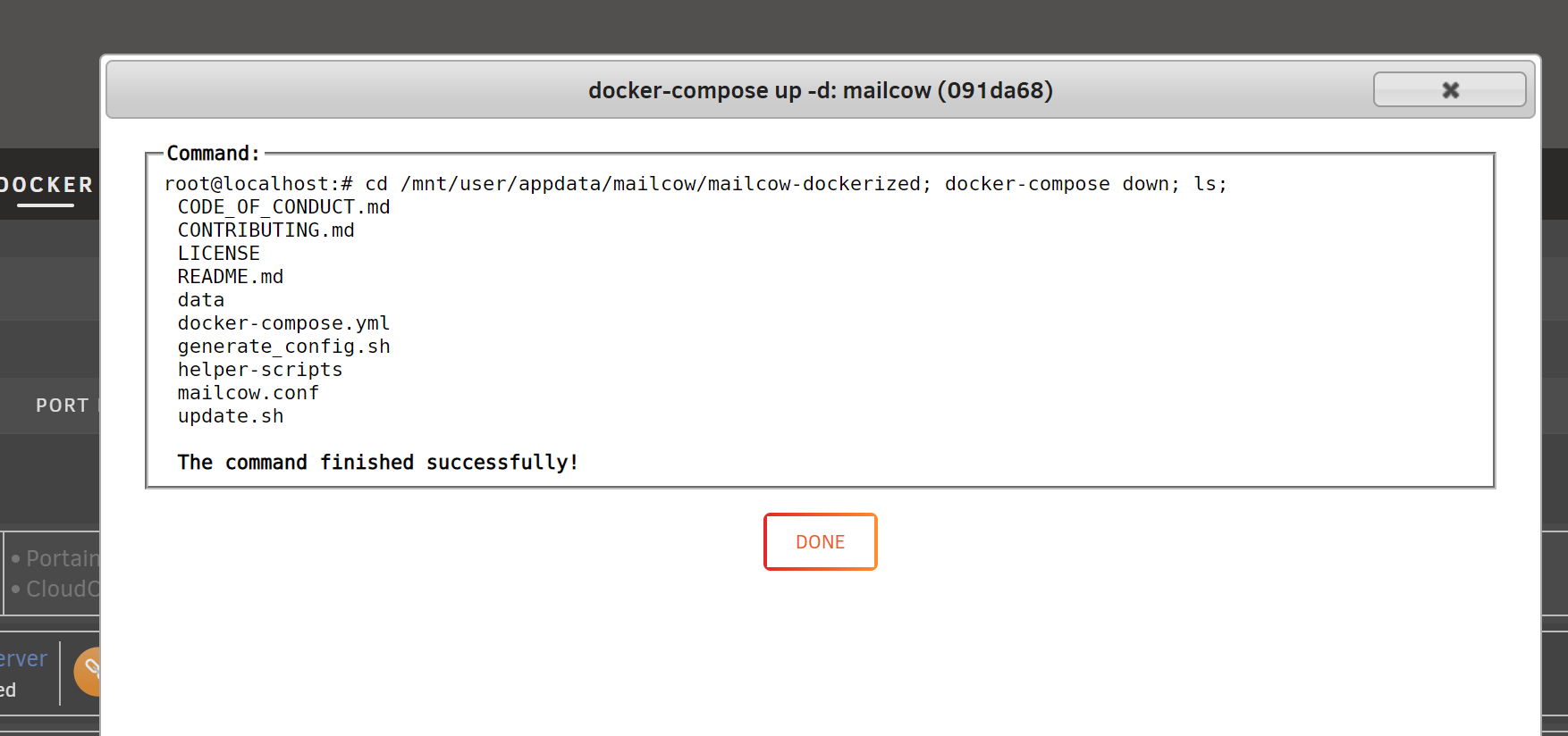

i think its only running the cd command not the docker-compose command.

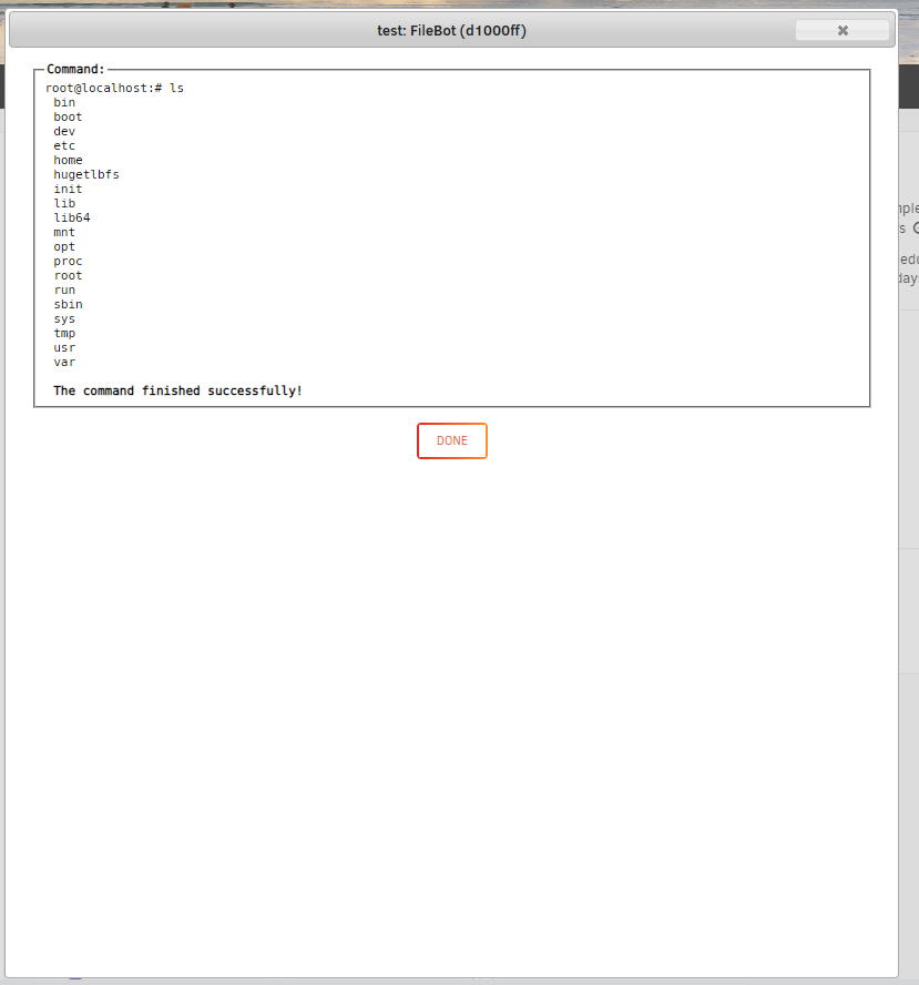

Played a bit and got it to work without ";" at the end.
cd /mnt/user/appdata/mailcow/mailcow-dockerized; docker-compose down
Why it breaks with ";" at the end is beyond me as it works if you do e.g ls; instead of docker-compose; o.O
Played a bit and got it to work without ";" at the end. Why it breaks with ";" at the end is beyond me as it works if you do e.g ls instead of docker-compose :/
I don't understand how it works....

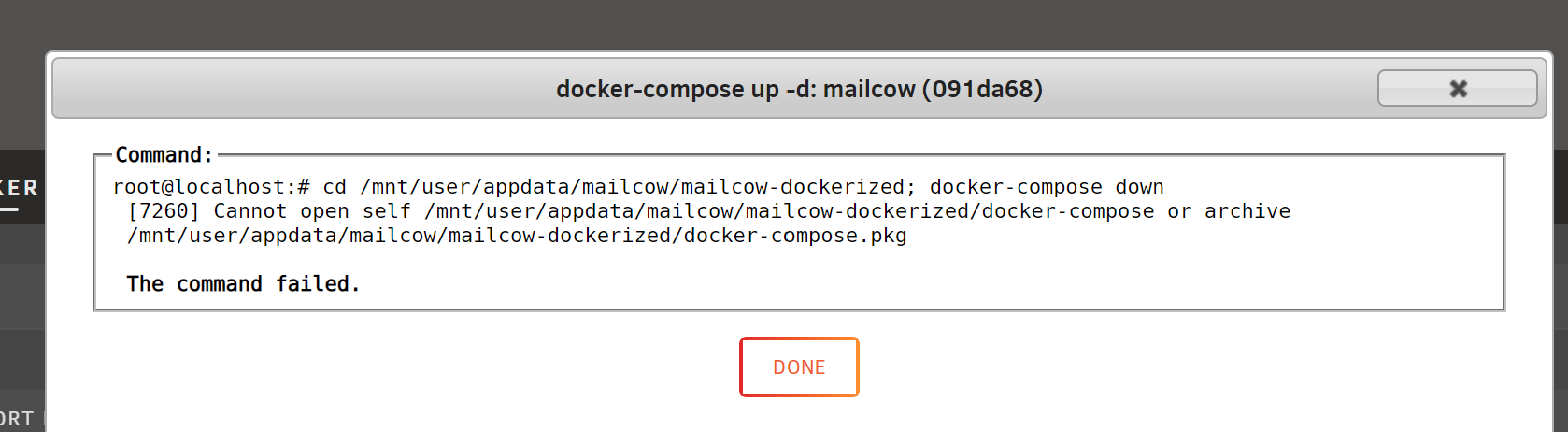

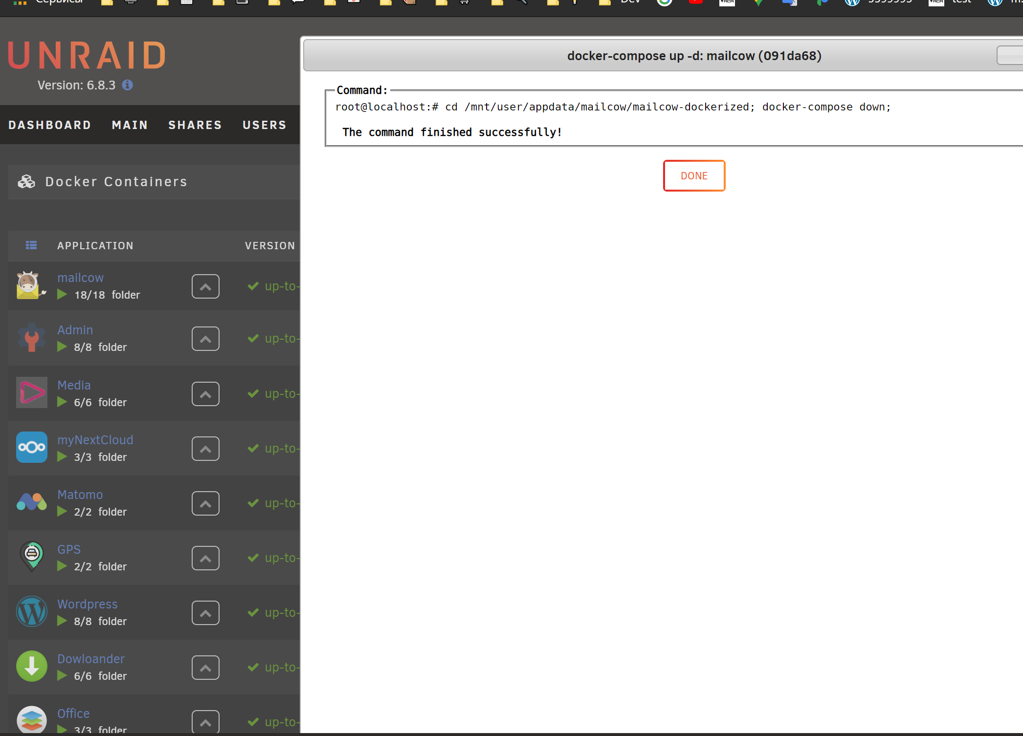

She doesn't seem to understand the gap? In the docker-compose team down
______update
Now he kind of understands the gap, but the problem remains, the team doesn't start
Edited by muwahhid
Okay so looks like a permission issue or something. Here is a github issue about it https://github.com/docker/compose/issues/1135
Now to fixing it
1. uninstall docker-compose 'rm /usr/local/bin/docker-compose'
2. install nerdpack if you dont have it
3. in nerdpack install python3, python-pip, python-setuptools
4. run pip3 install docker-compose
Doing this fixed the error for me hope it works for you. Why installing docker-compose with curl does not work with the bash action is again beyond me :)
Now to fixing it
It's working, thank you!!!!!))

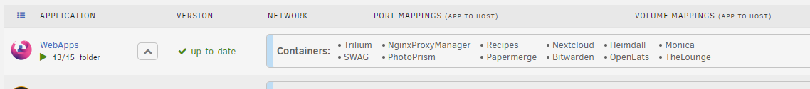

Is there a way to make it display more containers? It only shows 12 but I have 15 containers in this folder.
I'd like a way to see them all in the text list (there's some free space to the right still, or can add a 3rd line with a toggle option in settings to show overflow?)
I use the text list to click on them and restart/update/edit, etc.
Thanks in advance!

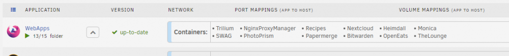

Thanks in advance!
Added a config option for row and column count ^_^

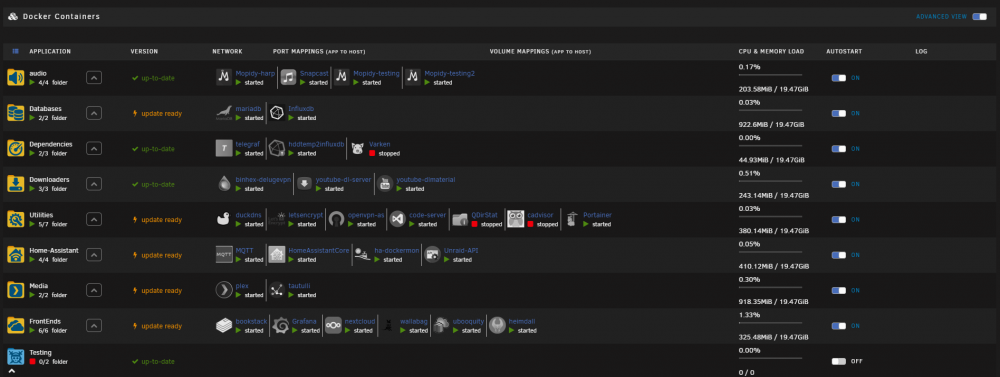

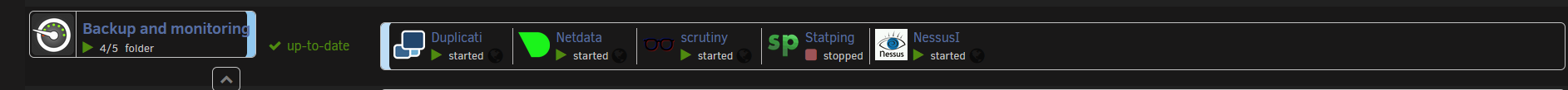

How can I make mine looks like this one
Mine is like this I still have the label tab view on the dockers
On the other hand with the label tab view when the name of the folder is "large" it mess up everything, there could be an option to change the size of the text to have a perfect fit

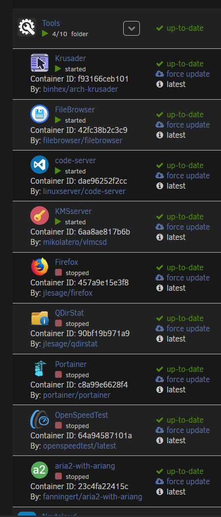

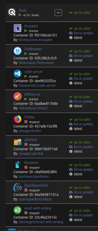

And there is a bug it shows 4/10 but I only have 9 dockers in this folder
Edited by L0rdRaiden

I think this screenshot was taken before label tab was a thing so there is no option for preview style.
will add a option to change the style
Try and edit /boot/config/plugins/docker.folder/folders.json then find the tools folder and under children remove the one thats not showing.
you could also remake the folder. The bug that makes this happen should be fixed so should not happen again :)

I think the error happens when you change the name of a docker already in the folder, the plugin keeps both names.

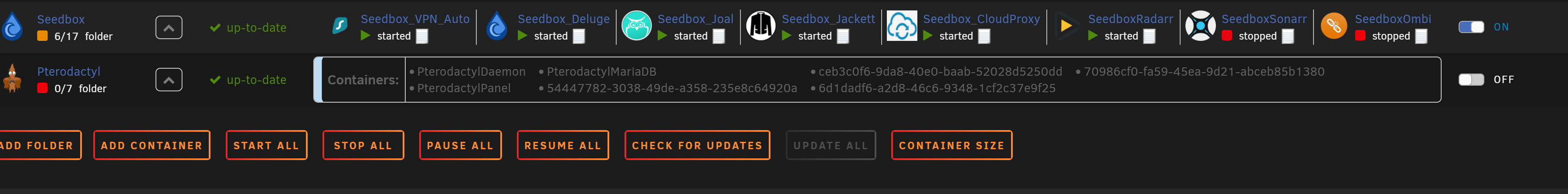

Why is not possible to add a column count in "Icon Basic" & "Icon Label", is just possible to "No Icon" privew mod.
Thanks.
Thanks.
The reason that's not an option is that i calculates how many i can show before you would have the scroll horizontally.
Think i might have mixed up column and row in the settings (i cant never remmber which is which) :/
if you want i can add an option for it?
tho there would have to be some horizontal scrolling as far as i can tell
