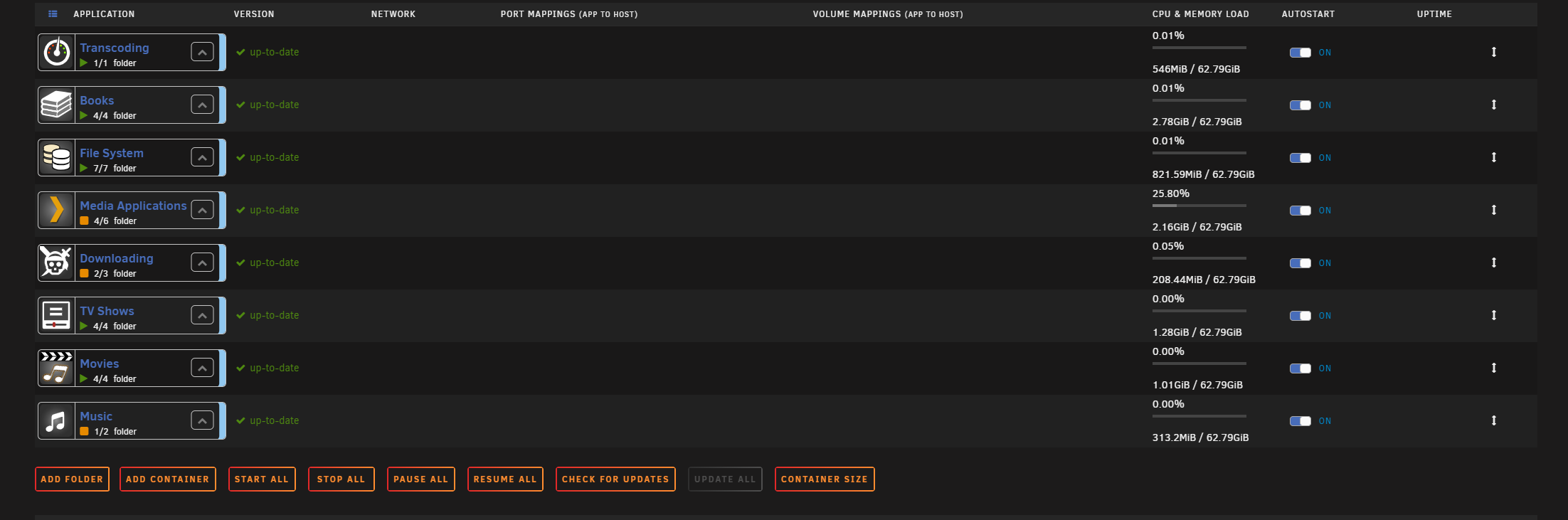

is there a way to rearrange the order on the dashboard? I rearranged the order on my main Docker tab but it doesn't seem to carry through to the main dashboard page
Odd that its not the same on both pages, could you try and reset sort order on the docker page maybe that might help
Just tried that, didn't change anything.

Could you check if if /boot/config/plugins/dockerMan/userprefs.cfg matches the sort order of the docker page or the dashboard?
Also are all you containers in folders or are there some that are not maybe a screenshot of your dashboard might help me :)
Sorry about the confusing edit of my last post thought i had reproduced the issue but after a refresh of the page it was fixed :(
how do i open that .cfg file? i tried to navigate using Midnight Commander and Krusader but was not able to access file (MC gives me permission denied; Krusader shows /boot/ as empty).
all my containers are in a folder. See here for screenshot.

Dont think you can using Krusader dont know why tho, i have /boot mounted as a smb share for easy accesses, but you could use the terminal.
Whats interesting is that in your screenshots the folders themselves have the same sort order but its the containers inside that is messed up. Do you use the "Start expanded on Dashboard" and "Start expanded on Docker/VM page" or did you do it manually for the screenshot?
PS: nice screenshot made it really easy to see the issue :)
Edited by GuildDarts

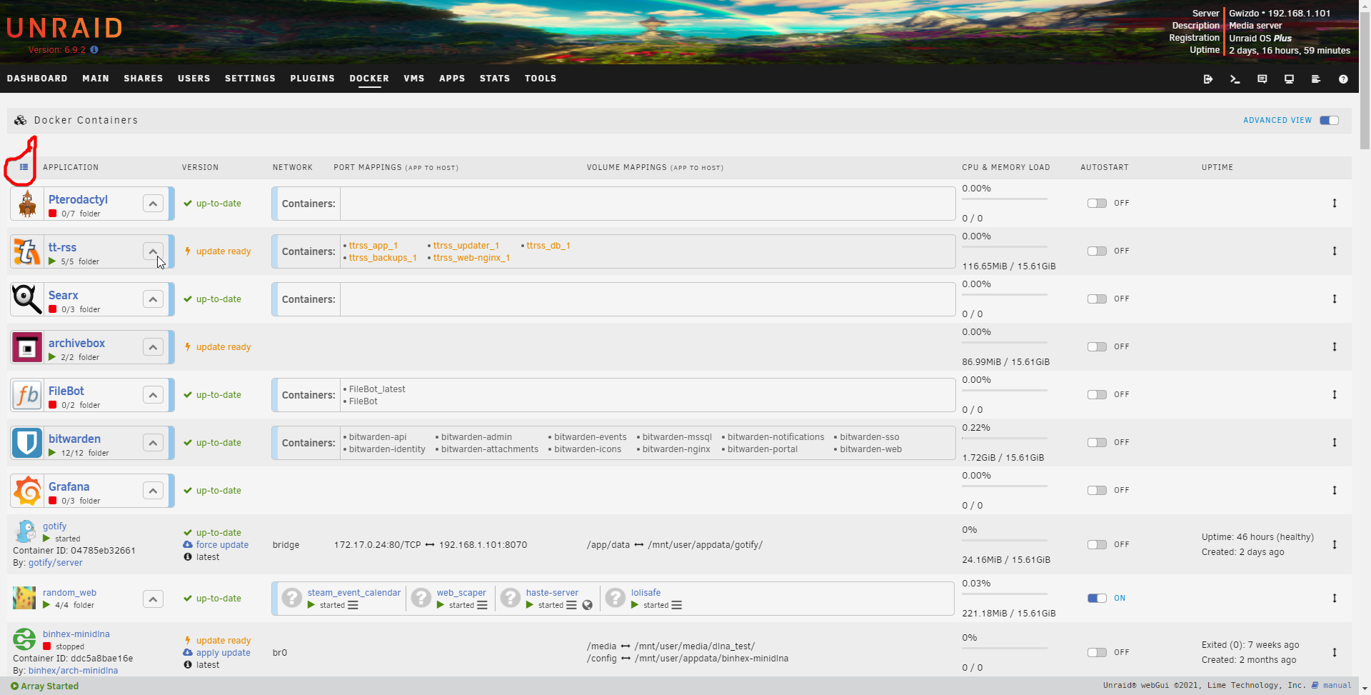

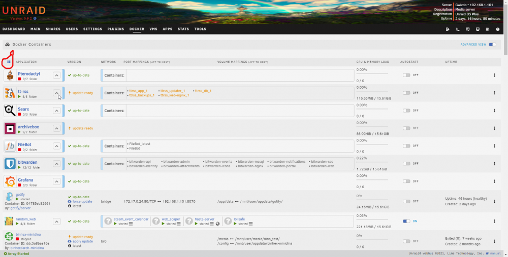

So a few minutes ago this started happening with the docker folders. Image below.
I have uninstalled the plugin and reinstalled it and it just stays like this. Let me know if there is any other info you need to help me with this.
Never mind i figured it out and its now displaying the way it was before.

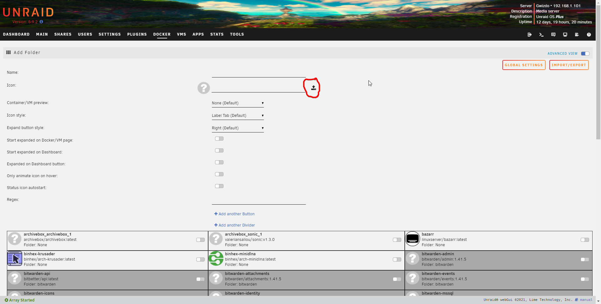

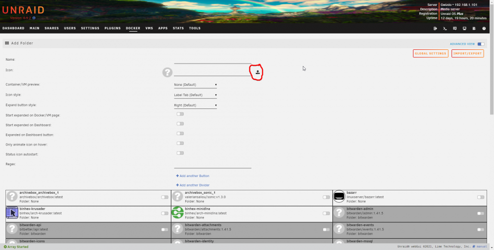

Ok, I must be missing something obvious. How do I upload the icons to the sever so that the "pick" button will work?
I want to upload them all so I don't have to copy/paste URL's everytime.

You can press the upload button and upload for that one folder, there is no way to view all your uploaded folder icons.

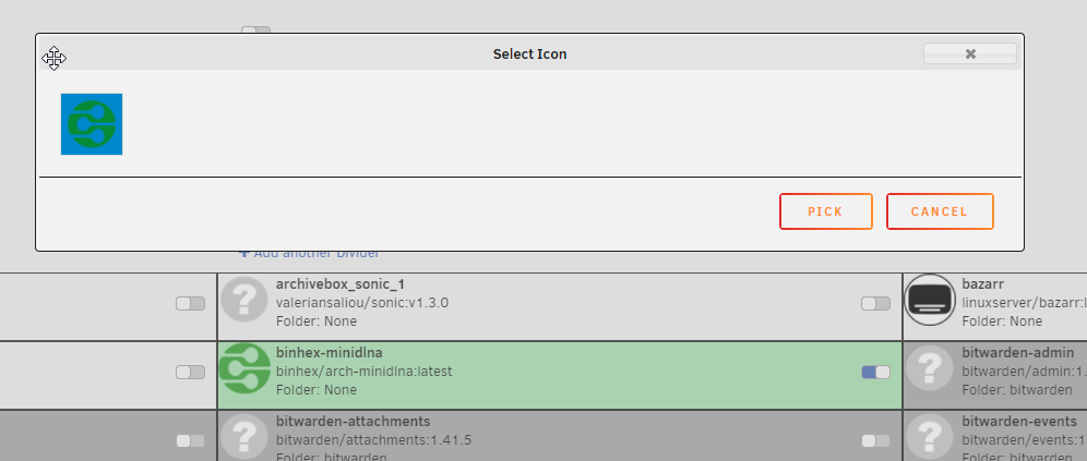

If you click the icon on the left of that box it pulls up a menu that seems to be an icon selection box with a pick and cancel button.
Seems to be a menu to select from locally stored icons (which makes total sense).
What is that menu for if it is not for picking icons?
Ah, that menu shows a selection of icons for the currently selected containers/vms
Maybe i could expand that menu to have one page for the currently selected containers/vms, another for all your uploaded icons and one showing the icons for the icon collection
Ah I see. Yeah either adding another page or a section below those with icons that can be uploaded to the USB would be fantastic.
Call me old school but I like to have everything possible local. Plus it is just simpler and quicker.
If you wanted to add the ability to browse local icons to individual dockers as well that would be cool. I tend to do a lot of custom containers and it is annoying to do the icons right now.
