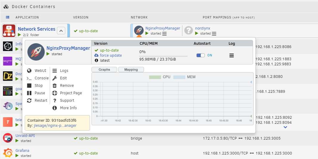

    Hi, I've been working on fixing the plugin for a while, and I have something that works, but there are some problems. Due to how I made unraid show the folder on the dashboard "Expanded on Das
  • Docker Folders has now been deprecated when running Unraid 6.12.3+  It should be uninstalled and replaced with Folder.View
OK.
Not that I use this plugin, but I have forked it so that the logs and the context menus appear.
I have temporarily removed the dashboard part of things until I get more time to look at it's display aberrations.
Going forward, so long as explicit directions are made as to how to replicate issues on 6.10 I will attempt to fix, but no guarantees will be made, and my goal here is not to continue development on this plugin, but to simply keep it in the same rough state as it was left in when the author stopped development.
You will need to uninstall the version from Guild Darts and then reinstall the forked version.  I would suggest making a backup of the folder.json file within /config/plugins/docker.folder on the flash drive.  If you don't do this, then you will need to recreate your folders.

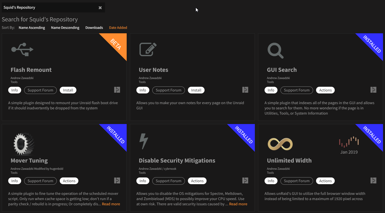

12 minutes ago, Groto said:
it won't show up in community apps
It's in CA.  The original won't show because it's now marked as incompatible, and the fork shows (GuildNet/Squid as author) when running 6.10+
What a champ! Thanks very much.
I'm not sure what's up, but I'm on 6.10.0-rc8 and I'm not seeing it no matter what I search for in community apps (version 2022.05.15) :(
Searching for "docker folder" comes up with totally irrelevant results and searching for your repo only shows your other awesome work!!
Y
Probably because you have not updated to 6,10.1 stable and so your Unraid version is too old.
7 hours ago, Groto said:
 Can you clarify what you mean by doing from the sidebar worked? I am trying to understand how to install this since it won't show up in community apps since it is a fork. Thanks!
@Groto it doesn't matter that it is a fork, community apps repo was updated to include this, will show only from unraid 6.10.0 and above.

The context is fixed.
Thanks a LOT ,Confirm working on 6.10.1 .

@Squid Thanks again For fixing plugin all working Fine , but i missing the Webui Globus button near the log ,its not fixed or only i have the problem?
button was after unraid first boot but after refresh page is missing ...
Try the update
I never realized how much I like this plugin until it didn't work. Thanks for the fix! @Squid
2 minutes ago, Squid said:
Try the update
Now its OK, Thank you so much !

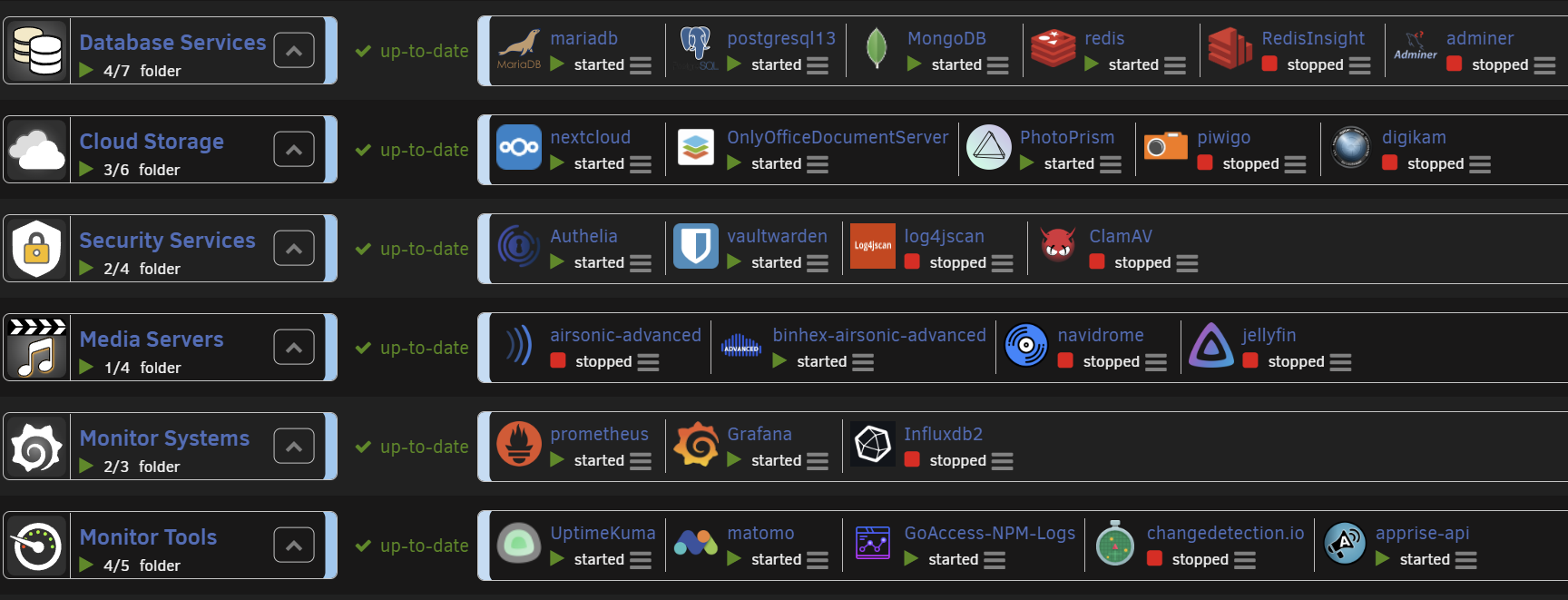

Since updating to the fork, folders do not show up on my dashboard anymore - just the standard big list of containers. Anyone else? I initially updated directly. But then I removed the plugin, rebooted, reinstalled the plugin and created a new folder - same result, folders do not show up on the dashboard.
Edited by crafty35a
That was mentioned by @Squid it is currently disabled by purpose since it does not work correctly and is kind of a hack of the dashboard system (I tend to agree with that)
