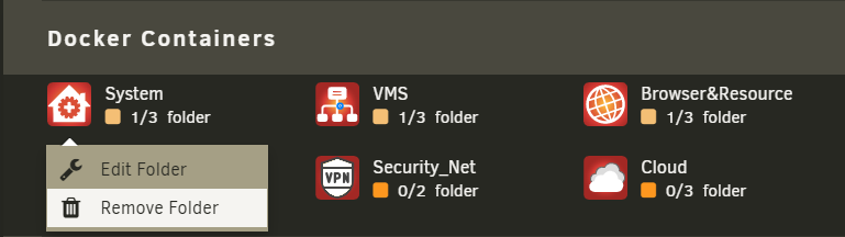

Function Suggestions
Could create a drop-down menu in the Main menu?
To make it easy to see all container status

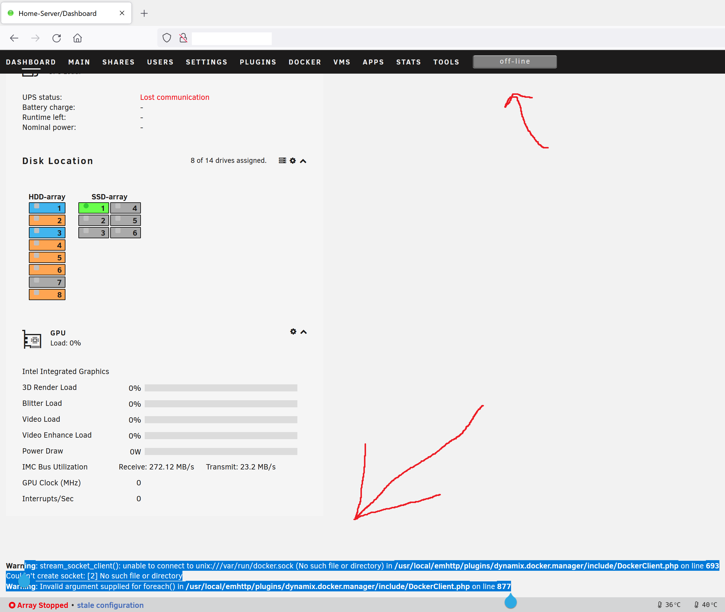

I am getting the following error since a while now, I have reported it already but it wasn't fixed yet.
Has anybody looked into this yet?
It only appears when using this plugin, if I uninstall it, this warning message goes away.
(See screenshot below)
Also It is only shown when the array is stopped (and thus the Docker Service is also stopped).
Then I see the following warning message at the bottom edege of the Unraid Dashboard:
Warning: stream_socket_client(): unable to connect to unix:///var/run/docker.sock (No such file or directory) in /usr/local/emhttp/plugins/dynamix.docker.manager/include/DockerClient.php on line 712
Couldn't create socket: [2] No such file or directory
Warning: Invalid argument supplied for foreach() in /usr/local/emhttp/plugins/dynamix.docker.manager/include/DockerClient.php on line 898
After the array is started the warining message goes away.
Do i have to worry about this warning?
I would think this is a false positive, as the docker service is not started yet, as the array is also not started at this moment. So can i ignore it?
I have first noticed this warning in 6.9.2 (with the original Docker-Folders-Plugin), but it is still persistent in 6.11.5 with latest Docker-Folders-Plugin.

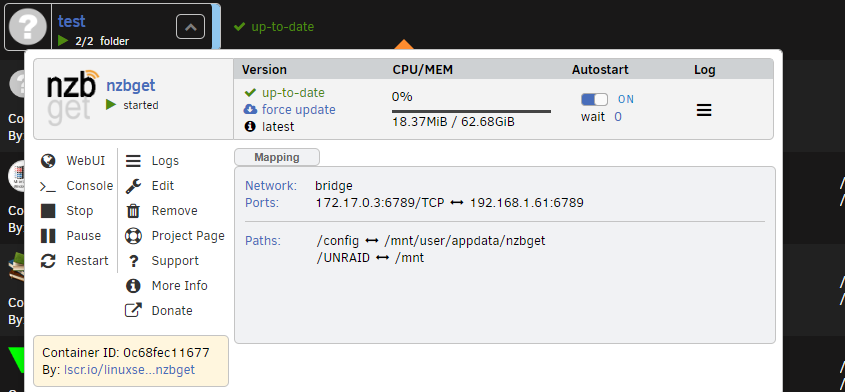

I've got it now working on the docker tab in 6.12.  Trying to figure out what's going on with the dashboard hacks.  VMs I don't see being an issue.  Should have an update for this early next week
Great to hear. If you need someone to test, i am willing to help, just message me then :)
Looking forward to this plugin being updated for 6.12. Docker list looks ugly :(
Update is now available for Docker Folder.
Note that this only fixes the issues on the docker tab and the VMs tab.  Folders are not currently available on the dashboard.  (ie: Interim compatibility fix for 6.12)

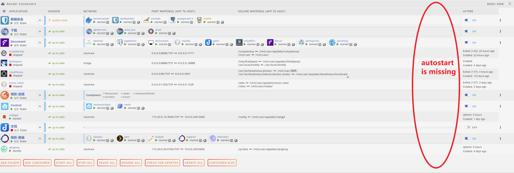

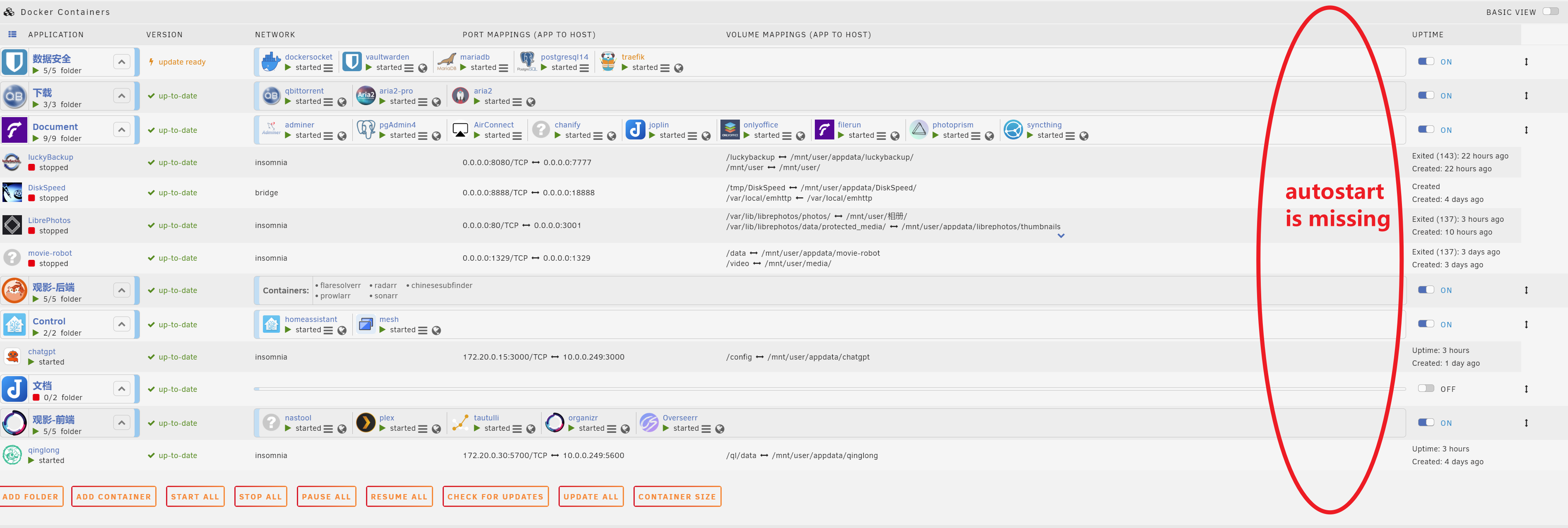

6.12 RC2 works , but command 'autostart' is missing
No idea what you're talking about
10 minutes ago, Squid said:
不知道你在说什么
这个界面是在的,最右侧的不见了,
i have the problem.
if I change the order of the folder, it is not saved and when I reload the side the order is like before.
but i don't know it is a problem from the plugin or the 12RC2

Hey, i am having another issue on 6.12 (any RC). I am missing the option to autostart containers, i can autostart whole folders, but no the containers (i think the toggle for it is off screen, cause everything is quite missalligned.
