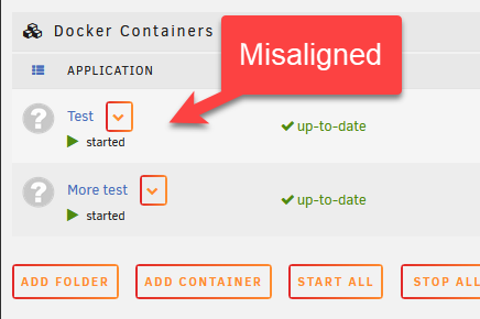

Just for info, some minor UI things

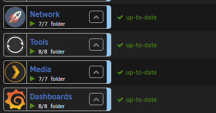

The drop down menu's misaligned:
when compared to the old version

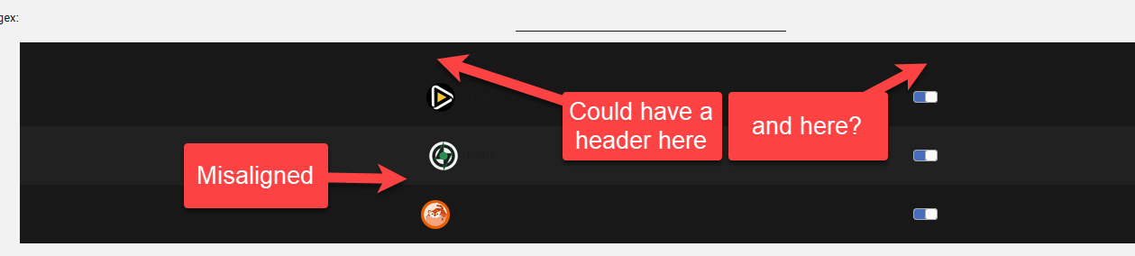

and on the folder page, the container icons are misaligned and some header/titles might be a good idea?2009718335_folderalign.thumb.png.45e80106f7a699bbde44213d3cf66b7f.png

This is my bad, i kind of forgot about unraid themes, and set the table to be dark, there are headers and labels for the containers, the text is black for you, and black on black is not exactly visible.
