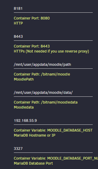

  3. I have run into this so many times, I have uninstalled, reinstalled and still had issues. then i figured it out. 1. go into your (shared) appdata folders and create a separate folder (expose the appdata to SMB if it's easier, I named my folder moodle-DB). 2. Install Mariadb through the community apps, for testing i made it simple, port 3327, all passwords for the database were 'moodle', then for the appdata folder it points to point it to your newly created 'moodle-DB folder' let it run its course. 3.install moodle from the apps, within the configuration point it to the database using the IP address and it's port, now here's where i kept dropping the ball, within the setup of the path data it is not 'finished' per say the container path shows /mnt/user/appdata/moodle/path however the field to fill it out just shows /mnt/user/appdata/moodle/ so i threw in path at the end and it started into installing 4. Check your logs for moodle when it's installing Also if you have residual folders and files left over from prior installs its a good idea to remove them with the cleanup appdata plugin and remove them entirely and start fresh. Hope that helps some.
