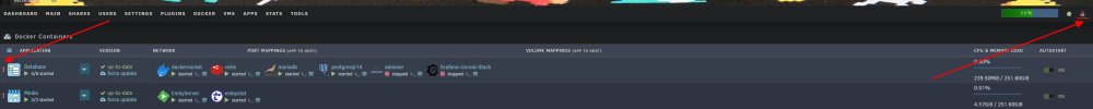

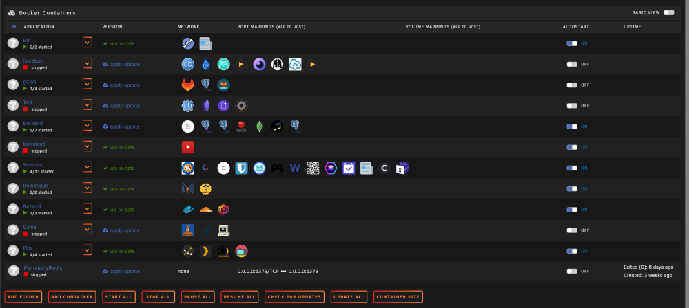

Working fine for months and now it seems that the context menus are disappearing again on 6.11.
Edited by Astryl
Have you uninstalled the original and reinstalled the fork from Apps?

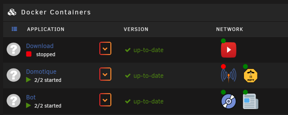

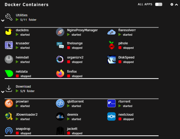

I was able to re-find some of the custom icons i had for folders, so i just reset my folders up. Thanks for the help. Any idea how to get the "white divider" lines back on the main dashboard page? that's only thing i can't seem to find
Before:
After:
Before:
I have removed them in 6.11, see https://github.com/Squidly271/docker.folder/pull/3 for details, they were broken, couldn't get them to work correctly, so you may left with lines that stay stuck on the dashboard....
Code for drawing them is still there, if anyone have time to fix it, let me know. I may return to this in the future if I have time

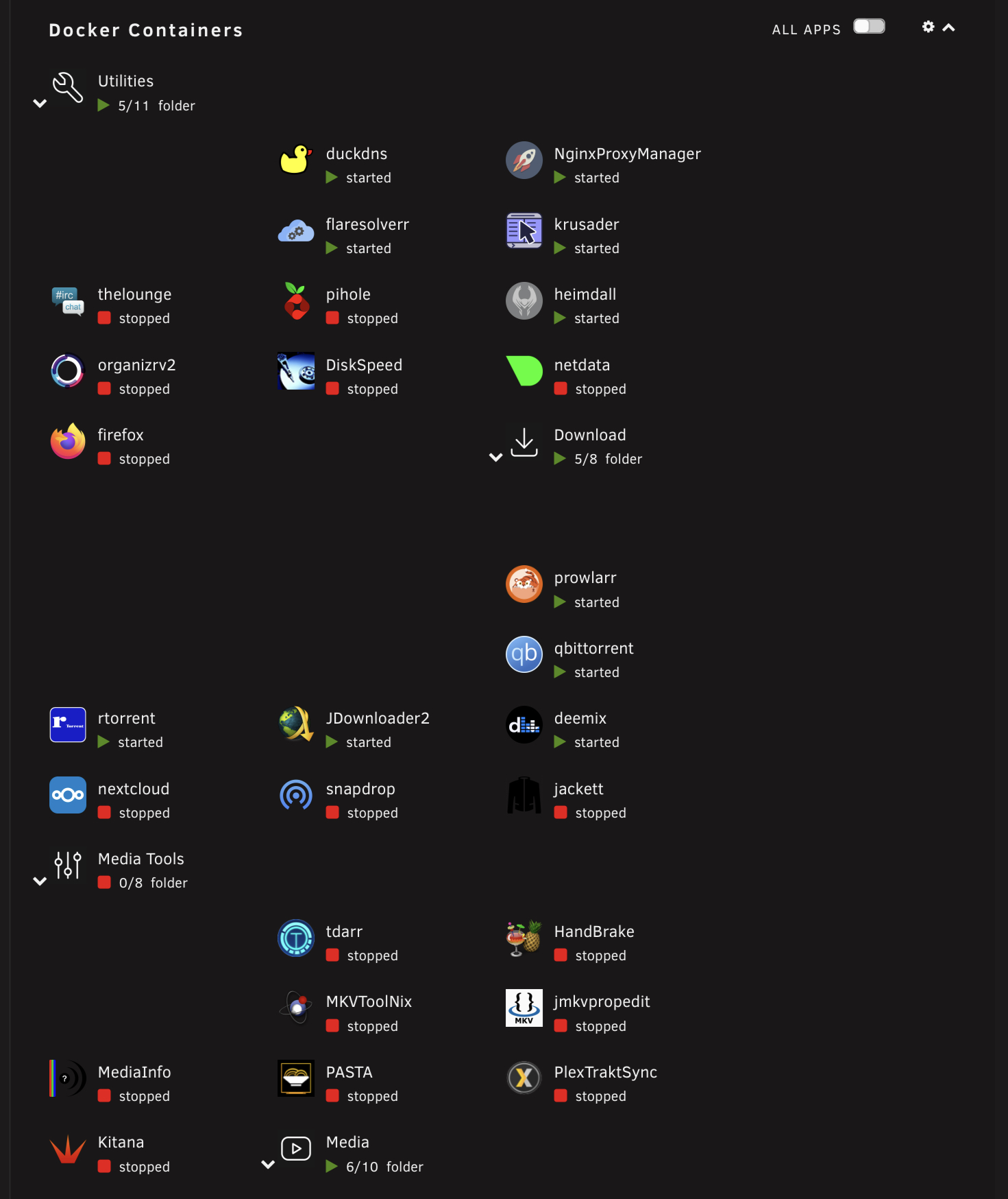

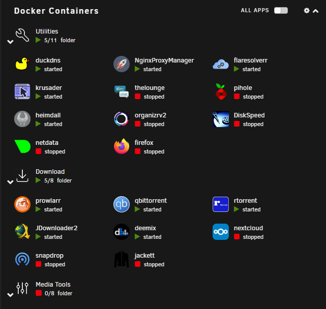

No worries, wasn't sure if i had missed a setting somewhere to re-enable it. Thanks so much for your work getting this to work with latest unraid. Last question - is there a way to fix the rendering issues with the dashboard on iPad/iOS devices? It shows up with a bunch of random spaces (see below screenshot from an iPad Pro 13")

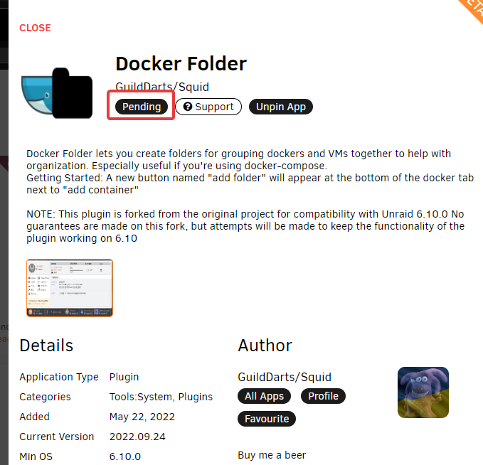

Heya! I'm having an issue with it where the app in Community APps is stuck on 'pending' (and has been for 2 weeks now, despite two restarts).
I had issues with the original container (wouldn't update after upgrading Unraid OS) and deleted the original plugin. After uninstalling I wanted to install it on Community Apps again but it's stuck and I'm sadly lost at how I can resolve this.
Spoiler
rm /tmp/plugins/pluginPending/*
Nice, wasn't aware it was stored in a different base folder. The plugins and plugin errors were all stored elsewhere and I couldn't find it. Thanks a ton! :)
