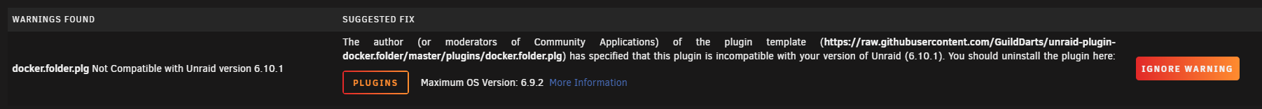

Hey @Squid,
Just one quick question:
As i noticed the following issue was caused by the OLD DockerFolders-Plugin:
May you or somebody else with the NEW DockerFolders-Plugin installed test if you are also getting the same warning message before the array is started with the new version.
If this issue is still present in the new version, may I ask for a fix?

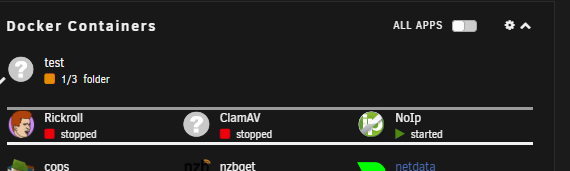

Minor issue - on the dashboard, the "All apps/Started only" toggle seems to be reversed for containers within a folder. It works properly for containers that are not in a folder, and for folders themselves.
On 5/23/2022 at 6:42 PM, Squid said:
Dashboard re-added.  Aberrations minimized  You may still see some minor ones when expanding, but it's more than usable.
I'm aware of that, but it sounded to me like that was referring the visual aberrations (e.g. the misaligned separator). Either way, I hadn't seen anyone else report this so it seems worth mentioning.
I didn't notice you wrote about something else, I can confirm the toggle behaviour.
