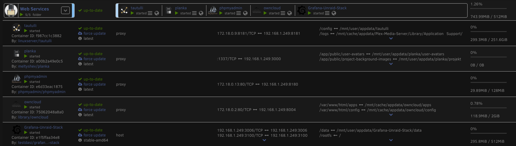

  • OK.   Not that I use this plugin, but I have forked it so that the logs and the context menus appear.   I have temporarily removed the dashboard part of things until I get more tim

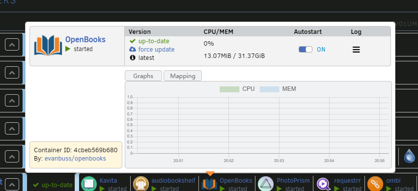

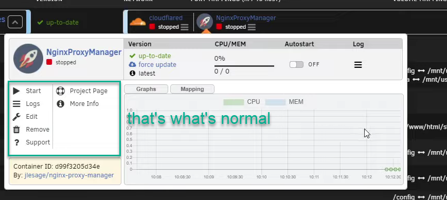

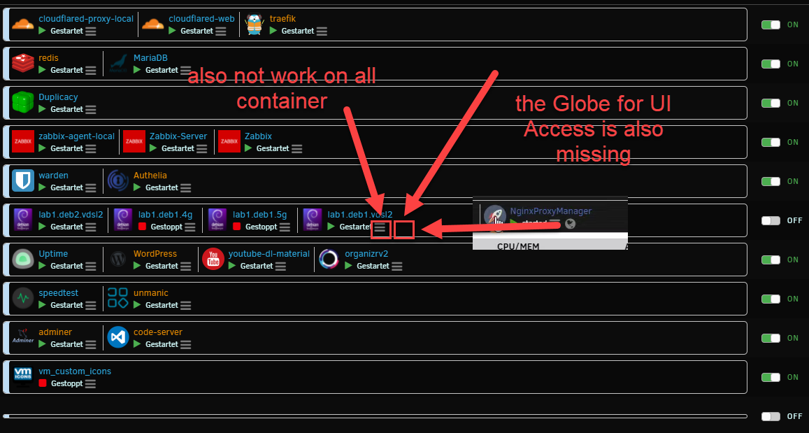

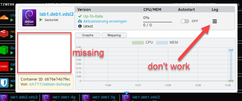

Hello all,
since the update from 6.10.0-rc2 to 6.10.0-rc3 the app "Docker Folder" does not work properly for me anymore. In short, I use the Graph mode "Combined" (image 1) and this creates a popup over each container in which actions like Start Edit etc. can be selected (image 2). Since the update, this is no longer available and generally the function of the buttons such as "Protocoll log" (image 3 & 4) is missing when a container is started.
What I also noticed is that with the app "Array" on the smartphone the entire Docker area is empty. I assume that there is something wrong with the folders path in the update and therefore the access from the apps now go into the void.
Unfortunately, I have not yet been able to deal with the problem in detail. Does anyone know perhaps the problem and a solution or can it generally be the rc3?
BR,  taafedi1

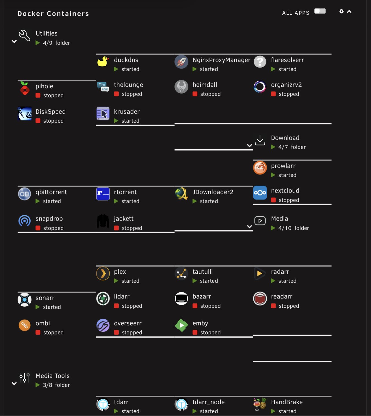

On 8/24/2021 at 1:17 PM, Linguafoeda said:
I’ve noticed that docker folders on the dashboard has a GUI issue where the icons start mis-aligned when you load the dashboard page on any zoomed out / smaller resolution screen (for example, below is my iPad). Happens on iPhone safari mobile as well. Is there something internally to fix this? Would love to make it look consistent with desktop since I typically am accessing unraid from my iPad when away from my desk.
On 8/24/2021 at 6:20 PM, GuildDarts said:
Dang i had fixed that but guess i forgot to include the fix *facepalm
currently not able to push a fix as im not at a pc, will be in a few days
Just tired this on an ipad and see the same thing. Will fix it when i get to a pc :)

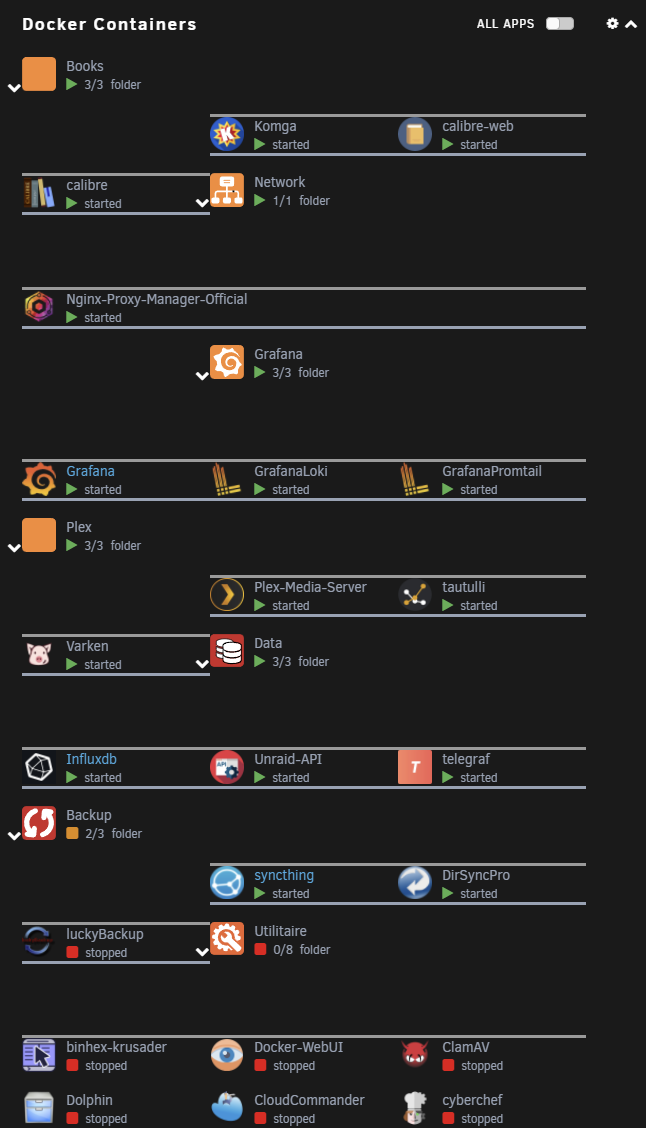

On 11/26/2021 at 10:13 PM, wallas9512 said:
My docker overview is a bit upside down, did I missed something.
I think the code for list docker in docker interface is reutilized in overview.
Do you have any solution for correct this himself?
Thanks.
are you accessing from an ipad or iOS device? this is exact same issue i have with messed up GUI. would love if the developer @GuildDarts is able to find a solution for this :)

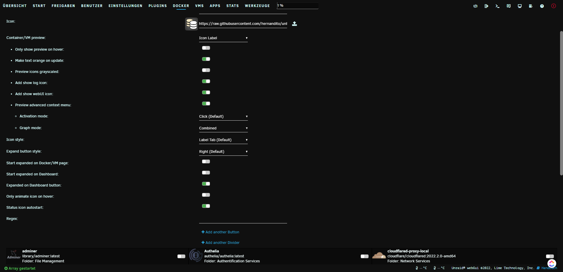

I just wanted to add a follow up for this in case anyone is in my same scenario.
I was confused when you made this comment specifically when you said "the plugin still operates as is with its default settings" because the only thing that was working for me was the separation into folders. None of the context menu items were working for my on any of the icons.
It turns out the actual source of the problem is in the "Preview advanced context menu" option for the docker folders. It turns out this is the feature where the main bug is. After turning this off (I had it on for all folders because it's pretty useful), the typical context menu features started working again.
This brings back the major useful functionality of the plugin and I can again navigate my dockers without pulling my hair out.
Thanks.

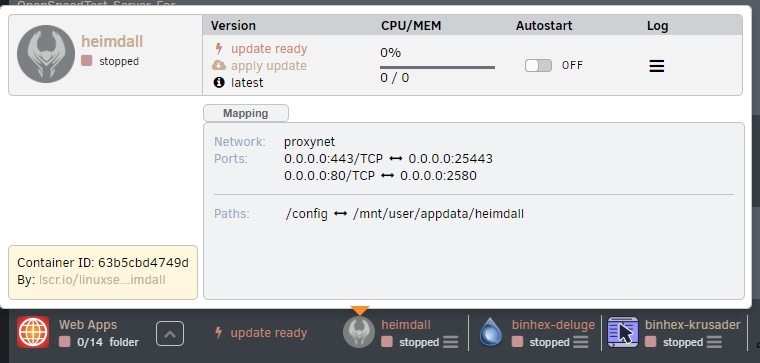

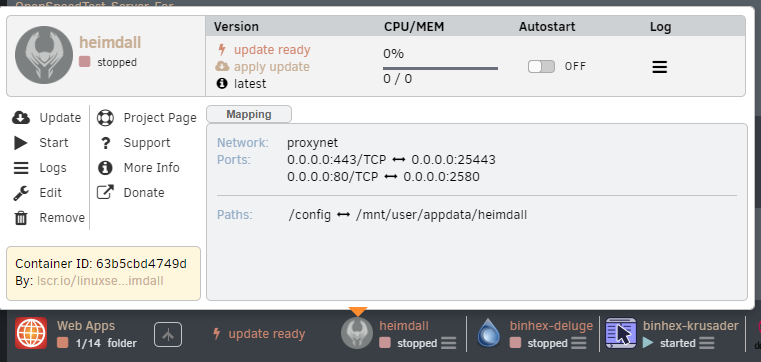

8 hours ago, Squid said:
I think no one actually explained how to reproduce the context menu bug:
1. Create a folder and add containers to it
2. Enable preview advanced context menu:
3. Click on a container a menu will open without the dropdown options:
Workaround which works for me that might hint where is the problem:
4. Expand the folder and start/stop any container on that folder and the dropdown menu is fixed until the page is refreshed:
Hope that helps,
I spent few hours debugging this with no luck (I am more of a backend developer, not frontend), I think the starting point should be https://github.com/GuildDarts/unraid-plugin-docker.folder/issues/11#issuecomment-1072792061
