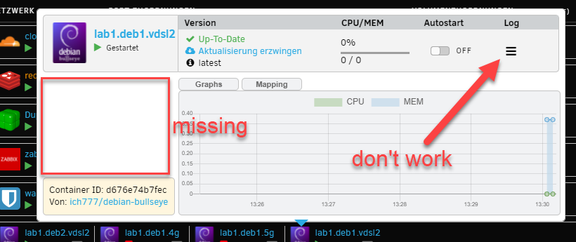

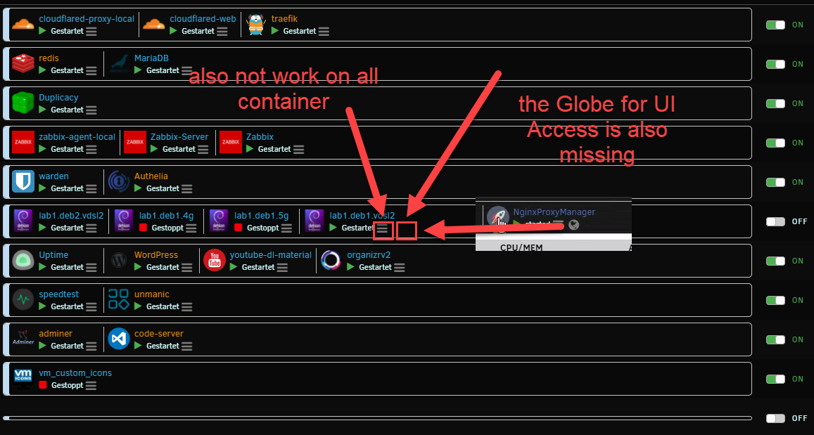

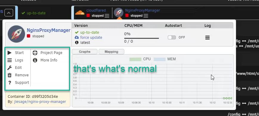

  1. Hello all, since the update from 6.10.0-rc2 to 6.10.0-rc3 the app "Docker Folder" does not work properly for me anymore. In short, I use the Graph mode "Combined" (image 1) and this creates a popup over each container in which actions like Start Edit etc. can be selected (image 2). Since the update, this is no longer available and generally the function of the buttons such as "Protocoll log" (image 3 & 4) is missing when a container is started. What I also noticed is that with the app "Array" on the smartphone the entire Docker area is empty. I assume that there is something wrong with the folders path in the update and therefore the access from the apps now go into the void. Unfortunately, I have not yet been able to deal with the problem in detail. Does anyone know perhaps the problem and a solution or can it generally be the rc3? BR, taafedi1 Imagine 1 imagine 2 (taken by youtube video from ibracorb) imagine 3 imagine 4
  2. Hello all, since the update from 6.10.0-rc2 to 6.10.0-rc3 the app "Docker Folder" does not work properly for me anymore. In short, I use the Graph mode "Combined" (image 1) and this creates a popup over each container in which actions like Start Edit etc. can be selected (image 2). Since the update, this is no longer available and generally the function of the buttons such as "Log log" (image 3 & 4) is missing when a container is started. What I also noticed is that with the app "Array" on the smartphone the entire Docker area is empty. I assume that there is something wrong with the folders in the update and therefore the access from the apps now go into the void. Unfortunately, I have not yet been able to deal with the problem in detail. Does anyone know perhaps the problem and a solution or can it generally be the rc3? BR, taafedi1 Imagine 1 imagine 2 (taken by youtube video from ibracorb) imagine 3 imagine 4
  3. Update: after 20 minutes of waiting after the command "unraid-api start" the problem was fixed and works now.

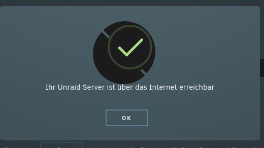

  7. Hi eagle470, you can go to Settings --> Access Configurations "My Servers" --> click the "Check" button. If your configuration is correct you should get a message like in the picture. If not, you may have set the WAN to LAN NAT rule incorrectly. If the check was successful you have the same problem as me. Then try to restart the Unraid API. Open a SSH session or use the terminal in Unraid and execute the command unraid-api restart. Then it should work. BR, taafedi1
