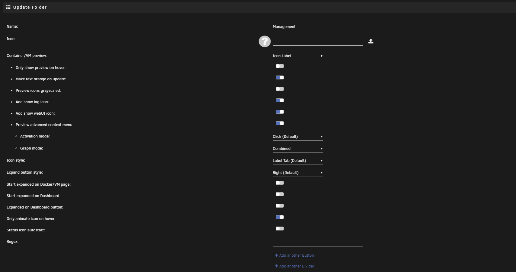

Just installed this today and for whatever reason, the docker icons themselves are changed to the icon I'm using for the folder itself.  I've tried everything in the settings and nothings seems to get the regular icons back other than removing the icon I set for the folder.  Anyone else run into this issue?
Can you provide more information, which unraid OS version, picture of your folder settings?
Currently 6.10.2, Haven't updated to 6.10.3 yet.  Attached photo of settings.
Thank you very much!
this plugin saved my unraid docker panel
I am having the same problem with 6.10.3.  Turning off "Only animate icon on hover:" fixed the icon problem for me.

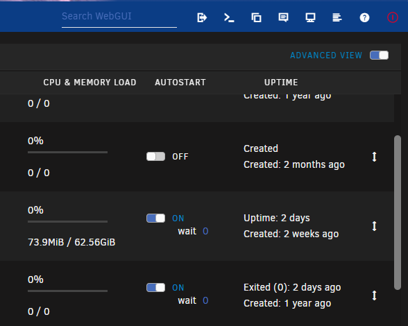

Is there an option to stagger the startup of the dockers inside a folder? Maybe the ability to add a delay between dockers so a folder with many dockers inside does not overwhelm your system? I've looked around, but nothing jumped out at me :).
I am not sure how this may be impacted by the Docker Folder plugin as I do not use it, but, in the Docker tab Advanced view, you can set a delay AFTER a docker container starts.  The wait value will delay the next docker container start by that amount. I believe it is in seconds.
Edited by Hoopster
Hmmm... Good suggestion! Sadly, I just tried, but it seems to only apply on first boot. If I stop my docker, set the delay and started the docker, it just starts as normal...
Expected behavior because a delay set on a docker container does not apply to starting that container.  It is a delay that will be applied after the container starts to delay the start of the next container.  So, yes, it is more useful on boot when multiple containers are loading.  Probably on a stop and start of the Docker service as well.
Edited by Hoopster

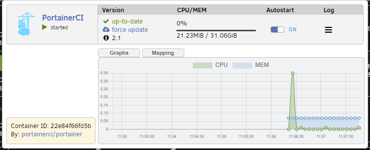

I just started using this and im on 6.11.
Log and actions doesnt work, any help?
I have tried to copy your exact settings and could not reproduce it, if I will know how to reproduce it I can try to fix it (still have limited knowledge in frontend and not the one who developed it)
Can you attach your `folders.json` file? you can find it under the flash drive share:
flash\config\plugins\docker.folder\folders.vm
